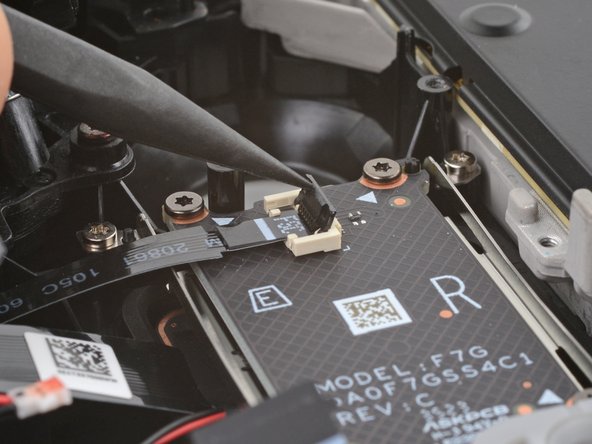

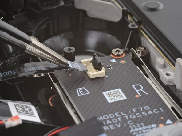

  21. Steam Deck OLED Right Touchpad Replacement, Remove the right touchpad board cable: 21 단계, 이미지 3개 중 1개 Steam Deck OLED Right Touchpad Replacement, Remove the right touchpad board cable: 21 단계, 이미지 3개 중 2개 Steam Deck OLED Right Touchpad Replacement, Remove the right touchpad board cable: 21 단계, 이미지 3개 중 3개
    • Flip up the small locking flap on the right touchpad board ZIF connector.
    • Lift the connector until its arms are free of the socket and slide it straight out to disconnect it.

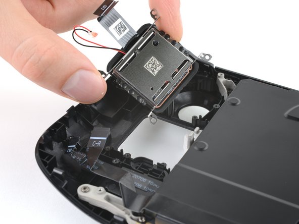

  24. Steam Deck OLED Right Touchpad Replacement, Remove the touchpad screws: 24 단계, 이미지 1개 중 1개
    • Use your T6 Torx driver to remove the four 6 mm‑long screws securing the touchpad.
  25. Steam Deck OLED Right Touchpad Replacement, Remove the touchpad: 25 단계, 이미지 3개 중 1개 Steam Deck OLED Right Touchpad Replacement, Remove the touchpad: 25 단계, 이미지 3개 중 2개 Steam Deck OLED Right Touchpad Replacement, Remove the touchpad: 25 단계, 이미지 3개 중 3개
    • Remove the touchpad.
    • If you're having trouble removing the touchpad, lift the edge of the Steam Deck OLED and push the touchpad through from the front.
