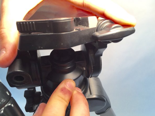

    • Grab the quick-release plate with one hand and the tripod body with the other. Then, pull the quick-release plate straight off of the tripod body.
    • The quick-release plate may need to be twisted off of the tripod body if it does not slide off.

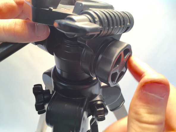

    • Grab the side-tilt-locking-nut with your dominant hand and grab the pan handle with your other hand. Twist the side-tilt-locking-nut counterclockwise to loosen it, and then pull it off.
