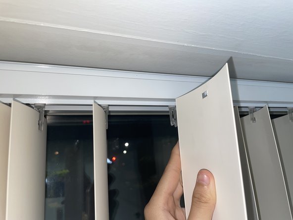

Vertical Blind Slat Replacement
  1. Vertical Blind Slat Replacement, Slat: 1 단계, 이미지 2개 중 1개 Vertical Blind Slat Replacement, Slat: 1 단계, 이미지 2개 중 2개
    • Remove the old slat by lifting it upwards.
  2. Vertical Blind Slat Replacement: 2 단계, 이미지 2개 중 1개 Vertical Blind Slat Replacement: 2 단계, 이미지 2개 중 2개
    • Once lifted, gently pull the slat toward you to remove it completely from the clip.
  3. Vertical Blind Slat Replacement: 3 단계, 이미지 1개 중 1개
    • Adjust and ensure the curve of the new slat is facing the same direction as the other old slats.
  4. Vertical Blind Slat Replacement: 4 단계, 이미지 1개 중 1개
    • Slide the new slat upwards into the first clip.
  5. Vertical Blind Slat Replacement: 5 단계, 이미지 1개 중 1개
    • Continue sliding the slat upwards until it clicks into place in the second clip.
  6. Vertical Blind Slat Replacement: 6 단계, 이미지 1개 중 1개
    • Once finished, gently pull the slat toward you to ensure it is securely attached.
