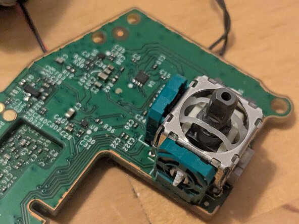

  16. Xbox One Wireless Controller Potentiometer Replacement, Open the potentiometer housing: 16 단계, 이미지 3개 중 1개 Xbox One Wireless Controller Potentiometer Replacement, Open the potentiometer housing: 16 단계, 이미지 3개 중 2개 Xbox One Wireless Controller Potentiometer Replacement, Open the potentiometer housing: 16 단계, 이미지 3개 중 3개
    • Use the iFixit Precision Tweesers to gently pry open the potentiometer housing by slowly levering the top edge of the plastic.
    • Bend the housing so that there is 2–3 millimeters of space at the top.
    • If you bend it too much, you risk damaging the module's solder joints.

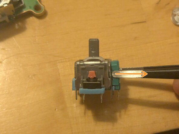

  17. Xbox One Wireless Controller Potentiometer Replacement, Remove the damaged potentiometer: 17 단계, 이미지 2개 중 1개 Xbox One Wireless Controller Potentiometer Replacement, Remove the damaged potentiometer: 17 단계, 이미지 2개 중 2개
    • Pull the potentiometer out of its housing.
  18. Xbox One Wireless Controller Potentiometer Replacement, Take the new potentiometer: 18 단계, 이미지 3개 중 1개 Xbox One Wireless Controller Potentiometer Replacement, Take the new potentiometer: 18 단계, 이미지 3개 중 2개 Xbox One Wireless Controller Potentiometer Replacement, Take the new potentiometer: 18 단계, 이미지 3개 중 3개
    • From the replacement module, slowly separate the potentiometer housing from the module.
    • Gently press the small plastic tabs that secure the potentiometer to the center of the housing.
    • Remove the potentiometer.
