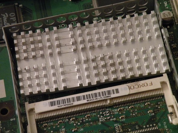

  10. iMac G3 Model M4984 RAM Replacement: 10 단계, 이미지 3개 중 1개 iMac G3 Model M4984 RAM Replacement: 10 단계, 이미지 3개 중 2개 iMac G3 Model M4984 RAM Replacement: 10 단계, 이미지 3개 중 3개
    • Remove the CPU shield, this will reveal the "top slot". This is the user-serviceable RAM slot, though there is a a second slot of RAM under the CPU card.
    • The iMac uses PC100 Laptop Ram, and according to Apple, it supports up to 256MB RAM (2X128MB) but unofficially. Some later models can support 512MB (2X256MB).
    • Push the tabs out, and the RAM should pop up, then pull the ram out.

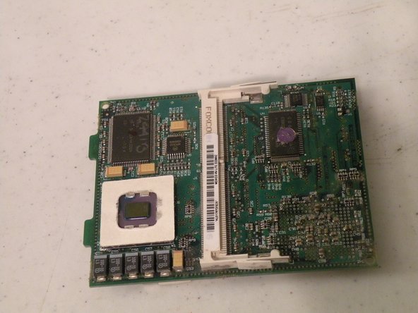

  12. iMac G3 Model M4984 RAM Replacement: 12 단계, 이미지 3개 중 1개 iMac G3 Model M4984 RAM Replacement: 12 단계, 이미지 3개 중 2개 iMac G3 Model M4984 RAM Replacement: 12 단계, 이미지 3개 중 3개
    • Removing the CPU Card:
    • Lift the card out by this end!

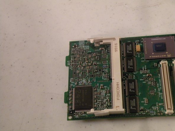

  13. iMac G3 Model M4984 RAM Replacement: 13 단계, 이미지 3개 중 1개 iMac G3 Model M4984 RAM Replacement: 13 단계, 이미지 3개 중 2개 iMac G3 Model M4984 RAM Replacement: 13 단계, 이미지 3개 중 3개
    • Now, flip the card over.
    • This will reveal another stick of laptop PC66.
    • This is most likely a 32MB Stick, because the iMac shipped standard with only 32MB of RAM.
    • Now, remove it by pushing the tabs, it should pop up, and you can set it aside.
