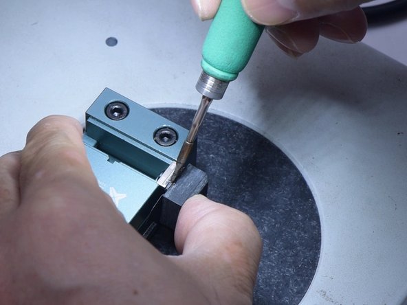

    • Heat to separate the camera with a Soldering Iron.
    • Remove adhesive around the optical filter with a Hot Air Gun.
    • Then take the optical filter out.

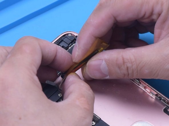

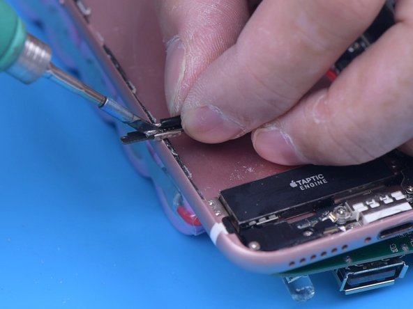

    • After punching a hole, we connect the external battery to the power board.
    • Pass the power cord through the hole and solder it to the BMS board of the phone.
    • Insulate the cord with high-temperature tape.

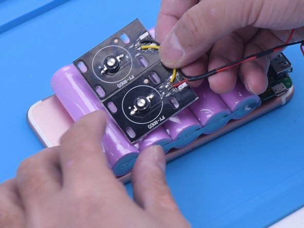

    • Fix the battery and power board with adhesive.
    • The external battery has been successfully installed. Then we attach the infrared lamp to the battery.
    • Install a switch for the lamp. Connect the lamp to the power board

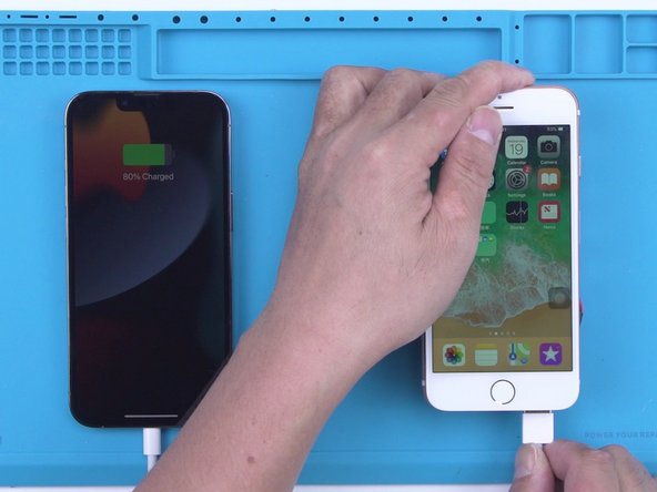

    • The last thing is to test the remodeled iPhone. The phone turns on and the battery health is 100%.
    • The charging function also works well. It can also be used as a power bank to charge other phones.
  9. iPhone DIY Night Vision Camera and Massive External Battery Pack: 9 단계, 이미지 2개 중 1개 iPhone DIY Night Vision Camera and Massive External Battery Pack: 9 단계, 이미지 2개 중 2개
    • The charging function also works well. It can also be used as a power bank to charge other phones. Under a dark environment, the phone can act as a night vision camera.
