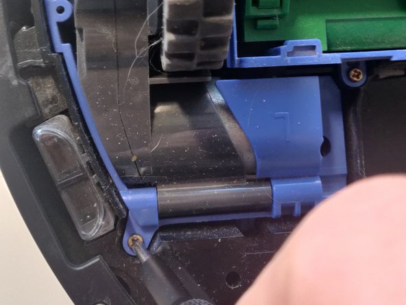

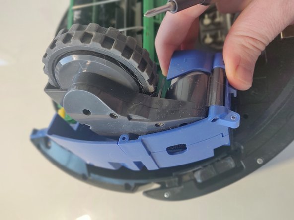

    • Using the Phillips #1 driver, remove the three screws that hold back the wheel unit on each side. This is not required but will make the repair easier.
    • Lift out the wheel units and store safely.
    • Repeat on the other side.

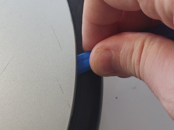

    • Using the ifixit spudgers pry under the main silver panel.

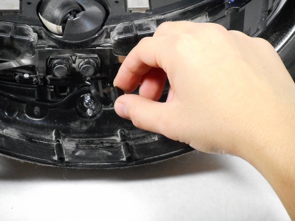

    • Lift the thin top cover that holds the bumper in place.
    • Be very vigilant with the attached sensor. Otherwise you risk ripping off the cable and damaging the entire sensor.

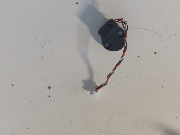

  15. iRobot Roomba 560 Motherboard Replacement, Unscrew sensor: 15 단계, 이미지 2개 중 1개 iRobot Roomba 560 Motherboard Replacement, Unscrew sensor: 15 단계, 이미지 2개 중 2개
    • Lift the bumper upwards for easier access.
    • Unscrew the two 5 mm screws that connect the red and white wires to the device using the Phillips #1 driver.
    • Lift the circular black panel off the sensor housing.

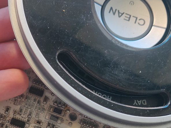

    • Remove the outer silver circle, black plastic cover, and black film from the central control board in that order.

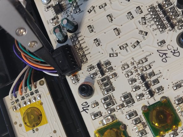

    • Remove all the top connectors to the mainboard.
    • You can use ifixit's reverse pliers but you can also use your hands.

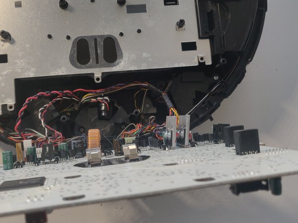

    • Carefully lift off the mainboard, moving it towards you.
    • Be very careful with the connected connectors.

  27. iRobot Roomba 560 Motherboard Replacement, Remove sensor and replace board: 27 단계, 이미지 2개 중 1개 iRobot Roomba 560 Motherboard Replacement, Remove sensor and replace board: 27 단계, 이미지 2개 중 2개
    • The sensor might still be attached/is not attached to the main unit but mainboard. Just unplug it.
    • You can now replace the mainboard and complete the steps from the bottom up to finish the replacement.
