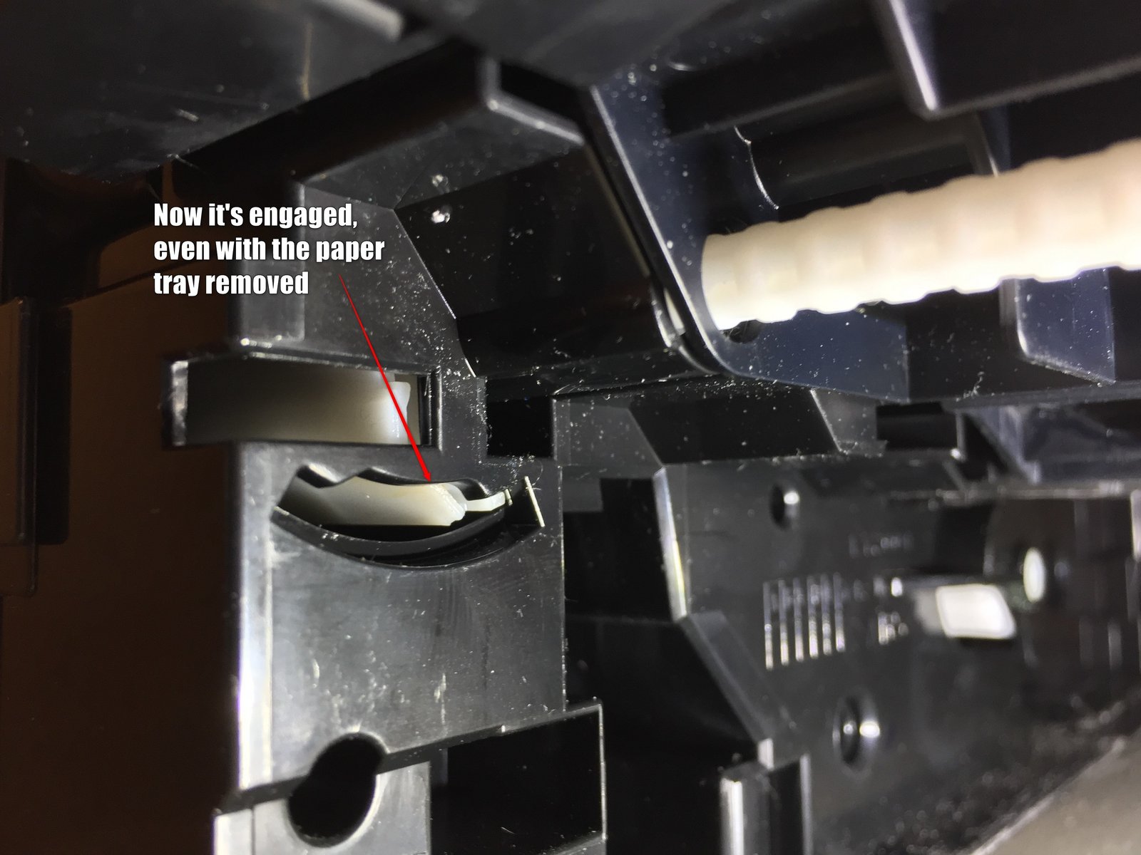

I had what sounds like the same exact issue as you, so hopefully the solution is the same. No amount of cleaning the rollers or tinkering would fix the problem. In fact, it seemed like the feeder rollers weren't spinning at all.
I dug up the service manual online and proceeded to take everything apart until I could get to the gearing and have a look for anything out of place.
Solution:
There is a small plastic lever that is used to lift/lower a gear in order to start and stop the feeder rollers. This lever can come out of position such that it can no longer wedge beneath the gear, and instead pushes against the side of the gear. Thus, the feeder rollers will no longer work.
Fortunately, the problem exists in a place that requires no disassembly.
1. Remove the paper tray.
2. Facing the printer from the front: Immediately to the left of the paper tray slot, there is a small hole (Circled in RED) with a white piece of plastic visible through it (Squared in BLUE). This white piece of plastic is the lever we need to put back into position. If it looks like in my photo, it's where it should be. If you see less of the white plastic, it is out of position.
Before step 3: Notice the curved slot (Underlined in YELLOW) directly beneath the hole where the white plastic lever lives. There is a very small clip/hook on the lever which is supposed to rest in this slot, keeping the lever from dislodging and causing the very issue we are having. If you look into the slot, you should be able to see the clip. When I did this fix, this clip broke because I was impatient. You will need to gently flex the clip up (toward the top of the printer) while following step 3, so that it seats correctly in the curved slot.
3. With some small pliers/needle nose, grab the white plastic piece as seen in the image and gently but firmly pull it toward the right side of the printer (BLUE arrow). It should slide into the correct position, and the small clip should latch into the slot, hopefully stopping this from ever happening again. If you fail to flex the clip up, it will press against the inside of the printer's casing and snap off.
-- If the clip breaks like mine, it's not the end of the world. You'll just be more likely to need to do this simple process again in the future.
4. Slide the paper tray back in and give it a whirl. Hopefully it works for you.

Thanks, Jeremy! That is definitely the problem. Both the white plastic piece and the small metal spring clip are rattling around loose and nearly impossible to put back in place. I'll give it another try and see if I can align them both. Appreciate your very thorough instructions.
의
If you care to take the plunge and have a little patience, the service manual can be picked up from a quick google search for "HL-2280DW service manual" -- 4th result for me. Fixing the problem from inside might work out better for you.
You'll want to go to page 3-27. Following the disassembly instructions from page 3-27, you'll stop after the "Side cover L" step (page 3-40). Once there, you'll have access to all the gears, and that pesky little lever-wedge. This way, you can push it into place rather than pulling on it.

Glad I could help out!
I suppose you could glue it, but you'd need to glue it into a position where it's engaged. How it works is, when the paper tray is fully inserted, the white tab is pushed toward the rear of the printer (kind of like a button) which causes the gearing for the feeder rollers to engage. This action is fully mechanical--there are no electronics involved.
If you were to glue it in a position where the gear is NOT engaged, it would just not work, or worse, potentially break entirely.
Since it only works its way out of position over time due to removing/reinserting the paper tray, I've just made a habit if pulling the tab back out whenever I refill the paper. That seems to be working out just fine.

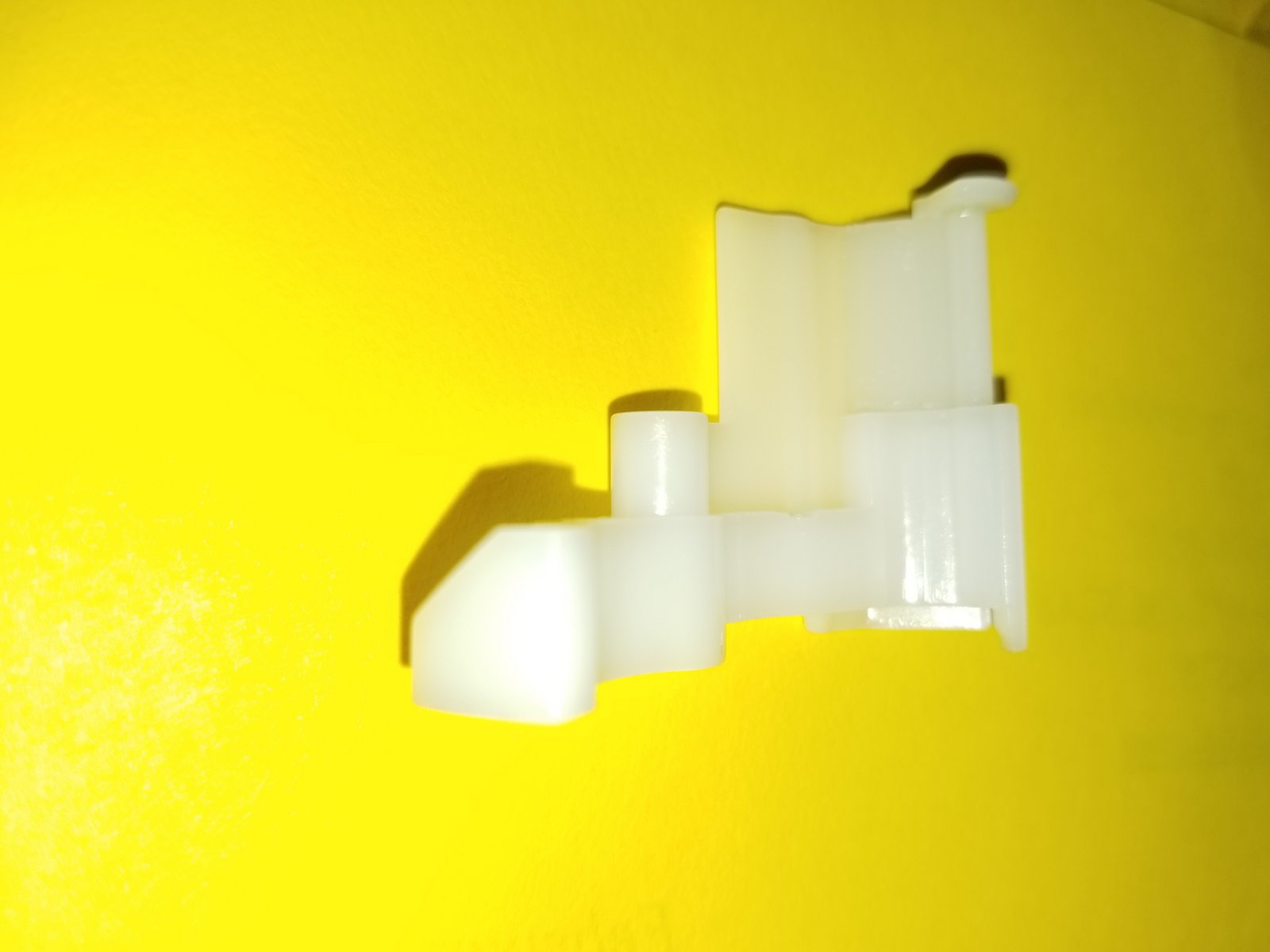

Hello Jeremy & Co.
I've been waiting for a day to patiently take the printer side off and tackle this problem - today! I've followed the excellent trail of breadcrumbs offered by @jermn and @erichmusick, but seem to be missing a few things...
1. There is no metal coil/spring.
2. My white plastic part appears to be broken - among other things the square bit of plastic to appear in the small front window is round, and I don't see any tab on it sturdy enough to engage levers. Does anyone know what this piece is called?
Lastly, I see a small circular mount (the 0 of it faces the side, so it's horizontal from front) - does the white piece pivot on that or is it irrelevant? Incredible the lengths we'll go to avoid dumping an old printer in landfill!
Many thanks, Mel

@melanieh Did you ever fix this issue? My plastic piece looks like this also and I can't figure out how to reinstall it. Thanks.
의
Your printer is like mine: the Brother HL-1212W. The solution detailed in this page doesn't apply to our specific moel. I had the same issue and was unable to follow insctruccions because my printer is the Brother HL-1212W
