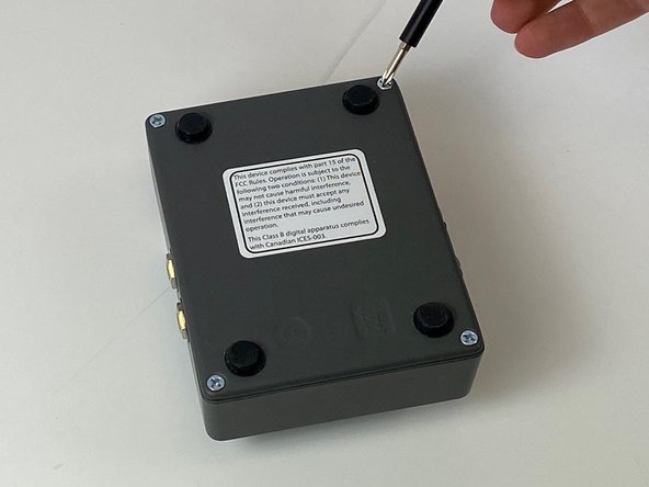

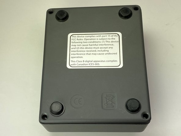

    • Use a Phillips #1 screwdriver to remove all four screws from the back of the device.
    • Remove the back plate from the pedal.
