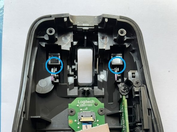

  4. Fixing the Phantom Double Clicking on Logitech MX Anywhere 3, Fix the click: 4 단계, 이미지 3개 중 1개 Fixing the Phantom Double Clicking on Logitech MX Anywhere 3, Fix the click: 4 단계, 이미지 3개 중 2개 Fixing the Phantom Double Clicking on Logitech MX Anywhere 3, Fix the click: 4 단계, 이미지 3개 중 3개
    • Those are tools you need for this last step.
    • Use the dust blower to blow the dust away.
    • Then, apply some lubricant to the locations marked in blue circles. Make sure you spray the lubricant into the clicking pieces in both the lower and upper parts of the mouse.
    • Make a few clicks and scroll the wheel to ensure that everything works smoothly.
    • Use the tissue to wipe away excessive lubricant before reassembling the mouse.
