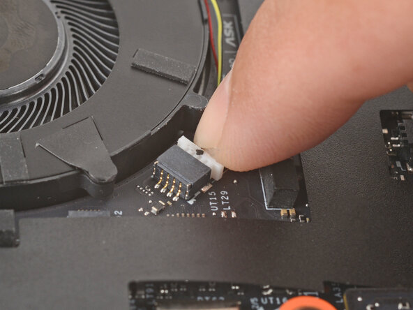

  7. Framework Laptop 12 Fan Replacement, Disconnect the fan connector: 7 단계, 이미지 3개 중 1개 Framework Laptop 12 Fan Replacement, Disconnect the fan connector: 7 단계, 이미지 3개 중 2개 Framework Laptop 12 Fan Replacement, Disconnect the fan connector: 7 단계, 이미지 3개 중 3개
    • Use the flat end of your Framework Screwdriver to gently push on one of the fan connector's protruding edges, then the other, to loosen the connector out of its socket.

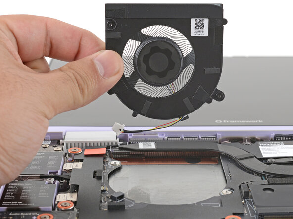

  10. Framework Laptop 12 Fan Replacement, Remove the fan: 10 단계, 이미지 2개 중 1개 Framework Laptop 12 Fan Replacement, Remove the fan: 10 단계, 이미지 2개 중 2개
    • Lift and remove the fan.

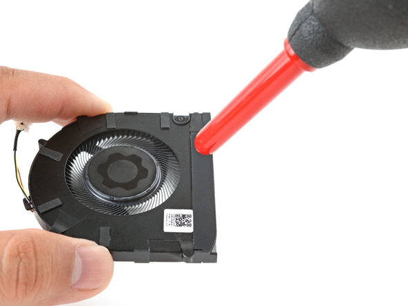

  11. Framework Laptop 12 Fan Replacement, Clean the fan: 11 단계, 이미지 2개 중 1개 Framework Laptop 12 Fan Replacement, Clean the fan: 11 단계, 이미지 2개 중 2개
    • If your fan's dirty, this is a great opportunity to clean it! A clean fan will help your laptop stay cooler.
    • Use a soft bristled brush or a clean toothbrush to gently scrub the fan blades and exhaust fins.
    • Use a dust blower to blow away the dust from the fan.
