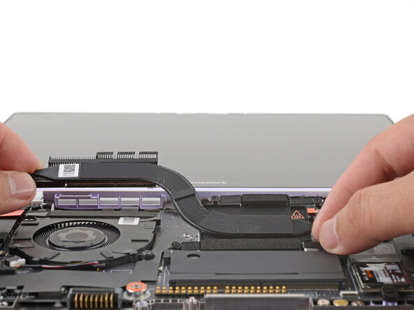

  9. Framework Laptop 12 Heatsink Replacement, Remove the heatsink: 9 단계, 이미지 2개 중 1개 Framework Laptop 12 Heatsink Replacement, Remove the heatsink: 9 단계, 이미지 2개 중 2개
    • Lift and remove the heatsink.

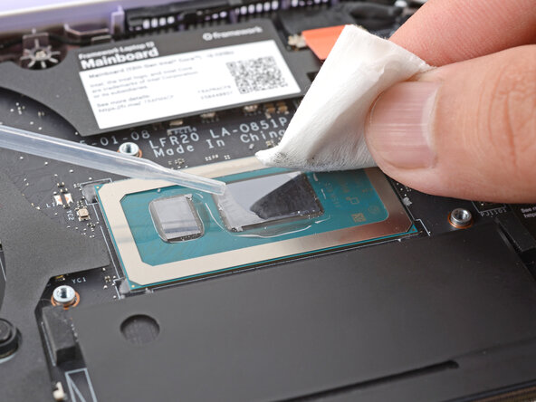

  11. Framework Laptop 12 Heatsink Replacement, Remove the old thermal compound: 11 단계, 이미지 1개 중 1개
    • Use a few drops of high concentration (>90%) isopropyl alcohol and a lint-free cloth to wipe away the remaining residue from the processor.

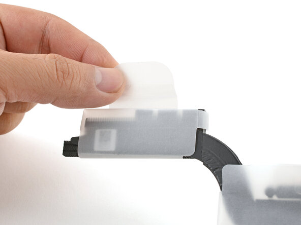

  12. Framework Laptop 12 Heatsink Replacement, Unwrap the heatsink: 12 단계, 이미지 2개 중 1개 Framework Laptop 12 Heatsink Replacement, Unwrap the heatsink: 12 단계, 이미지 2개 중 2개
    • Unwrap the replacement heatsink and remove the clear plastic cover.
    • Be careful not to touch the gray thermal compound on the heatsink.

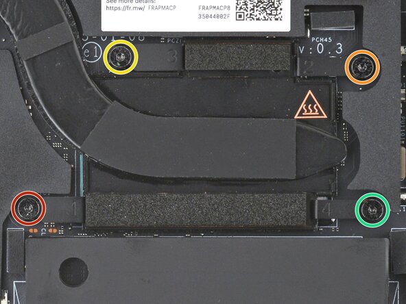

  13. Framework Laptop 12 Heatsink Replacement, Install the heatsink: 13 단계, 이미지 2개 중 1개 Framework Laptop 12 Heatsink Replacement, Install the heatsink: 13 단계, 이미지 2개 중 2개
    • Carefully align and lay the heatsink over the processor.
    • Use your Framework Screwdriver to gradually tighten the heatsink screws in the marked order until they're snug:
    • First screw
    • Second screw
    • Third screw
    • Fourth screw, then back to the first
    • This helps compress the thermal compound evenly under the heatsink and apply even pressure over the processor.
