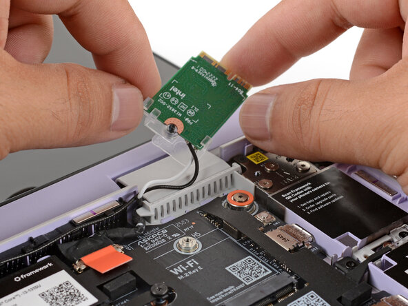

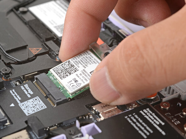

  23. Framework Laptop 12 Mainboard Replacement, Reposition the Wi-Fi card: 23 단계, 이미지 2개 중 1개 Framework Laptop 12 Mainboard Replacement, Reposition the Wi-Fi card: 23 단계, 이미지 2개 중 2개
    • Be careful not to strain the two delicate antenna cables attached to the Wi-Fi card.
    • Grab the Wi-Fi card by its edges and slide it out of its socket.

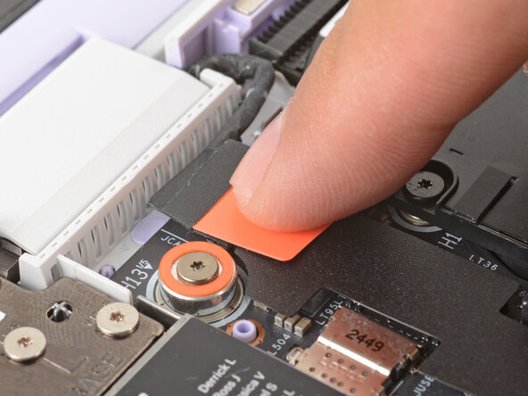

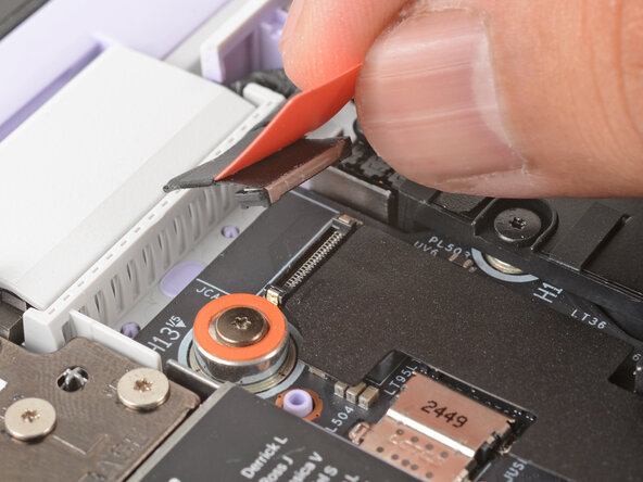

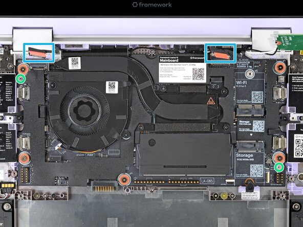

  25. Framework Laptop 12 Mainboard Replacement, Disconnect the webcam cable: 25 단계, 이미지 2개 중 1개 Framework Laptop 12 Mainboard Replacement, Disconnect the webcam cable: 25 단계, 이미지 2개 중 2개
    • Use your fingers to grab the orange tab on the webcam cable, located near the left hinge.
    • Lift straight up to disconnect the cable.

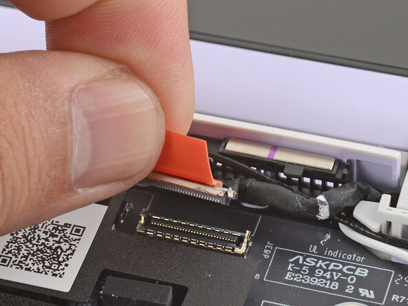

  26. Framework Laptop 12 Mainboard Replacement, Disconnect the display cable: 26 단계, 이미지 2개 중 1개 Framework Laptop 12 Mainboard Replacement, Disconnect the display cable: 26 단계, 이미지 2개 중 2개
    • Use your fingers to grab the orange tab on the display cable, located near the right hinge.

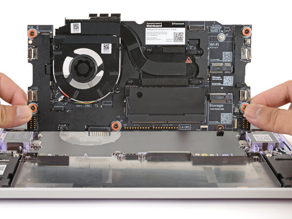

  28. Framework Laptop 12 Mainboard Replacement, Remove the Mainboard: 28 단계, 이미지 2개 중 1개 Framework Laptop 12 Mainboard Replacement, Remove the Mainboard: 28 단계, 이미지 2개 중 2개
    • Make sure you've removed all Expansion Cards. Installed cards will hold the Mainboard in place.
    • Use your fingers to grab the Mainboard by its edges.
    • Lift and remove the Mainboard.

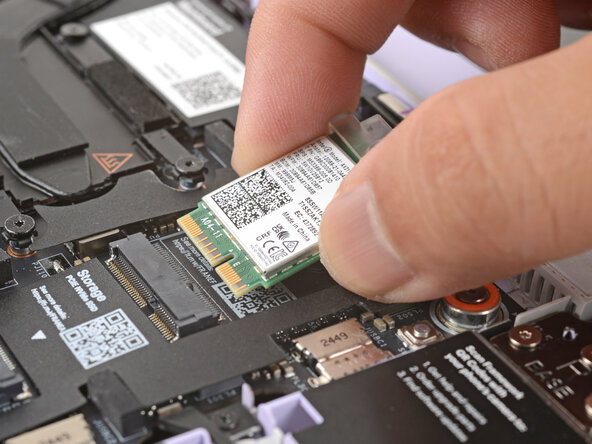

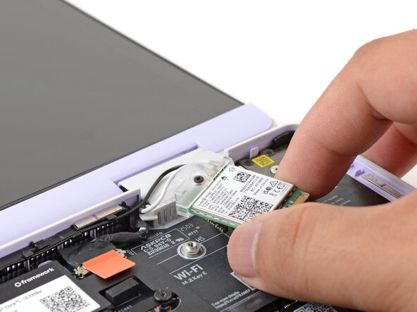

  34. Framework Laptop 12 Mainboard Replacement, Install the Wi-Fi card: 34 단계, 이미지 2개 중 1개 Framework Laptop 12 Mainboard Replacement, Install the Wi-Fi card: 34 단계, 이미지 2개 중 2개
    • Use your fingers to carefully move the Wi-Fi card over the Mainboard.
  35. Framework Laptop 12 Mainboard Replacement: 35 단계, 이미지 2개 중 1개 Framework Laptop 12 Mainboard Replacement: 35 단계, 이미지 2개 중 2개
    • Hold the Wi-Fi card by its edges. Don't touch the gold contacts with your fingers. If you do, wipe the contacts with a clean, lint-free cloth to remove any finger oils.
    • Align the Wi-Fi card's gold contacts and notch with the socket on the Mainboard.
    • Insert the Wi-Fi card into the socket at a shallow angle. The gold contacts should mostly be covered by the socket.
    • If the clear Wi-Fi card bracket or antenna cables got disconnected during the repair, go to the next step. If they're still attached, skip down three steps.

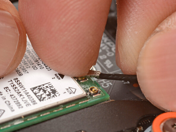

  36. Framework Laptop 12 Mainboard Replacement, Reconnect a disconnected antenna cable: 36 단계, 이미지 3개 중 1개 Framework Laptop 12 Mainboard Replacement, Reconnect a disconnected antenna cable: 36 단계, 이미지 3개 중 2개 Framework Laptop 12 Mainboard Replacement, Reconnect a disconnected antenna cable: 36 단계, 이미지 3개 중 3개
    • Follow the next two steps if an antenna cable disconnected from the Wi-Fi card.
    • Hold the Wi-Fi card down with your finger.
    • Position the black antenna cable connector over the left Wi-Fi card's coaxial socket.
    • Tweezers can help position the connector.
    • Use your finger to press the connector into place. You should feel a faint click, and the cable will stay attached to the socket by itself.
    • These connectors are very delicate! If the connector doesn't feel like it's clicking in place, reposition the connector and try again.
    • Repeat the procedure with the white antenna cable.

    • Align the SSD's gold contacts with its socket.
    • Insert the SSD into the socket at a shallow angle. The gold contacts should mostly be covered by the socket.
    • The SSD fits into the socket in one orientation. If it doesn't feel like it fits, try flipping the module.
