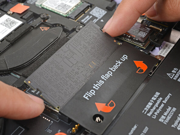

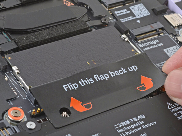

  7. Framework Laptop 12 Memory Module Replacement, Open the memory flap: 7 단계, 이미지 2개 중 1개 Framework Laptop 12 Memory Module Replacement, Open the memory flap: 7 단계, 이미지 2개 중 2개
    • Use your fingers to flip open the memory flap.

  11. Framework Laptop 12 Memory Module Replacement, Install the memory module: 11 단계, 이미지 3개 중 1개 Framework Laptop 12 Memory Module Replacement, Install the memory module: 11 단계, 이미지 3개 중 2개 Framework Laptop 12 Memory Module Replacement, Install the memory module: 11 단계, 이미지 3개 중 3개
    • Hold the memory module by its edges. Don't touch the gold contacts with your fingers. If you do, wipe the contacts with a clean, lint-free cloth to remove any finger oils.
    • Orient the module with the label facing down and align the gold contacts with the socket.
    • Insert the contact edge into the socket at a shallow angle. The gold contacts should mostly be covered by the socket.
    • Press the edges of the memory module down until the side clips lock it in place.
    댓글 쓰기
  12. Framework Laptop 12 Memory Module Replacement: 12 단계, 이미지 2개 중 1개 Framework Laptop 12 Memory Module Replacement: 12 단계, 이미지 2개 중 2개
    • Flip the memory flap back over the memory module.
    댓글 쓰기
