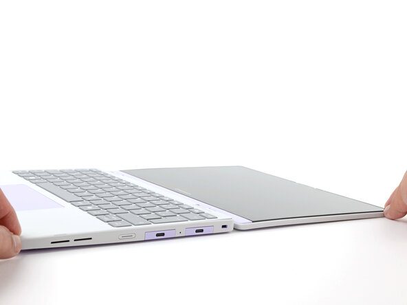

  5. Framework Laptop 12 Touchpad Replacement, Open your laptop: 5 단계, 이미지 2개 중 1개 Framework Laptop 12 Touchpad Replacement, Open your laptop: 5 단계, 이미지 2개 중 2개
    • Open the laptop lid so that both the screen and the base lie flat on your work surface.

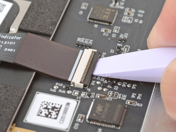

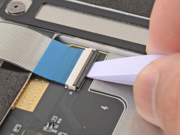

  7. Framework Laptop 12 Touchpad Replacement, Disconnect the touchpad: 7 단계, 이미지 3개 중 1개 Framework Laptop 12 Touchpad Replacement, Disconnect the touchpad: 7 단계, 이미지 3개 중 2개 Framework Laptop 12 Touchpad Replacement, Disconnect the touchpad: 7 단계, 이미지 3개 중 3개
    • Use the flat end of your Framework Screwdriver or a fingernail to gently pry up the black locking tab on the touchpad cable ZIF connector, located on the back of the touchpad.
  8. Framework Laptop 12 Touchpad Replacement: 8 단계, 이미지 2개 중 1개 Framework Laptop 12 Touchpad Replacement: 8 단계, 이미지 2개 중 2개
    • Grab the touchpad cable by the brown tab and slide it out of its connector.

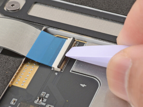

  9. Framework Laptop 12 Touchpad Replacement: 9 단계, 이미지 3개 중 1개 Framework Laptop 12 Touchpad Replacement: 9 단계, 이미지 3개 중 2개 Framework Laptop 12 Touchpad Replacement: 9 단계, 이미지 3개 중 3개

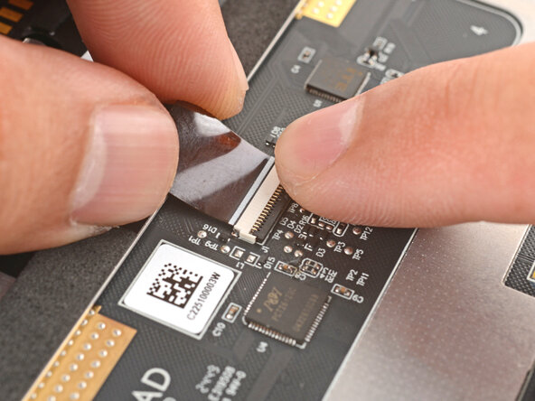

    • Use the flat end of your Framework Screwdriver or a fingernail to gently pry up the black locking tab on the keyboard cable ZIF connector, located on the back of the touchpad.
  10. Framework Laptop 12 Touchpad Replacement: 10 단계, 이미지 2개 중 1개 Framework Laptop 12 Touchpad Replacement: 10 단계, 이미지 2개 중 2개
    • Grab the keyboard cable by the blue tab and slide it out of its connector.

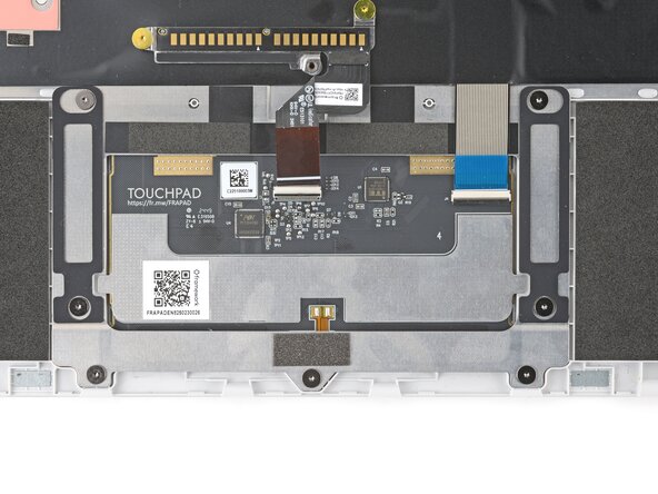

  11. Framework Laptop 12 Touchpad Replacement, Remove the touchpad screws: 11 단계, 이미지 2개 중 1개 Framework Laptop 12 Touchpad Replacement, Remove the touchpad screws: 11 단계, 이미지 2개 중 2개
    • Use your Framework Screwdriver to remove the seven 2.1 mm‑long T5 Torx screws securing the touchpad.
    • If your replacement touchpad comes with screws, you don't need to keep these for reassembly.

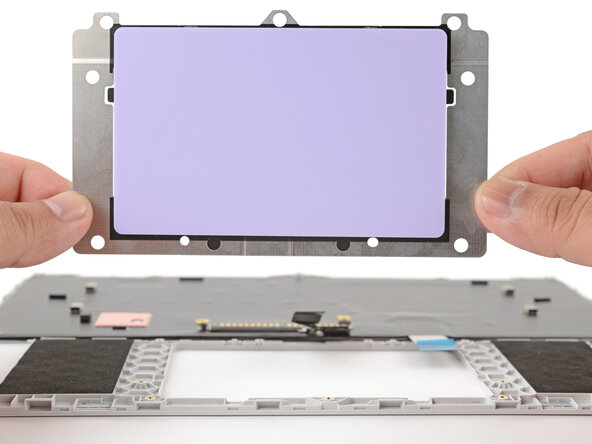

  12. Framework Laptop 12 Touchpad Replacement, Remove the touchpad: 12 단계, 이미지 3개 중 1개 Framework Laptop 12 Touchpad Replacement, Remove the touchpad: 12 단계, 이미지 3개 중 2개 Framework Laptop 12 Touchpad Replacement, Remove the touchpad: 12 단계, 이미지 3개 중 3개
    • Use your fingers to pop the touchpad out of the Input Cover from the underside.
    • Lift and remove the touchpad.

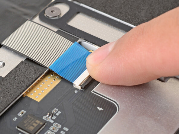

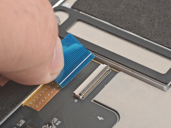

  17. Framework Laptop 12 Touchpad Replacement, Connect the touchpad cables: 17 단계, 이미지 3개 중 1개 Framework Laptop 12 Touchpad Replacement, Connect the touchpad cables: 17 단계, 이미지 3개 중 2개 Framework Laptop 12 Touchpad Replacement, Connect the touchpad cables: 17 단계, 이미지 3개 중 3개
    • Slide the keyboard ZIF cable into its connector, up to the printed line on the cable.
    • Use your finger to flip down and gently press the locking tab in place.

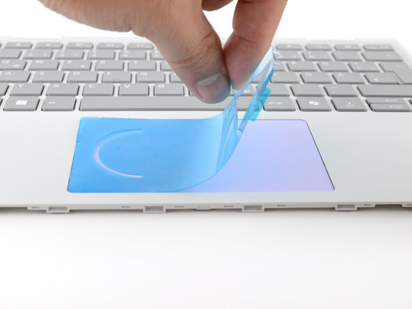

  19. Framework Laptop 12 Touchpad Replacement, Remove the alignment tool: 19 단계, 이미지 2개 중 1개 Framework Laptop 12 Touchpad Replacement, Remove the alignment tool: 19 단계, 이미지 2개 중 2개
    • Skip this step if you didn't use an alignment tool.
    • Use your fingers to peel and remove the alignment tool from the touchpad.

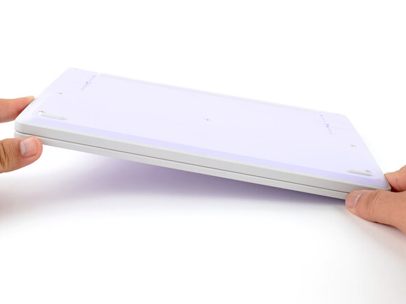

  21. Framework Laptop 12 Touchpad Replacement, Close and flip your laptop: 21 단계, 이미지 2개 중 1개 Framework Laptop 12 Touchpad Replacement, Close and flip your laptop: 21 단계, 이미지 2개 중 2개
    • Close the laptop lid.
    • Flip your laptop face-down on a clean work surface.
