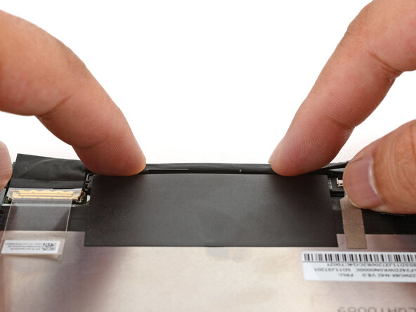

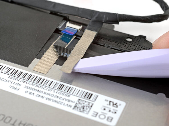

  41. Framework Laptop 12 eDP Display Cable Replacement, Disconnect the display cable: 41 단계, 이미지 2개 중 1개 Framework Laptop 12 eDP Display Cable Replacement, Disconnect the display cable: 41 단계, 이미지 2개 중 2개
    • Slide the flat end of your Framework Screwdriver under the grounding tape securing the display cable.
    • Lift slowly to separate the tape from the display.

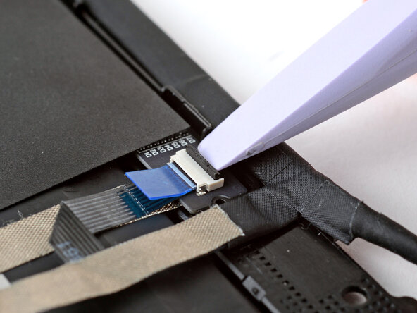

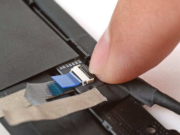

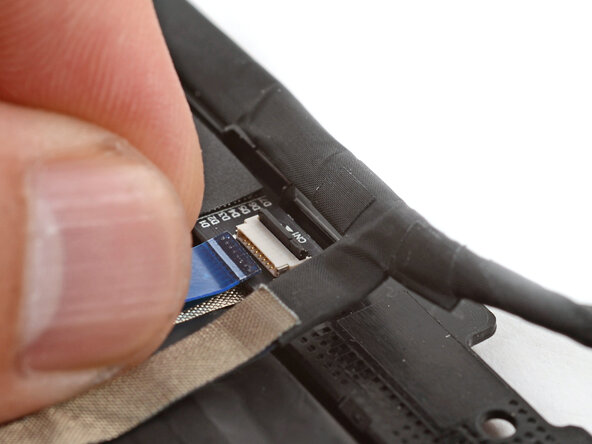

  42. Framework Laptop 12 eDP Display Cable Replacement, Disconnect the touch control cable: 42 단계, 이미지 3개 중 1개 Framework Laptop 12 eDP Display Cable Replacement, Disconnect the touch control cable: 42 단계, 이미지 3개 중 2개 Framework Laptop 12 eDP Display Cable Replacement, Disconnect the touch control cable: 42 단계, 이미지 3개 중 3개
    • Use the flat end of your Framework Screwdriver or a fingernail to gently pry up the locking tab on the touch control ZIF connector near the hinge edge of the display.
    • Use your fingers to grab the touch control cable by the blue tab and slide the cable out of the connector.

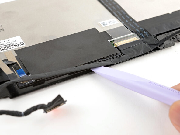

  43. Framework Laptop 12 eDP Display Cable Replacement, Loosen the display cable: 43 단계, 이미지 2개 중 1개 Framework Laptop 12 eDP Display Cable Replacement, Loosen the display cable: 43 단계, 이미지 2개 중 2개
    • Slide the flat edge of your Framework Screwdriver under the length of the display cable to separate it from the display.

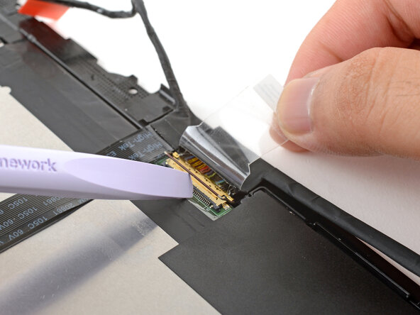

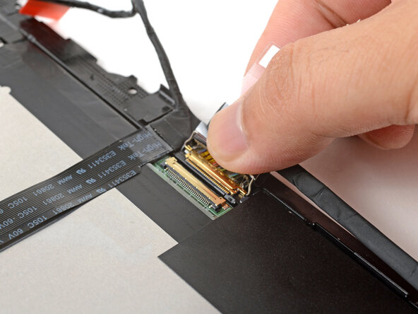

  44. Framework Laptop 12 eDP Display Cable Replacement, Disconnect the display cable: 44 단계, 이미지 2개 중 1개 Framework Laptop 12 eDP Display Cable Replacement, Disconnect the display cable: 44 단계, 이미지 2개 중 2개
    • Use your fingers to peel up the clear tab covering the display cable connector.
  45. Framework Laptop 12 eDP Display Cable Replacement: 45 단계, 이미지 2개 중 1개 Framework Laptop 12 eDP Display Cable Replacement: 45 단계, 이미지 2개 중 2개
    • Use the flat end of your Framework Screwdriver to flip up the locking bar around the display connector.
  46. Framework Laptop 12 eDP Display Cable Replacement: 46 단계, 이미지 2개 중 1개 Framework Laptop 12 eDP Display Cable Replacement: 46 단계, 이미지 2개 중 2개
    • Make sure the locking bar doesn't fall back in place while you disconnect the display cable.
    • Grab the display cable near the connector and slide it out of the connector.
    • If you have trouble getting the cable to slide out, gently wiggle it to loosen the connection.
  47. Framework Laptop 12 eDP Display Cable Replacement, Remove the display cable: 47 단계, 이미지 1개 중 1개
    • Remove the display cable.

  51. Framework Laptop 12 eDP Display Cable Replacement: 51 단계, 이미지 3개 중 1개 Framework Laptop 12 eDP Display Cable Replacement: 51 단계, 이미지 3개 중 2개 Framework Laptop 12 eDP Display Cable Replacement: 51 단계, 이미지 3개 중 3개
    • Slide the touch control cable into the ZIF connector up to the printed line on the cable.
    • Use your finger to flip down and gently press the locking tab in place.
  52. Framework Laptop 12 eDP Display Cable Replacement: 52 단계, 이미지 2개 중 1개 Framework Laptop 12 eDP Display Cable Replacement: 52 단계, 이미지 2개 중 2개
    • Use your finger to press the display cable grounding tape onto the display.
    • Use your fingers to press the display cable onto the metal back of the display.
