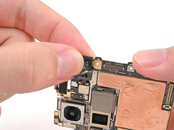

  42. Google Pixel 9 Pro Fold 5G mmWave Antenna Replacement, Disconnect the 5G mmWave antenna: 42 단계, 이미지 2개 중 1개 Google Pixel 9 Pro Fold 5G mmWave Antenna Replacement, Disconnect the 5G mmWave antenna: 42 단계, 이미지 2개 중 2개
    • Use a spudger to pry up and disconnect the 5G mmWave antenna press connector.

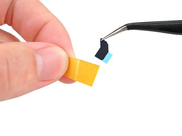

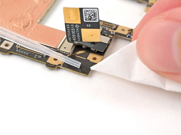

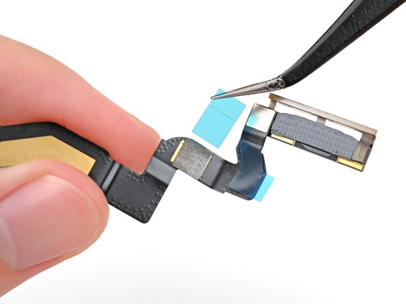

  43. Google Pixel 9 Pro Fold 5G mmWave Antenna Replacement, Separate the 5G mmWave antenna adhesive: 43 단계, 이미지 3개 중 1개 Google Pixel 9 Pro Fold 5G mmWave Antenna Replacement, Separate the 5G mmWave antenna adhesive: 43 단계, 이미지 3개 중 2개 Google Pixel 9 Pro Fold 5G mmWave Antenna Replacement, Separate the 5G mmWave antenna adhesive: 43 단계, 이미지 3개 중 3개
    • Adhesive secures the 5G mmWave antenna cable on both sides of the logic board.
    • Slide the flat end of a spudger under the 5G mmWave antenna cable's adhered section on the bottom of the logic board
    • Pry up the cable to separate the adhesive.
    • Use tweezers, or your fingers, to pull the cable off the logic board and separate any remaining adhesive.

    • Repeat the previous step for the 5G mmWave antenna cable's adhered section on the top of the logic board.
    • Remove the 5G mmWave antenna.

  48. Google Pixel 9 Pro Fold 5G mmWave Antenna Replacement, Apply new adhesive: 48 단계, 이미지 2개 중 1개 Google Pixel 9 Pro Fold 5G mmWave Antenna Replacement, Apply new adhesive: 48 단계, 이미지 2개 중 2개
    • Remove the curved adhesive strip from its opaque liner to expose the adhesive underneath.
  49. Google Pixel 9 Pro Fold 5G mmWave Antenna Replacement: 49 단계, 이미지 2개 중 1개 Google Pixel 9 Pro Fold 5G mmWave Antenna Replacement: 49 단계, 이미지 2개 중 2개
    • Align the curved adhesive strip over the same‑shaped section of the 5G mmWave antenna cable and press it in place.
  50. Google Pixel 9 Pro Fold 5G mmWave Antenna Replacement: 50 단계, 이미지 3개 중 1개 Google Pixel 9 Pro Fold 5G mmWave Antenna Replacement: 50 단계, 이미지 3개 중 2개 Google Pixel 9 Pro Fold 5G mmWave Antenna Replacement: 50 단계, 이미지 3개 중 3개
    • Repeat the previous two steps for the square‑shaped adhesive strip, placing it over the gold section on the 5G mmWave antenna cable.
    • Remove the colored liners from both of the adhesive strips to expose the adhesive underneath.
  51. Google Pixel 9 Pro Fold 5G mmWave Antenna Replacement, Reinstall the 5G mmWave Antenna: 51 단계, 이미지 3개 중 1개 Google Pixel 9 Pro Fold 5G mmWave Antenna Replacement, Reinstall the 5G mmWave Antenna: 51 단계, 이미지 3개 중 2개 Google Pixel 9 Pro Fold 5G mmWave Antenna Replacement, Reinstall the 5G mmWave Antenna: 51 단계, 이미지 3개 중 3개
    • Reconnect the 5G mmWave antenna cable.
    • Wrap the cable around its original spot on the logic board and pinch it to re-adhere both sides.
