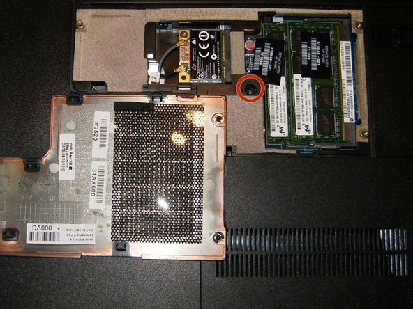

    • Use a plastic opening tool (or equivalent) to lift the back side of the cover. Small tabs hold the cover in place. Firmly pull up on the cover to release the tabs.
    • Remove the memory module compartment cover, remove the Phillips M2.5X5.0 screw

Use a #1 Phillips, #0 in a pinch - #00 is too small. Also my G72 has different screw locations holding on the memory and hard drive covers. Mine also does not require removing the hard drive cover. The necessary screw locations are marked with a little keyboard icon.
Apart from the variations, good article with decent illustrations. Anyone willing to tackle the job should be able to do it in fifteen minutes or less.
