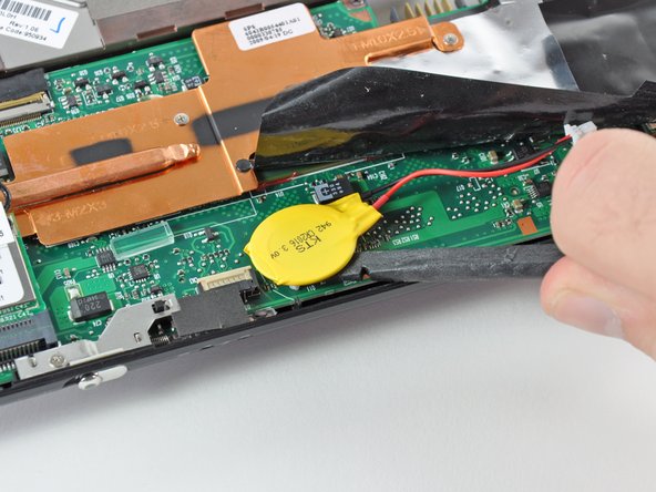

  18. HP Mini 1000 PRAM Battery Replacement, PRAM Battery: 18 단계, 이미지 1개 중 1개
    • If present, carefully peel back the large piece of black film attached to the heat sink to reveal the PRAM battery and its connector.
    • It is not necessary to completely remove this film.
  19. HP Mini 1000 PRAM Battery Replacement: 19 단계, 이미지 2개 중 1개 HP Mini 1000 PRAM Battery Replacement: 19 단계, 이미지 2개 중 2개
    이 단계에 사용된 도구:
    • Use a pair of tweezers to pull the PRAM battery connector out of its socket.
    • Pull the connector parallel to the face of the motherboard toward the fan side of the computer.
    • Use the flat end of a spudger to pry the PRAM battery off the adhesive securing it to the motherboard.
    • Remove the PRAM battery.
