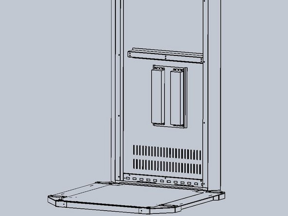

    • Install the rear panel onto the floor panel
    • Note: The rear panel can be recognized because there is a small grey flat cable coming out of the top.
    • Align the rear panel precisely over positioning holes in the floor and lower it carefully until it clicks into place.
    • Use the four shorter M8 bolts to fix the panel onto the floor.
    • WARNING! Be careful not to tilt over the panels. The system is only stable after the roof has been installed.

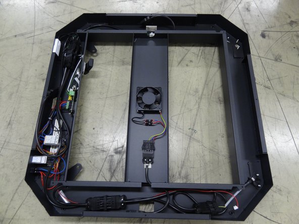

    • Remove the top panel from the roof
    • Note: Your top panel make look different. That means you have another iteration of the system.
  7. Installing the UV9000 UV Therapy System: 7 단계, 이미지 3개 중 1개 Installing the UV9000 UV Therapy System: 7 단계, 이미지 3개 중 2개 Installing the UV9000 UV Therapy System: 7 단계, 이미지 3개 중 3개
    • Lift the roof on top of the wall panels (the display should be above the rear panel)
    • Align the panels with the roof and insert long M8 bolts
    • Tighten the bolts to secure the roof (each panel requires four bolts)

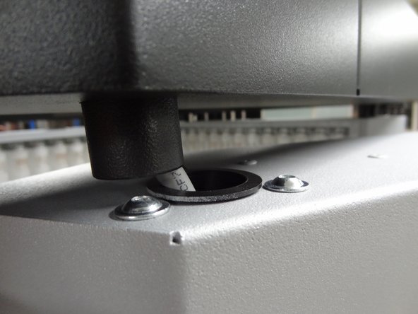

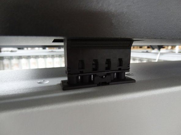

    • Click the connector at the roof for each panel in the corresponding socket at the top of the rear, left and right side panel
    • On the rear panel, push the grey flat cable carefully through the opening in the roof, and connect it to the CPU module (there is only one open socket on the CPU module).

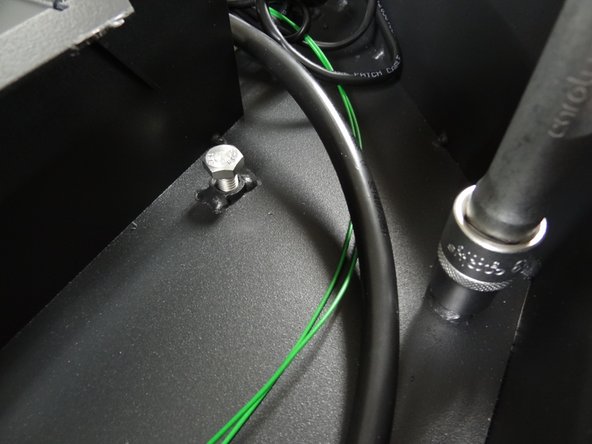

    • Straighten the door and push the cable at the top of the door through the round hole in the roof and through the round metal peg
    • Slide the round metal peg into the cable opening of the door, actually securing the door

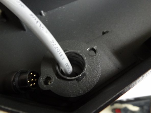

  12. Installing the UV9000 UV Therapy System: 12 단계, 이미지 1개 중 1개
    • Close the roof with the metal plate
