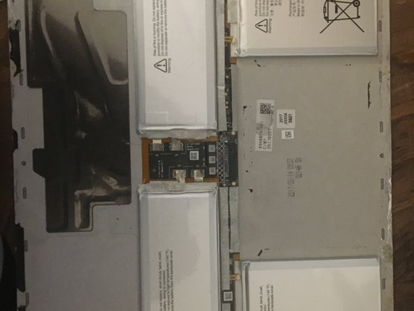

    • You should use an iFixit jimmy tool, a set of screwdrivers conaining a Torx T4, and a phillips bit, and an iOpener. You can be risky like me and use a hair dryer and a scraper! The T4 is necessary though

    • Heat up the area until unpleasant to touch using a heat gun or hair dryer.
    • This should be around 130 degrees Fahrenheit.
    • Careful! Don't get too brave! Heat guns get hot very quickly.
    • Use your jimmy to PRY!!!! PRY ruthlessly!!!!!
    • Please be careful. Do not actually pry ruthlessly.
    • Insert jimmy.
    • Tilt the jimmy flat.
    • Give a pick a little room to insert.
    • pull out the jimmy.
    • Insert into a different location on the device
    • In the video, the device had already been opened and replaced, which is why it seems easier to open

    • Disconnect the cable from the battery to the motherboard.

    • Separate the back panel from the top panel
    • Heat up the back panel to about 130 degrees Fahrenheit.
    • Heating up batteries can be dangerous, Proceed with caution
    • Grab a nonmetal bucket, and fill it with sand. (1/2 gallon should do it)
    • This is in case the batteries get punctured or catch fire when being removed.
    • If you notice that you have punctured the battery or notice a sweet, metallic smell, throw the backplate into the bucket, and move the bucket and yourself outside.
    • See here: iFixit Battery Safety
    • Gently, take your opening picks, and VERY, VERY gently, scrape the adhesive out from under the battery.
    • Put the batteries in the bucket and take them to a nearby battery recycling facility. battery recycling facility list
    • Unpackage your new, beautiful, fantastic Surface Book Keyboard battery.
    • Take that battery, and take some of that adhesive, stick it to the back of the battery.
    • Put it on the backplate.
    • Plug in the connector that was keeping you from being able to pull the backplate off.
    • Take your adhesive, line the edges with the adhesive and put the backplate back on
