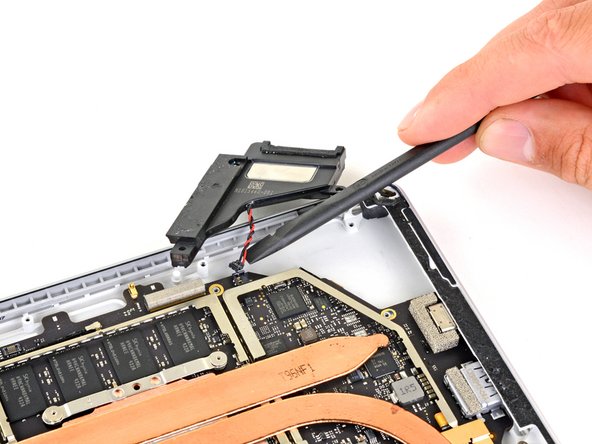

  33. Microsoft Surface Pro 7 Right Speaker Replacement: 33 단계, 이미지 2개 중 1개 Microsoft Surface Pro 7 Right Speaker Replacement: 33 단계, 이미지 2개 중 2개
    • Gently slide the flat end of a spudger between the speaker wires and the motherboard until it is resting against the connector.
    • Carefully pry straight up on the connector to disconnect it from the motherboard.
    • Be gentle; the speaker wires are delicate.
    • Remove the right speaker.
    • During reassembly, place the new speaker wire harness on top of the connector on the motherboard and gently press it straight down with your finger to reconnect it.
