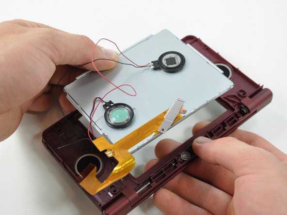

  36. Nintendo DSi XL Upper LCD Replacement, Upper Display Assembly: 36 단계, 이미지 2개 중 1개 Nintendo DSi XL Upper LCD Replacement, Upper Display Assembly: 36 단계, 이미지 2개 중 2개
    • Lift both of the speakers from their seats on the front display bezel.
  37. Nintendo DSi XL Upper LCD Replacement: 37 단계, 이미지 1개 중 1개
    • De-route the speaker wires that run above the upper display screen.
  38. Nintendo DSi XL Upper LCD Replacement: 38 단계, 이미지 2개 중 1개 Nintendo DSi XL Upper LCD Replacement: 38 단계, 이미지 2개 중 2개
    • Remove the upper display assembly.
  39. Nintendo DSi XL Upper LCD Replacement, Upper LCD: 39 단계, 이미지 1개 중 1개
    • To separate the upper LCD and speakers, desolder the contacts on the orange ribbon cable.
    • For detailed instructions on how to solder this type of connection, see our guide for repairing soldered connections.
    • Upper LCD remains
