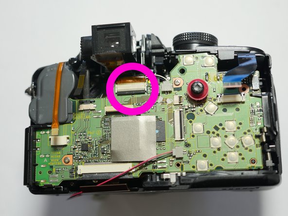

  10. Panasonic DMC-FZ35 Main Board Replacement, Release the Main PCB Flex Cables: 10 단계, 이미지 3개 중 1개 Panasonic DMC-FZ35 Main Board Replacement, Release the Main PCB Flex Cables: 10 단계, 이미지 3개 중 2개 Panasonic DMC-FZ35 Main Board Replacement, Release the Main PCB Flex Cables: 10 단계, 이미지 3개 중 3개
    • Pull the 3 flex cables out using flat needle nose pliers (it is easier to slide open the black clamps prior to pulling). These are sliding clamps not flip (up) clamps.
    • Pull the single cable from the socket. This is a friction fit socket.
    • Flip up the Cable clamp (picture #2) using a spudger as shown in the previous pages and release the cable.
    • Flip up the Cable Clamp (picture #3) using a spudger and release the cable.

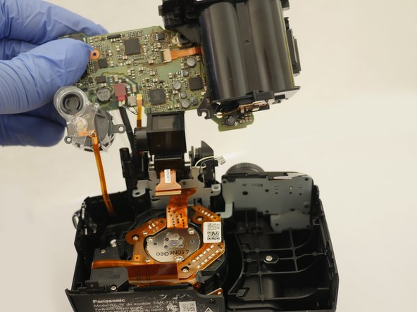

    • Open battery compartment
    • Grab battery door and lift up (do not remove yet) the Main Board and Compartment Part
    • Carefully flip over board and pull up so that the flash assembly rises along with the main board from the camera body. Remove entire assembly from the camera body.

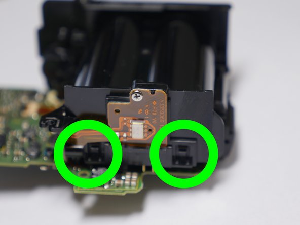

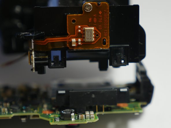

    • Release the two cables from the main board.
    • Used spudger to flip up cable clamp and remove flex cable
    • Release the two hold clips and remove battery compartment
