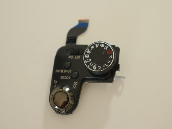

    • Swap out your old Board
  16. Panasonic DMC-FZ35 Top Control Panel Replacement, Top Control Panel: 16 단계, 이미지 3개 중 1개 Panasonic DMC-FZ35 Top Control Panel Replacement, Top Control Panel: 16 단계, 이미지 3개 중 2개 Panasonic DMC-FZ35 Top Control Panel Replacement, Top Control Panel: 16 단계, 이미지 3개 중 3개
    • Pull out Top control panel from camera body
