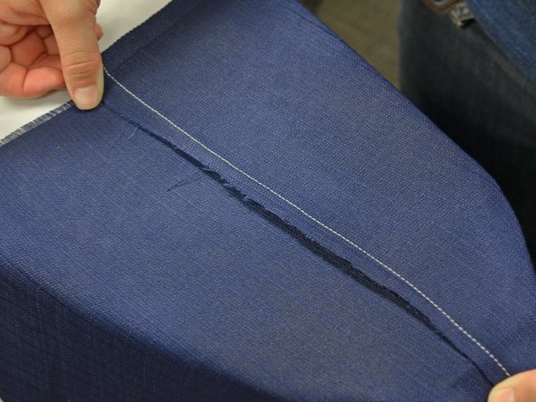

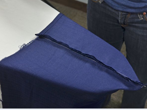

  4. Press and Iron Fabrics, Ironing a Seam: 4 단계, 이미지 1/2 Press and Iron Fabrics, Ironing a Seam: 4 단계, 이미지 2/2
    • When ironing a seam, flip the project inside out so the seam is visible.
    • Slide the fabric over the end of the ironing board, seam side up, so that only one layer of the fabric is ironed at a time.

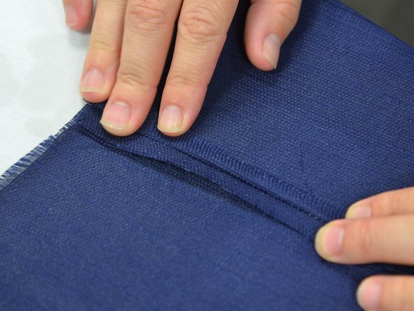

  6. Press and Iron Fabrics: 6 단계, 이미지 1/3 Press and Iron Fabrics: 6 단계, 이미지 2/3 Press and Iron Fabrics: 6 단계, 이미지 3/3
    • To press a seam, open the seam up by separating the two pieces of fabric in the seam.
    • Take the iron and go directly down onto the seam.
    • Do not move the iron, simply let the iron sit on the seam for 10-30 seconds. Lift and repeat.
    • Allow the iron to do the work. Don't apply lots of pressure. If you have a stubborn wrinkle, apply steam from your iron, or mist the fabric with distilled water before pressing.
