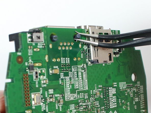

  9. Roku 3 Ethernet Port Replacement: 9 단계, 이미지 2개 중 1개 Roku 3 Ethernet Port Replacement: 9 단계, 이미지 2개 중 2개
    • Locate the plastic push-throughs just to the left of the backside of the USB port.
    • Pinch the plastic push-throughs. The port should now be able to be removed.
