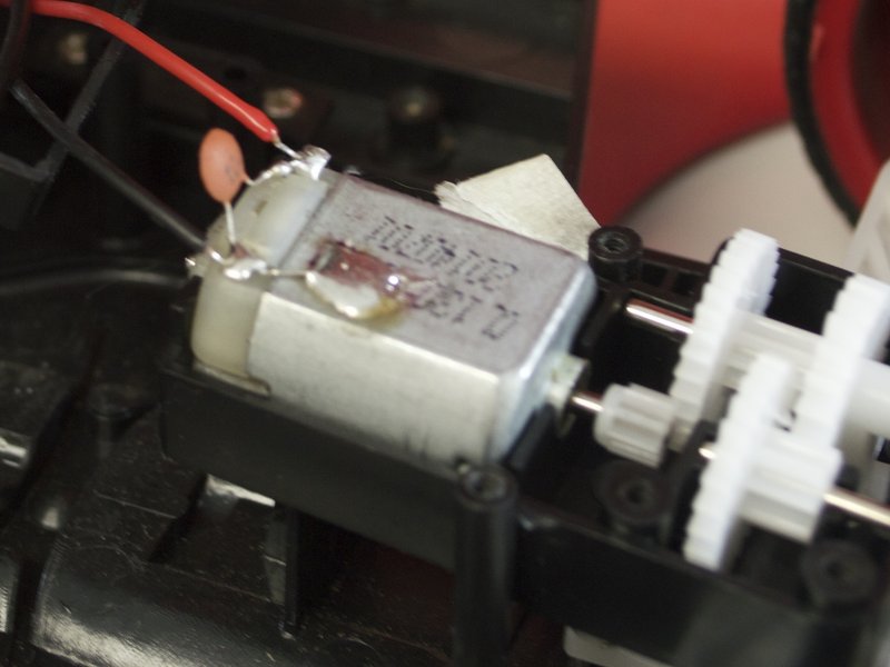

    • Remove motor. Lift the servos core motor out of the motor housing. Be careful not to pull out the plastic gears while doing so.
  8. X-Street STR Viper Core Motor Servos Replacement: 8 단계, 이미지 1/2 X-Street STR Viper Core Motor Servos Replacement: 8 단계, 이미지 2/2
    • Detach wires. Desolder or clip the back red and black wires from the motor. Use a soldering iron or wire cutters; do not use scissors as shown in the photo.
    • An orange circular wire known as a thermistor will be soldered with the two wires. Detach this part as well.
  9. X-Street STR Viper Core Motor Servos Replacement: 9 단계, 이미지 1/1
    • Solder wires back on. The last step will be to solder the red wire back on the left side of the motor and the black wire back on the right side. You can do this by referring to this how to solder/desolder page.
