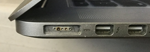

Sounds like a messed up keyboard! Did you have a liquid spill at some point?
You may also have a worn-out battery as well given the systems age. So your system is mostly dependent on the MagSafe charger so when you bump the system the power is disrupted.
Inspect the MagSafe charger cord and socket to make sure they are clean. Hopefully they aren't like this
Or as dirty as the top one
Or burnt like this one
If you can install this gem of an app! CoconutBattery take a snapshot of the apps main window and post it here for us to see 기존 질문에 이미지 추가하기 just don't bang the system to much!
