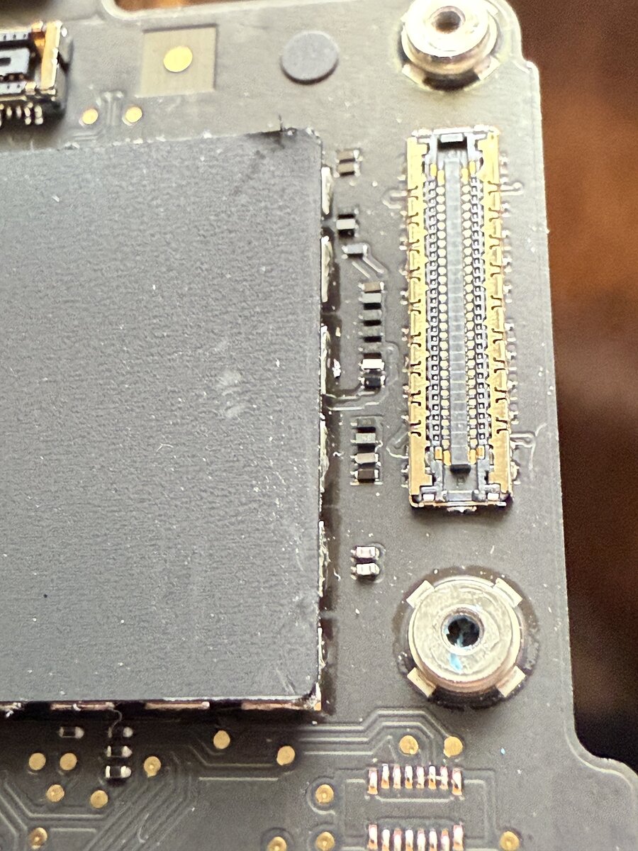

I can only charge and use one of the 2 USB-C ports on the laptop. The one closest to the hinge doesn't work on this laptop. I bought a replacement USB-C part from iFixit, but still the one closest to the hinge doesn't work. It won't charge or connect to external devices like a USB hard drive.
One time when powering it on while plugged into power the machine did display a message saying:
"USB Accessories Disabled
Unplug the accessory using too much power to re-enable USB devices."
This message has only been seen once though. The laptop does however drain the battery super fast, but the battery health in settings says the battery is Normal.
Any ideas what this could be?

Other than the ribbon cable connection to the logic board from the port assembly, the logic board connector might have some damage. But it would have been there before you replaced the port assembly.
Did the system get wet around the ports? I would inspect the connector and look as best as you can around the metal shielded just behind as that’s the Thunderbolt 3 controller (marked in light blue here)

I pulled the logic board out and inspected it as closely as I possibly could, there are no signs of any water damage or any other type of damage that I can see anywhere on the board. I also took double care when putting it all back together and also cleared the NVRAM and the SMC. Still not charging with the USB-C port closest to the hinge. Is this machine just SOL? Anything else we can try or check? It wouldn't be a bad battery right? Cuz then I would think both ports would have issues.
@barylak - At this point the given ports logic within the logic board would need checking. it’s possible someone with deep logic board repair skills might be able to repair the logic board, you could just live with only one port working, otherwise one could replace the logic board.

@barylak "one closest to the hinge" means it would be the secondary port (rear left). Both ports have their own controller and it is easily possible that you are having issues with one of them. Here is the location for the one that would control that port.
You got a multimeter? Post some really good pictures of your logic board with your Question. The controller is on the bottom side of the logic board. Let's see if we can make out things that may be the issue here.

@barylak the other controller IC is on the top side of the board.
It is marked in orange and was identified by the iFixit team as "Texas Instruments CD3217B12 and TPS51980B (likely power controllers)"
Here are the locations for the primary and secondary USB controller IC's
and here is the schematic for both of those as well
Update (04/25/25)
@barylak check the fuses F3001 and F3000 for continuity. After that you will have to check those for power as well. I've marked the points where to check with red arrows. Expectation here would be no less than at least 12VDC. Of course only do this if you are comfortable measuring these. If you have any doubts, farm it out and let somebody else fix it :-)

Sorry, didn’t see these responses until today, I really appreciate the help being provided. I will try to post the best pictures I can take shortly.
I added a bunch of pictures to the post of the thunderbolt area, and the usb ICs
