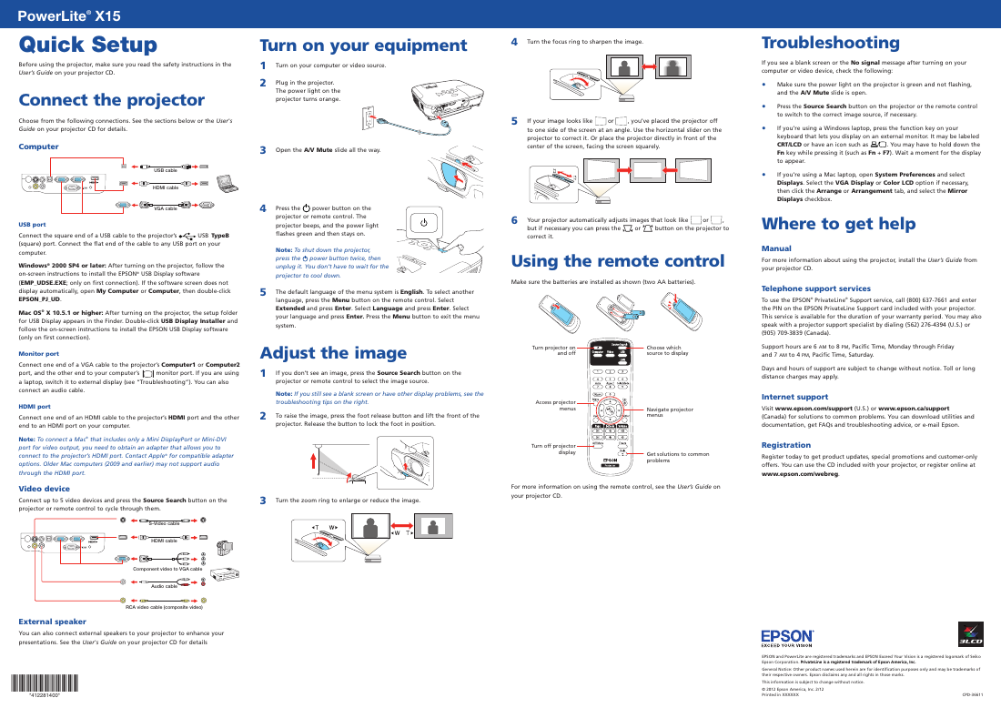

Quick Setup
Before using the projector, make sure you read the safety instructions in the User's Guide on your projector CD.
Connect the projector
Choose from the following connections. See the sections below or the User's Guide on your projector CD for details.
Computer
USB cable HDMI cable VGA cable
USB port
Connect the square end of a USB cable to the projector's ☐ USB TypeB (square) port. Connect the flat end of the cable to any USB port on your computer.
Windows® 2000 SP4 or later: After turning on the projector, follow the on-screen instructions to install the EPSON® USB Display software (EMP_UDSE.EXE; only on first connection). If the software screen does not display automatically, open My Computer or Computer, then double-click EPSON_PJ_UD.
Mac OS® X 10.5.1 or higher: After turning on the projector, the setup folder for USB Display appears in the Finder. Double-click USB Display Installer and follow the on-screen instructions to install the EPSON USB Display software (only on first connection).
Monitor port
Connect one end of a VGA cable to the projector's Computer1 or Computer2 port, and the other end to your computer's ☐ monitor port. If you are using a laptop, switch it to external display (see "Troubleshooting"). You can also connect an audio cable.
HDMI port
Connect one end of an HDMI cable to the projector's HDMI port and the other end to an HDMI port on your computer.
Note: To connect a Mac® that includes only a Mini DisplayPort or Mini-DVI port for video output, you need to obtain an adapter that allows you to connect to the projector's HDMI port. Contact Apple® for compatible adapter options. Older Mac computers (2009 and earlier) may not support audio through the HDMI port.
Video device
Connect up to 5 video devices and press the Source Search button on the projector or remote control to cycle through them.
S-Video cable HDMI cable Component video to VGA cable Audio cable RCA video cable (composite video)
External speaker
You can also connect external speakers to your projector to enhance your presentations. See the User's Guide on your projector CD for details
Turn on your equipment
1 Turn on your computer or video source.
2 Plug in the projector.
The power light on the projector turns orange.
0
3 Open the A/V Mute slide all the way.
Press the ⚪ power button on the projector or remote control. The projector beeps, and the power light flashes green and then stays on.
Note: To shut down the projector, press the ⏱️ power button twice, then unplug it. You don't have to wait for the projector to cool down.
5 The default language of the menu system is English. To select another language, press the Menu button on the remote control. Select Extended and press Enter. Select Language and press Enter. Select your language and press Enter. Press the Menu button to exit the menu system.
Adjust the image
If you don't see an image, press the Source Search button on the projector or remote control to select the image source.
Note: If you still see a blank screen or have other display problems, see the troubleshooting tips on the right.
2 To raise the image, press the foot release button and lift the front of the projector. Release the button to lock the foot in position.
