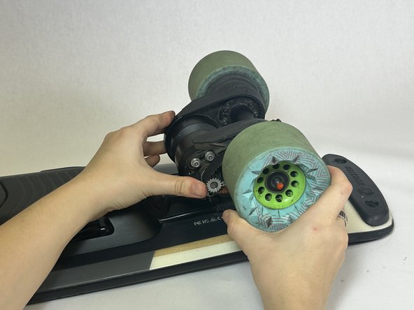

  9. Boosted Mini Belt Replacement: 9 단계, 이미지 2개 중 1개 Boosted Mini Belt Replacement: 9 단계, 이미지 2개 중 2개
    • Place the wheel with its new belt inner side first on the axle, making sure the belt is securely back over the motor pulley.
