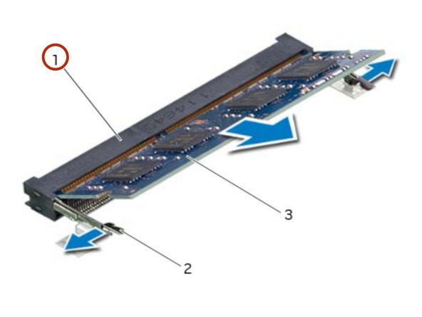

  16. Dell Alienware 14 Memory Module Replacement, Popping up the Memory Module: 17 단계, 이미지 3개 중 1개 Dell Alienware 14 Memory Module Replacement, Popping up the Memory Module: 17 단계, 이미지 3개 중 2개 Dell Alienware 14 Memory Module Replacement, Popping up the Memory Module: 17 단계, 이미지 3개 중 3개
    • WARNING: Before working inside your computer, read the safety information that shipped with your computer and follow the steps in Before Working Inside Your Computer. After working inside your computer, follow the instructions in After Working Inside Your Computer.
    • CAUTION: To prevent damage to the memory-module connector, do not use tools to spread the memory-module securing clips.
    • Using your fingertips, carefully spread apart the securing clips on each end of the memory-module connector until the memory module pops up.
    댓글 쓰기
  17. Dell Alienware 14 Memory Module Replacement, Remove the Memory Module: 18 단계, 이미지 2개 중 1개 Dell Alienware 14 Memory Module Replacement, Remove the Memory Module: 18 단계, 이미지 2개 중 2개
    • Remove the memory module from the memory-module connector.
