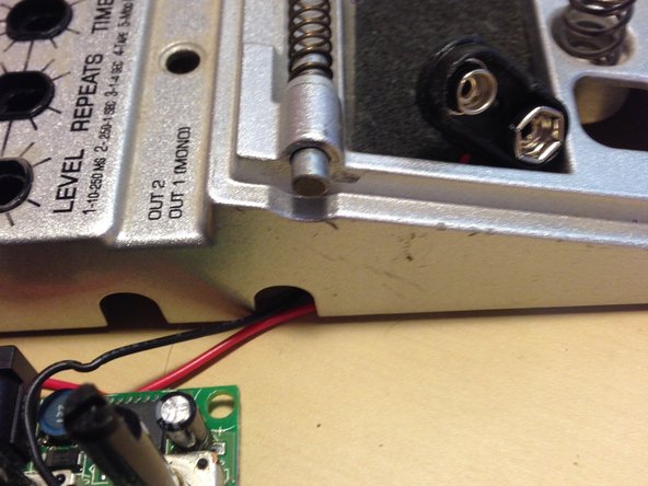

    6. DigiTech Digidelay Disassembly, 9V Battery Snap Connector: 6 단계, 이미지 2개 중 1개 DigiTech Digidelay Disassembly, 9V Battery Snap Connector: 6 단계, 이미지 2개 중 2개
      • Remove the 9V battery snap connector from the battery casing before attempting to completely remove the motherboard from the chassis.

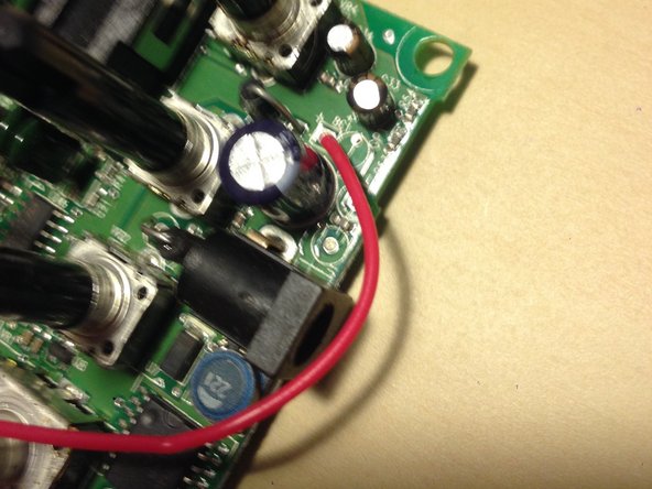

    14. DigiTech Digidelay Disassembly, 9V Battery Snap Connector (Continued): 14 단계, 이미지 3개 중 1개 DigiTech Digidelay Disassembly, 9V Battery Snap Connector (Continued): 14 단계, 이미지 3개 중 2개 DigiTech Digidelay Disassembly, 9V Battery Snap Connector (Continued): 14 단계, 이미지 3개 중 3개
      • The 9V Battery Snap Connector is connected to motherboard via 2 wires: 1 red and 1 black.
      • The red wire is soldered to the left of the DC Adapter Port, and the black wire is soldered just below the single 1/4 inch line input jack.
      • To replace the 9V Battery Snap Connector, simply re-solder the connection in the back of the motherboard at these two points.
