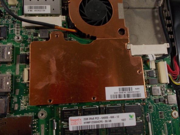

  4. ExoPC Slate CPU Fan Replacement, CPU Fan: 4 단계, 이미지 2개 중 1개 ExoPC Slate CPU Fan Replacement, CPU Fan: 4 단계, 이미지 2개 중 2개
    • Remove the yellow tape securing the wires to the PCB board as well as the silver/grey tape.
    • Unscrew the six Phillips #00 screws.

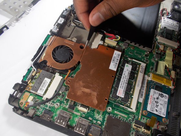

  5. ExoPC Slate CPU Fan Replacement: 5 단계, 이미지 2개 중 1개 ExoPC Slate CPU Fan Replacement: 5 단계, 이미지 2개 중 2개
    이 단계에 사용된 도구:
    • Using tweezers, disconnect the connector in the top left.
    • Pull the fan heat sink away from the PC.
    • Remove the fan from the copper heat sink with the tweezers by releasing the metal clips.
    • Apply a sparing amount of thermal paste to each chip.
    • Attach the new or cleaned fan to the heat sink using the metal clips. Line up the heat sink with the screw holes and press down firmly to spread out the thermal paste.
