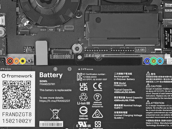

    • Your Framework Laptop comes with a spare screw of each size, attached to the chassis above the battery. You can use the Fastener Kit to replenish any screws you used there.

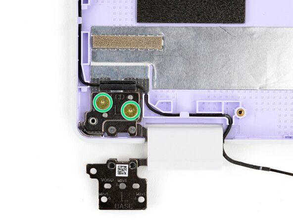

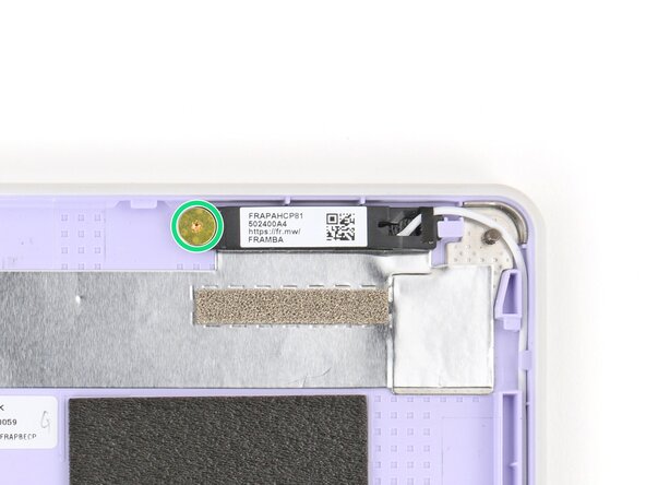

  2. Framework Laptop 12 Fastener Guide, Antenna screws: 2 단계, 이미지 3개 중 1개 Framework Laptop 12 Fastener Guide, Antenna screws: 2 단계, 이미지 3개 중 2개 Framework Laptop 12 Fastener Guide, Antenna screws: 2 단계, 이미지 3개 중 3개
    • Use the gold screws labeled "M2 2.0mm fastener with a 6.0mm diameter 0.5mm thick T5 head" to secure the antennas.

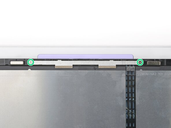

  3. Framework Laptop 12 Fastener Guide, Display screws: 3 단계, 이미지 2개 중 1개 Framework Laptop 12 Fastener Guide, Display screws: 3 단계, 이미지 2개 중 2개
    • Use the silver screws labeled "M2 2.8mm fastener with a 4.0mm diameter 0.5mm thick T5 head" to secure the display.
    • Tighten the screws until they're snug. Don't over-tighten them, or you may break the screw tabs.

  5. Framework Laptop 12 Fastener Guide, Hinge screws (bottom): 5 단계, 이미지 3개 중 1개 Framework Laptop 12 Fastener Guide, Hinge screws (bottom): 5 단계, 이미지 3개 중 2개 Framework Laptop 12 Fastener Guide, Hinge screws (bottom): 5 단계, 이미지 3개 중 3개
    • Use the silver screws labeled "M2 4.0mm fastener with a 4.6mm diameter 0.6mm thick T5 head" to secure the hinges to the Bottom Cover.

  6. Framework Laptop 12 Fastener Guide, Hinge screws (top): 6 단계, 이미지 3개 중 1개 Framework Laptop 12 Fastener Guide, Hinge screws (top): 6 단계, 이미지 3개 중 2개 Framework Laptop 12 Fastener Guide, Hinge screws (top): 6 단계, 이미지 3개 중 3개
    • Use the gold screws labeled "M2 2.0mm fastener with a 6.0mm diameter 0.5mm thick T5 head" to secure the hinges to the Top Cover.

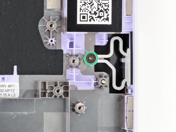

  7. Framework Laptop 12 Fastener Guide, Power Button screw: 7 단계, 이미지 2개 중 1개 Framework Laptop 12 Fastener Guide, Power Button screw: 7 단계, 이미지 2개 중 2개
    • Use the grey screw labeled "M1.6 1.5mm fastener with a 5.5mm diameter 0.6mm thick T5 head" to secure the Power Button.

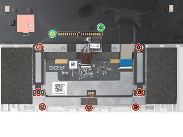

  9. Framework Laptop 12 Fastener Guide, Touchpad screws: 9 단계, 이미지 3개 중 1개 Framework Laptop 12 Fastener Guide, Touchpad screws: 9 단계, 이미지 3개 중 2개 Framework Laptop 12 Fastener Guide, Touchpad screws: 9 단계, 이미지 3개 중 3개
    • Use the grey screws labeled "M1.6 1.5mm fastener with a 5.5mm diameter 0.6mm thick T5 head" to secure the touchpad.
    • Use the gold screws labeled "M2 2.0mm fastener with a 6.0mm diameter 0.5mm thick T5 head" to secure the touchpad pogo connector.
