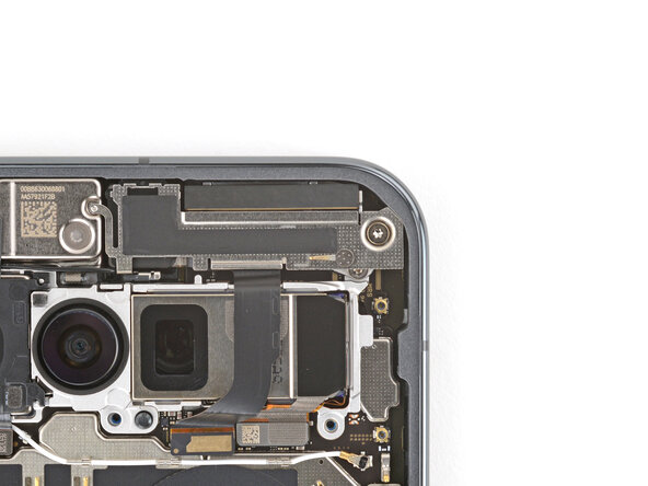

  16. Google Pixel 10 Pro XL Front Camera Replacement, Remove the motherboard cover screws: 16 단계, 이미지 2개 중 1개 Google Pixel 10 Pro XL Front Camera Replacement, Remove the motherboard cover screws: 16 단계, 이미지 2개 중 2개
    • Use a Torx Plus 3IP screwdriver to remove the four 5.0 mm‑long screws securing the motherboard cover.
  17. Google Pixel 10 Pro XL Front Camera Replacement, Remove the motherboard cover: 17 단계, 이미지 2개 중 1개 Google Pixel 10 Pro XL Front Camera Replacement, Remove the motherboard cover: 17 단계, 이미지 2개 중 2개
    • Remove the motherboard cover.

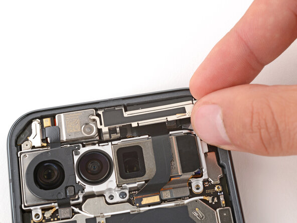

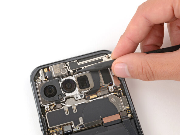

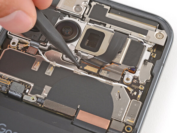

  18. Google Pixel 10 Pro XL Front Camera Replacement, Disconnect the front camera: 18 단계, 이미지 2개 중 1개 Google Pixel 10 Pro XL Front Camera Replacement, Disconnect the front camera: 18 단계, 이미지 2개 중 2개
    • Use the point of a spudger to pry up and disconnect the front camera press connector.

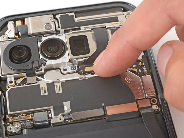

  19. Google Pixel 10 Pro XL Front Camera Replacement, Remove the front camera cover screw: 19 단계, 이미지 2개 중 1개 Google Pixel 10 Pro XL Front Camera Replacement, Remove the front camera cover screw: 19 단계, 이미지 2개 중 2개
    • Use a Torx Plus 3IP screwdriver to remove the 5.0 mm‑long screw securing the front camera cover.

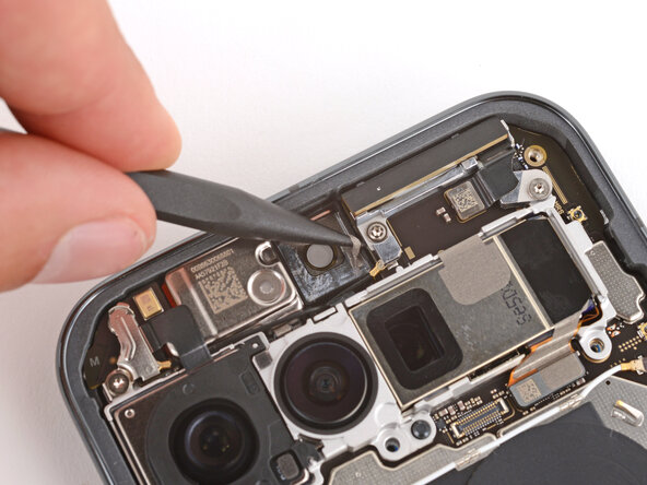

  20. Google Pixel 10 Pro XL Front Camera Replacement, Remove the front camera cover: 20 단계, 이미지 3개 중 1개 Google Pixel 10 Pro XL Front Camera Replacement, Remove the front camera cover: 20 단계, 이미지 3개 중 2개 Google Pixel 10 Pro XL Front Camera Replacement, Remove the front camera cover: 20 단계, 이미지 3개 중 3개
    • Use the point of a spudger to push the front camera bracket's clip in and up to release it.
    • Remove the cover.

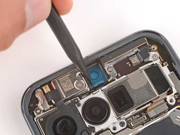

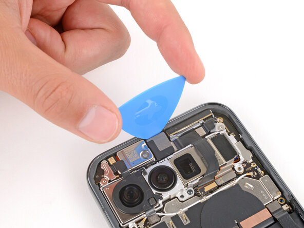

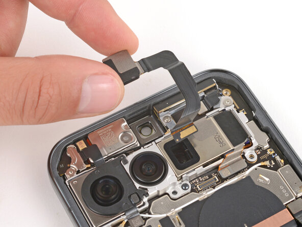

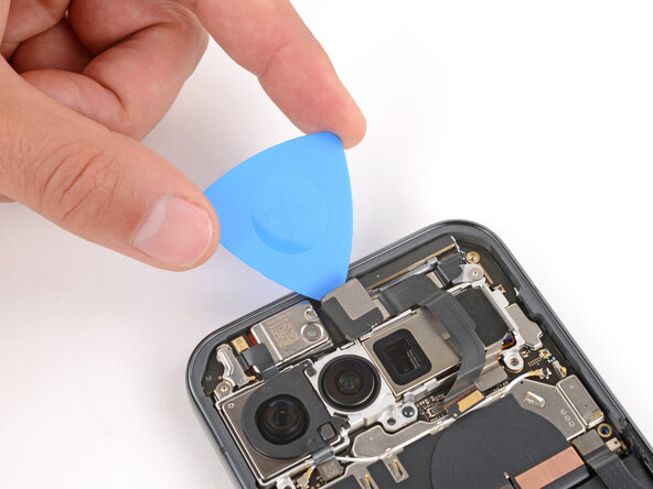

  21. Google Pixel 10 Pro XL Front Camera Replacement, Remove the front camera: 21 단계, 이미지 3개 중 1개 Google Pixel 10 Pro XL Front Camera Replacement, Remove the front camera: 21 단계, 이미지 3개 중 2개 Google Pixel 10 Pro XL Front Camera Replacement, Remove the front camera: 21 단계, 이미지 3개 중 3개
    • Adhesive secures the front camera in its recess.
    • Use the tip of an opening pick to gently pry the front camera up from the top edge and remove it.
  22. Google Pixel 10 Pro XL Front Camera Replacement, Disassembly complete: 22 단계, 이미지 1개 중 1개

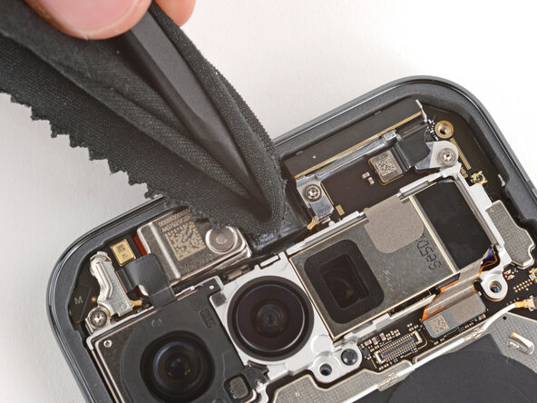

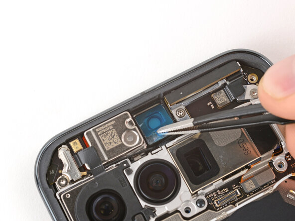

  23. Google Pixel 10 Pro XL Front Camera Replacement, Remove the old front camera adhesive: 23 단계, 이미지 2개 중 1개 Google Pixel 10 Pro XL Front Camera Replacement, Remove the old front camera adhesive: 23 단계, 이미지 2개 중 2개
    • Use the point of a spudger and tweezers to gently scrape up and remove all the old front camera adhesive.
  24. Google Pixel 10 Pro XL Front Camera Replacement: 24 단계, 이미지 1개 중 1개
    • Use a spudger wrapped in a microfiber cloth and one drop of high‑concentration (>90%) isopropyl alcohol to clean up any adhesive residue from the front camera recess.
    • Allow the alcohol to dry completely before continuing.

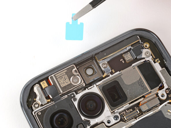

  25. Google Pixel 10 Pro XL Front Camera Replacement, Install new front camera adhesive: 25 단계, 이미지 3개 중 1개 Google Pixel 10 Pro XL Front Camera Replacement, Install new front camera adhesive: 25 단계, 이미지 3개 중 2개 Google Pixel 10 Pro XL Front Camera Replacement, Install new front camera adhesive: 25 단계, 이미지 3개 중 3개
    • Remove the large clear liner from the front camera adhesive and gently place it into the recess.
    • Use a spudger to press down firmly on the adhesive to secure it.
    • Slowly peel up and remove the remaining liner.
    • If the adhesive starts to peel up with the liner, lay it down and press it into place firmly before trying again.

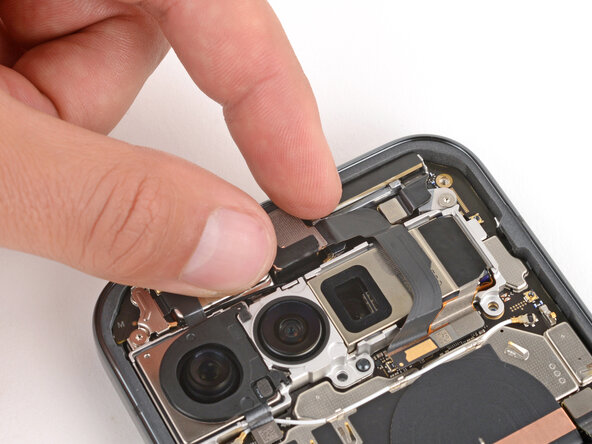

  27. Google Pixel 10 Pro XL Front Camera Replacement, Put the front camera in its recess: 27 단계, 이미지 3개 중 1개 Google Pixel 10 Pro XL Front Camera Replacement, Put the front camera in its recess: 27 단계, 이미지 3개 중 2개 Google Pixel 10 Pro XL Front Camera Replacement, Put the front camera in its recess: 27 단계, 이미지 3개 중 3개
    • With the cable facing the bottom of the phone, lay the front camera into its recess and press it into place.

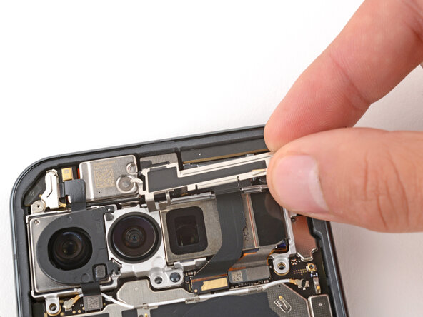

  28. Google Pixel 10 Pro XL Front Camera Replacement, Install the front camera bracket: 28 단계, 이미지 3개 중 1개 Google Pixel 10 Pro XL Front Camera Replacement, Install the front camera bracket: 28 단계, 이미지 3개 중 2개 Google Pixel 10 Pro XL Front Camera Replacement, Install the front camera bracket: 28 단계, 이미지 3개 중 3개
    • Slide the top corners of the front camera bracket under the lip in the frame and press the clip in to secure it.
    • Be careful not to touch the rear cameras.

  45. Google Pixel 10 Pro XL Front Camera Replacement, Reconnect the back glass and battery: 45 단계, 이미지 3개 중 1개 Google Pixel 10 Pro XL Front Camera Replacement, Reconnect the back glass and battery: 45 단계, 이미지 3개 중 2개 Google Pixel 10 Pro XL Front Camera Replacement, Reconnect the back glass and battery: 45 단계, 이미지 3개 중 3개
    • Use your finger to press down and connect the back glass and battery press connectors.
    • For wider connectors like the back glass one, first press down on one of the short sides until it clicks into place, then repeat on the other side. Don't press down in the middle. If the connector is misaligned, the pins can bend and cause permanent damage.
