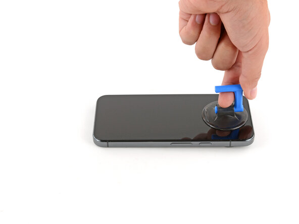

  4. Google Pixel 10 Pro XL Screen Replacement, Apply a suction handle: 4 단계, 이미지 2개 중 1개 Google Pixel 10 Pro XL Screen Replacement, Apply a suction handle: 4 단계, 이미지 2개 중 2개
    • Apply a suction handle to the center of the screen's top edge, as close to the edge as possible.

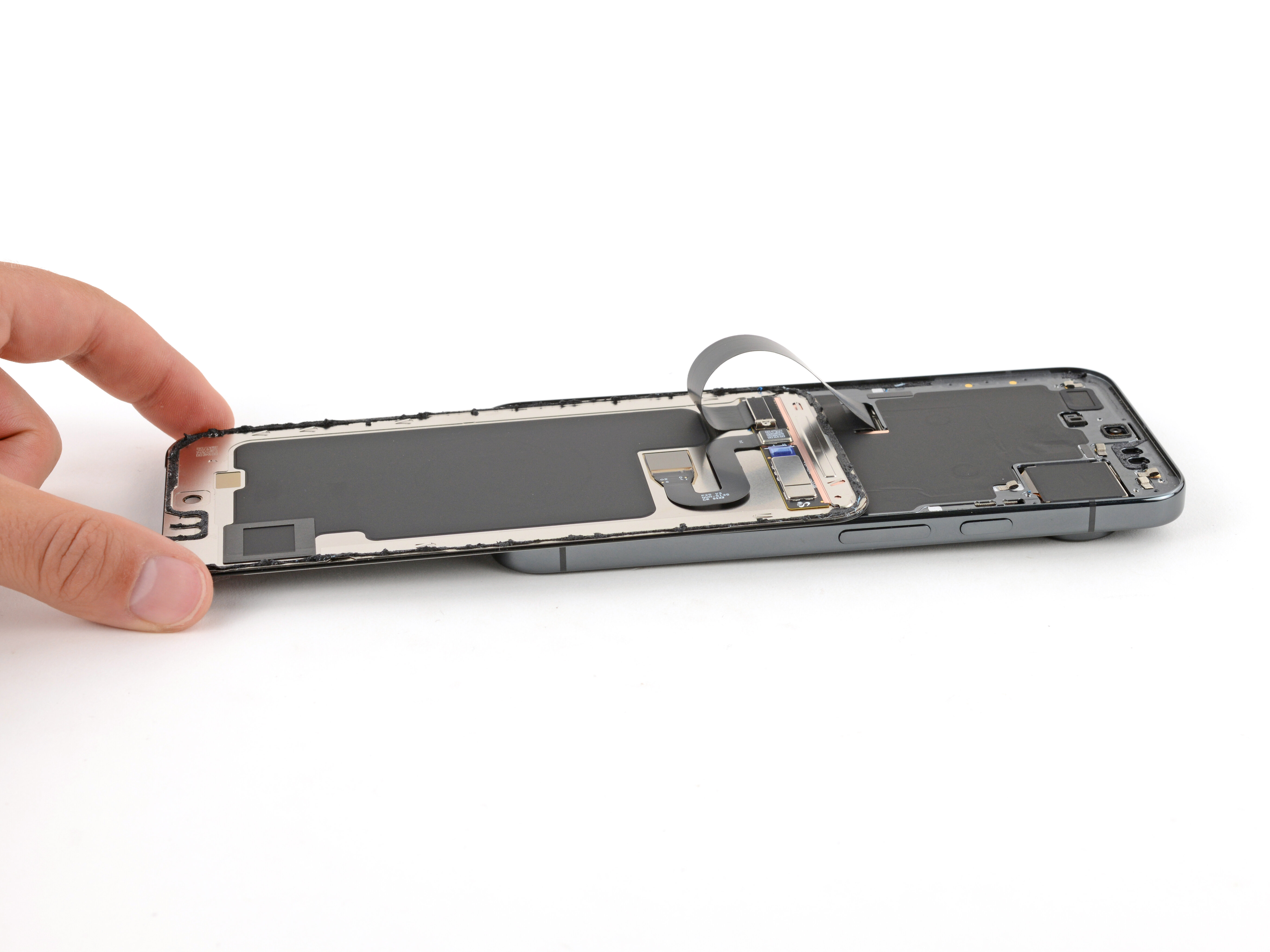

  8. Google Pixel 10 Pro XL Screen Replacement, Prop up the screen: 8 단계, 이미지 3개 중 1개 Google Pixel 10 Pro XL Screen Replacement, Prop up the screen: 8 단계, 이미지 3개 중 2개 Google Pixel 10 Pro XL Screen Replacement, Prop up the screen: 8 단계, 이미지 3개 중 3개
    • If the screen still feels stuck, go back around the perimeter with an opening pick and separate any remaining adhesive.
    • Flip the top edge of the screen over the bottom edge and use the suction handle to prop it up, so you have access to the screen cable connector.
    • Alternatively, you can lay the screen down flat over the bottom edge of your phone. But be careful not to strain the cable.
  9. Google Pixel 10 Pro XL Screen Replacement, Remove the screen cable bracket: 9 단계, 이미지 3개 중 1개 Google Pixel 10 Pro XL Screen Replacement, Remove the screen cable bracket: 9 단계, 이미지 3개 중 2개 Google Pixel 10 Pro XL Screen Replacement, Remove the screen cable bracket: 9 단계, 이미지 3개 중 3개
    • Use your finger to press down firmly on the screen cable bracket and slide it away from the phone to unclip and remove it.

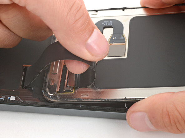

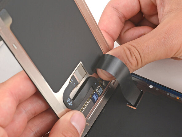

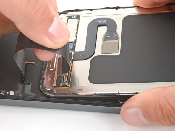

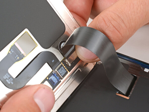

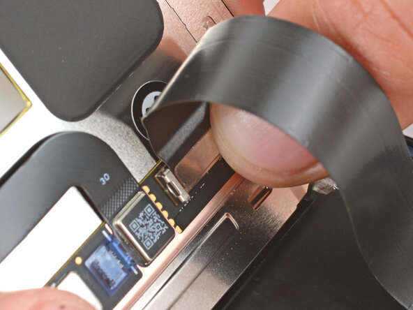

  11. Google Pixel 10 Pro XL Screen Replacement, Peel up the screen cable: 11 단계, 이미지 2개 중 1개 Google Pixel 10 Pro XL Screen Replacement, Peel up the screen cable: 11 단계, 이미지 2개 중 2개
    • Grip the screen cable just above its connector and gently peel it up.
    • If you're having trouble, use a hair dryer or heat gun to lightly heat the cable.

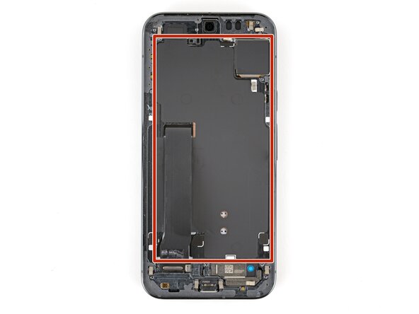

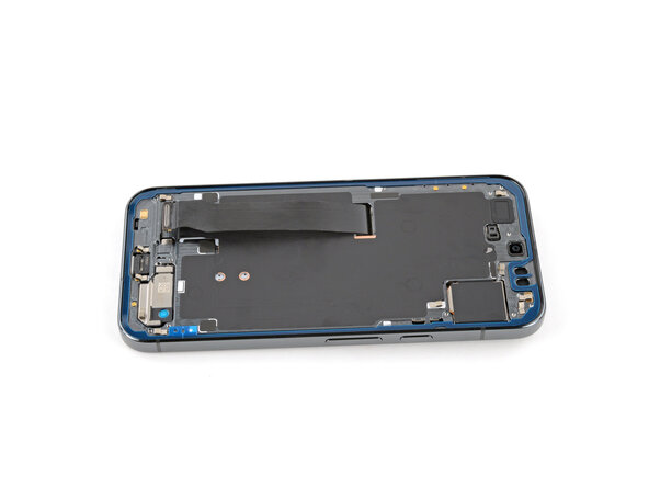

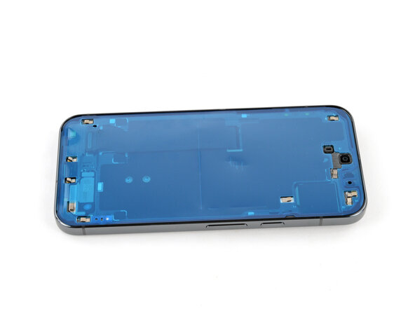

  14. Google Pixel 10 Pro XL Screen Replacement, Clean the frame: 14 단계, 이미지 3개 중 1개 Google Pixel 10 Pro XL Screen Replacement, Clean the frame: 14 단계, 이미지 3개 중 2개 Google Pixel 10 Pro XL Screen Replacement, Clean the frame: 14 단계, 이미지 3개 중 3개
    • Before installing adhesive, all the old adhesive must be completely removed from the frame.
    • Take your time during the next two steps. A clean frame allows replacement adhesive to lay totally flat, ensuring a better seal for your new screen.
    • The graphite sheet attached to the frame is very fragile. Be careful not to damage it when cleaning the frame.

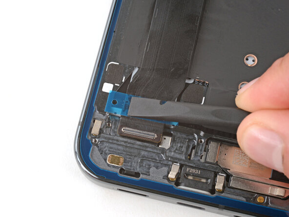

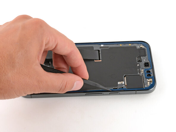

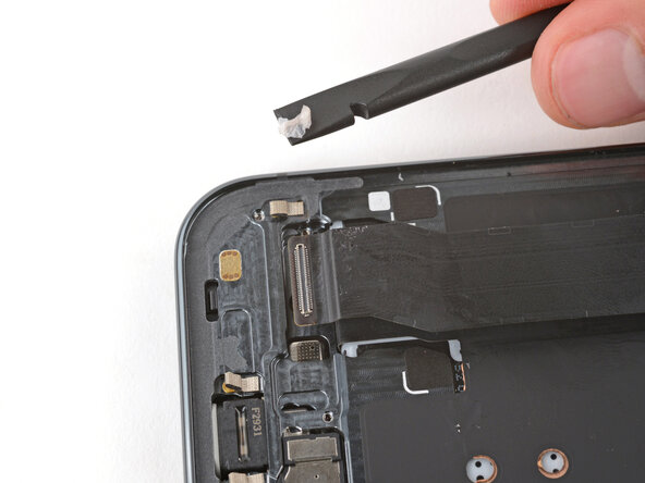

  15. Google Pixel 10 Pro XL Screen Replacement: 15 단계, 이미지 3개 중 1개 Google Pixel 10 Pro XL Screen Replacement: 15 단계, 이미지 3개 중 2개 Google Pixel 10 Pro XL Screen Replacement: 15 단계, 이미지 3개 중 3개

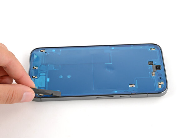

    • This step will take some time, as removing the adhesive can be very tricky.

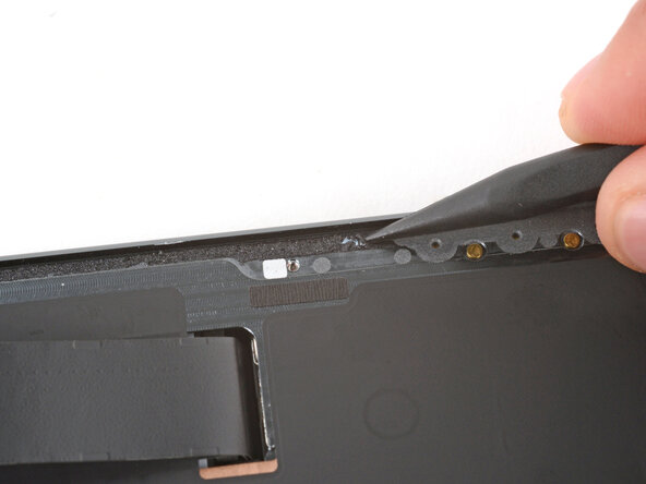

    • Use the point of a spudger to remove all the old screen adhesive from the frame. Try to "roll" the adhesive onto itself so it balls up, making it easier to remove.
    • If you can ball up a big enough chunk, use tweezers to slowly pull the adhesive the opposite way you were scraping with your spudger.

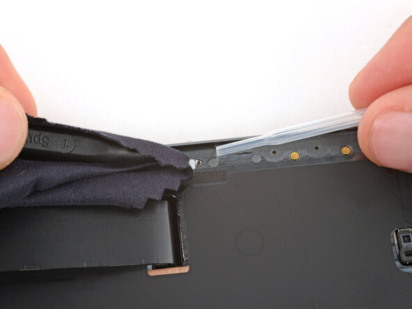

  16. Google Pixel 10 Pro XL Screen Replacement: 16 단계, 이미지 1개 중 1개
    • Wrap a microfiber or lint‑free cloth around a spudger.
    • Use the spudger and a drop of high‑concentration (>90%) isopropyl alcohol to clean up all the remaining adhesive residue from the frame, applying more drops of alcohol as necessary.
    • Let the alcohol dry completely before continuing.

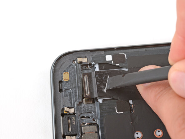

  17. Google Pixel 10 Pro XL Screen Replacement, Press the screen cable down: 17 단계, 이미지 2개 중 1개 Google Pixel 10 Pro XL Screen Replacement, Press the screen cable down: 17 단계, 이미지 2개 중 2개
    • The screen cable sticks up off the frame, making it difficult to apply new screen adhesive.
    • Use your fingers to push the screen cable down so it sits as flat to the frame as possible.

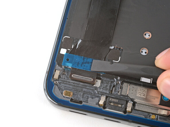

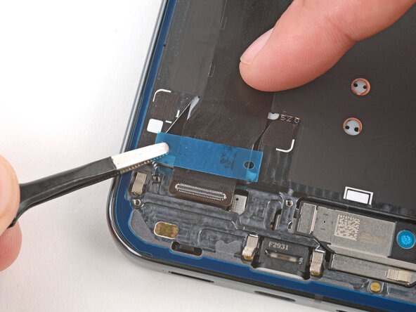

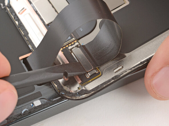

  18. Google Pixel 10 Pro XL Screen Replacement, Remove the screen cable adhesive: 18 단계, 이미지 3개 중 1개 Google Pixel 10 Pro XL Screen Replacement, Remove the screen cable adhesive: 18 단계, 이미지 3개 중 2개 Google Pixel 10 Pro XL Screen Replacement, Remove the screen cable adhesive: 18 단계, 이미지 3개 중 3개
    • If you don't have replacement screen cable adhesive, you can reuse the adhesive and skip this step.
    • Hold the screen cable down with one hand, and with your free hand use a spudger to gently scrape up and remove the piece of adhesive on the screen cable, near the connector.
    • Be very careful not to damage the cable or its connector. Otherwise, your screen may not work.

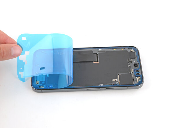

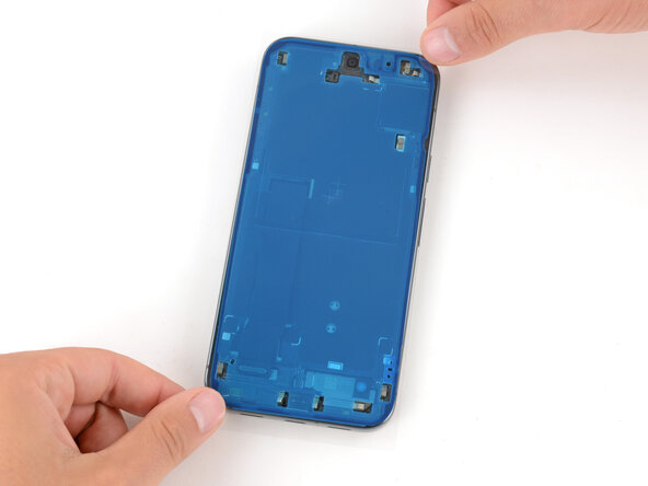

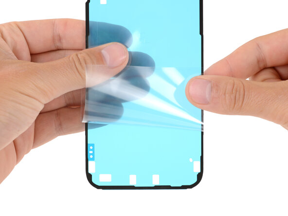

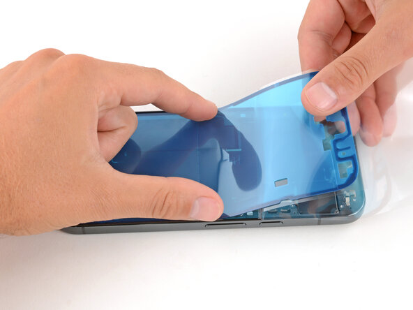

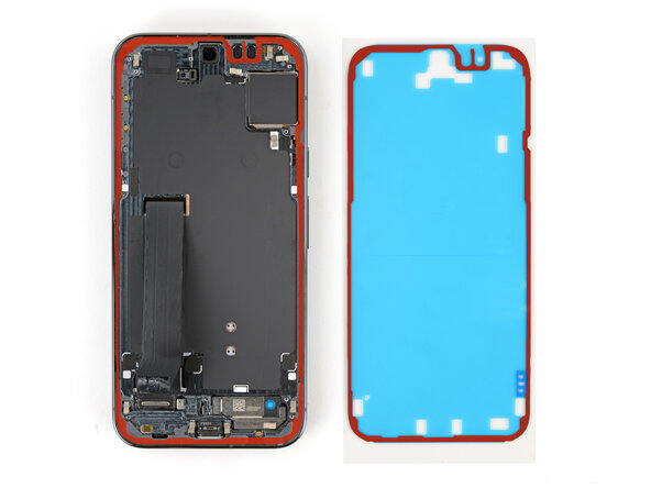

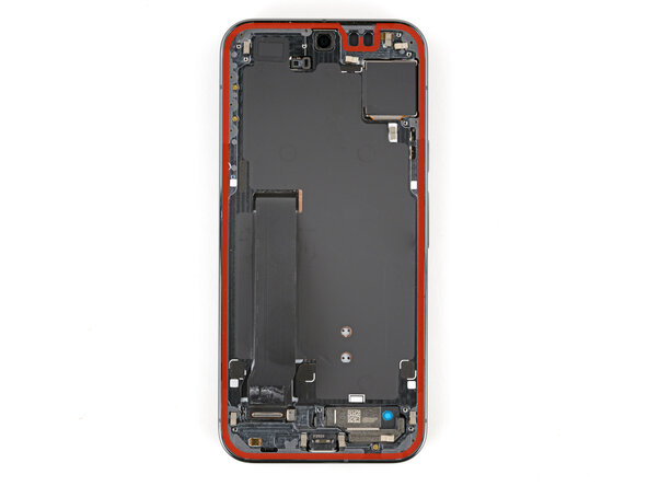

  19. Google Pixel 10 Pro XL Screen Replacement, Orient the adhesive: 19 단계, 이미지 3개 중 1개 Google Pixel 10 Pro XL Screen Replacement, Orient the adhesive: 19 단계, 이미지 3개 중 2개 Google Pixel 10 Pro XL Screen Replacement, Orient the adhesive: 19 단계, 이미지 3개 중 3개
    • Before applying any adhesive, check if your replacement screen comes with adhesive pre‑installed around its perimeter. If it does, skip down seven steps. If it doesn't, follow the next nine steps to install new screen adhesive on the frame.
    • Before applying the screen adhesive, make sure you know how it will sit on the frame. If you apply the adhesive incorrectly, you'll need to restart with new adhesive.
    • Hold the adhesive above the frame to find its orientation. Use cutouts in the liner and the contours of the adhesive to help visualize how it will lay in the frame.
  20. Google Pixel 10 Pro XL Screen Replacement, Apply the adhesive: 20 단계, 이미지 1개 중 1개
    • Peel up the bottom half of the larger, clear liner to expose the adhesive—don't fully remove the liner yet.

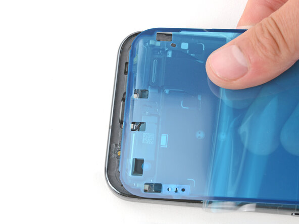

  21. Google Pixel 10 Pro XL Screen Replacement: 21 단계, 이미지 3개 중 1개 Google Pixel 10 Pro XL Screen Replacement: 21 단계, 이미지 3개 중 2개 Google Pixel 10 Pro XL Screen Replacement: 21 단계, 이미지 3개 중 3개
    • Take your time aligning the adhesive with the frame—it's very sticky and can't be moved after you apply it.
    • With the larger, clear liner folded towards the top of the phone, lay the exposed bottom edge of the adhesive onto the frame.
    • Use the lip of the frame to help align the adhesive.
    • Once the top edge is properly aligned, gently press down on the top corners to secure the adhesive.

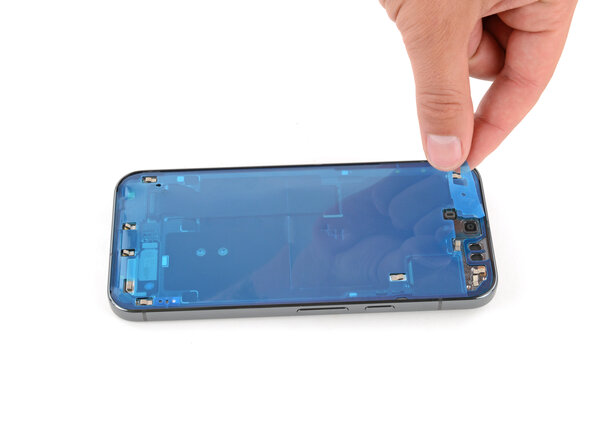

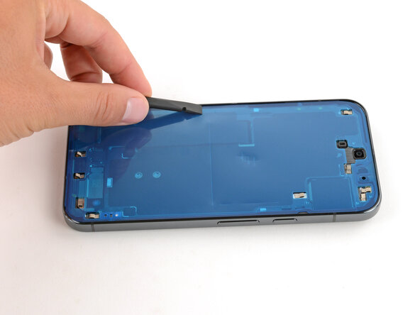

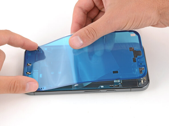

  22. Google Pixel 10 Pro XL Screen Replacement: 22 단계, 이미지 3개 중 1개 Google Pixel 10 Pro XL Screen Replacement: 22 단계, 이미지 3개 중 2개 Google Pixel 10 Pro XL Screen Replacement: 22 단계, 이미지 3개 중 3개
    • Slowly lay the rest of the adhesive onto the frame, pressing it into place and peeling away the larger, clear liner as you go.
  23. Google Pixel 10 Pro XL Screen Replacement, Secure the adhesive: 23 단계, 이미지 2개 중 1개 Google Pixel 10 Pro XL Screen Replacement, Secure the adhesive: 23 단계, 이미지 2개 중 2개
    • Use a spudger to press down firmly on the screen adhesive to secure it to the frame.

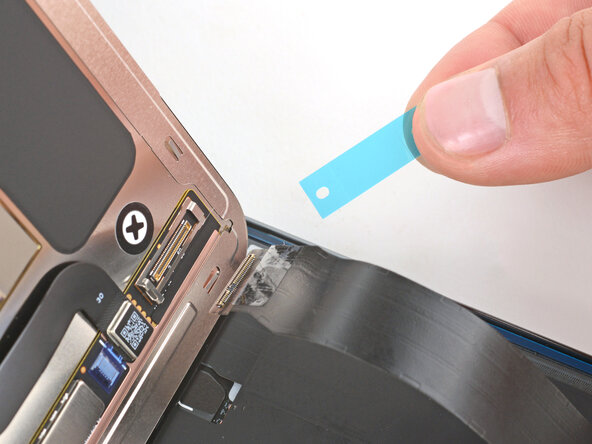

  26. Google Pixel 10 Pro XL Screen Replacement, Apply new screen cable adhesive: 26 단계, 이미지 3개 중 1개 Google Pixel 10 Pro XL Screen Replacement, Apply new screen cable adhesive: 26 단계, 이미지 3개 중 2개 Google Pixel 10 Pro XL Screen Replacement, Apply new screen cable adhesive: 26 단계, 이미지 3개 중 3개
    • If you're reusing the screen cable adhesive, skip this step.
    • Remove the larger, clear liner from the screen cable adhesive.
    • Place the adhesive onto the screen cable (just above the connector) and use the flat end of a spudger to press the adhesive into place.
    • Leave the remaining liner attached for now.

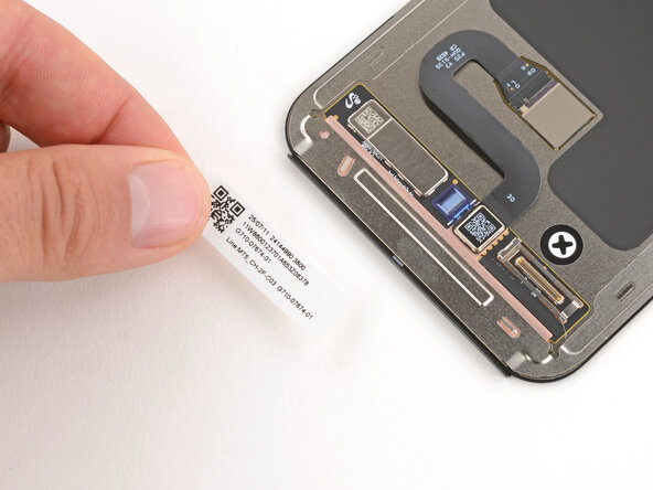

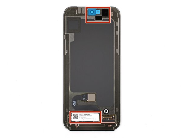

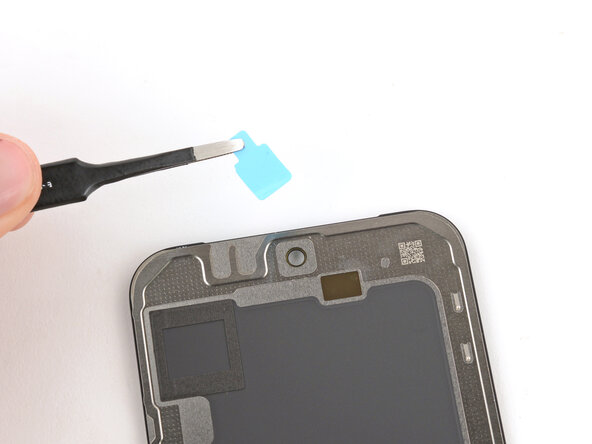

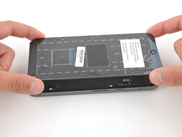

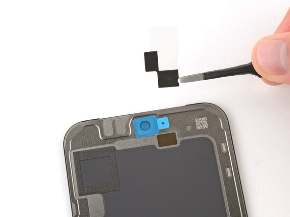

  27. Google Pixel 10 Pro XL Screen Replacement, Check for plastic liners on the screen: 27 단계, 이미지 2개 중 1개 Google Pixel 10 Pro XL Screen Replacement, Check for plastic liners on the screen: 27 단계, 이미지 2개 중 2개
    • Your replacement screen has various protective liners and pieces of tape on the underside that must be removed before installation. Your screen may have different pieces in different locations, so make sure to check carefully!
    • Check around the front facing camera cutout and near the bottom edge of the screen for liners or tape.
    • Usually, you can identify the liners by their pull tabs.

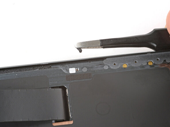

  28. Google Pixel 10 Pro XL Screen Replacement, Remove screen liners: 28 단계, 이미지 3개 중 1개 Google Pixel 10 Pro XL Screen Replacement, Remove screen liners: 28 단계, 이미지 3개 중 2개 Google Pixel 10 Pro XL Screen Replacement, Remove screen liners: 28 단계, 이미지 3개 중 3개
    • The exposed back of the screen is very fragile—even a small scratch can cause damage. Be very careful not to damage the screen during the remaining steps.
    • Use your fingers or tweezers to remove the plastic liners and tape near the front camera cutout and bottom of the screen.

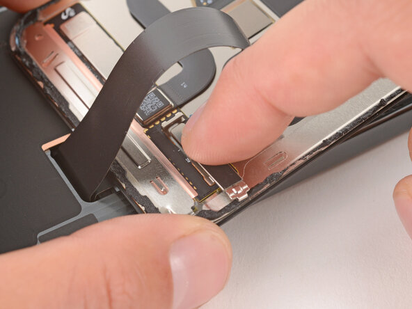

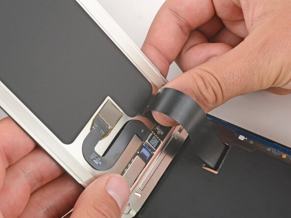

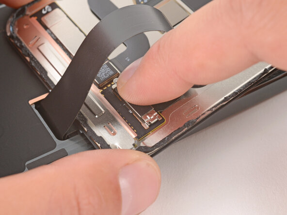

  31. Google Pixel 10 Pro XL Screen Replacement, Connect the screen: 31 단계, 이미지 3개 중 1개 Google Pixel 10 Pro XL Screen Replacement, Connect the screen: 31 단계, 이미지 3개 중 2개 Google Pixel 10 Pro XL Screen Replacement, Connect the screen: 31 단계, 이미지 3개 중 3개
    • Loop the screen cable around and use your fingers to reconnect the press connector, pressing on one side first and then the other.

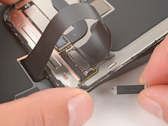

  32. Google Pixel 10 Pro XL Screen Replacement, Install the bracket: 32 단계, 이미지 3개 중 1개 Google Pixel 10 Pro XL Screen Replacement, Install the bracket: 32 단계, 이미지 3개 중 2개 Google Pixel 10 Pro XL Screen Replacement, Install the bracket: 32 단계, 이미지 3개 중 3개
    • Insert the small arm of the screen cable bracket into its slot next to the connector.
    • Press down on the bracket and slide it into place until it clicks, making sure the outer edge hooks into place.

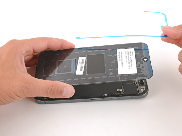

  34. Google Pixel 10 Pro XL Screen Replacement, Remove the remaining liners: 34 단계, 이미지 3개 중 1개 Google Pixel 10 Pro XL Screen Replacement, Remove the remaining liners: 34 단계, 이미지 3개 중 2개 Google Pixel 10 Pro XL Screen Replacement, Remove the remaining liners: 34 단계, 이미지 3개 중 3개
    • Flip the screen down and hold it above the frame.
    • Remove all remaining liners from the adhesive (either on the frame, or from the underside of the screen).

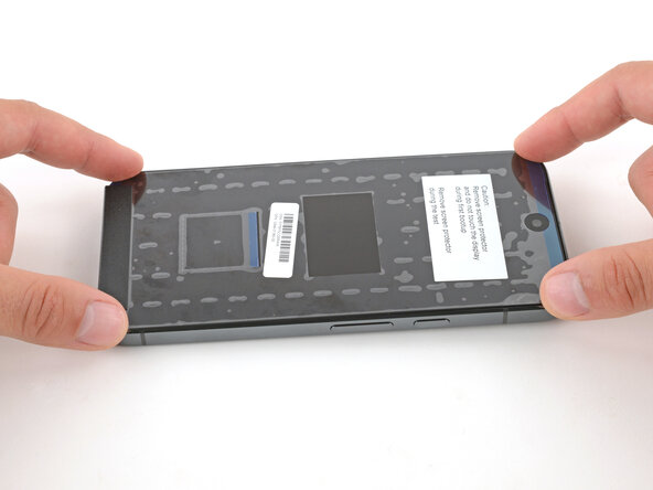

  36. Google Pixel 10 Pro XL Screen Replacement: 36 단계, 이미지 3개 중 1개 Google Pixel 10 Pro XL Screen Replacement: 36 단계, 이미지 3개 중 2개 Google Pixel 10 Pro XL Screen Replacement: 36 단계, 이미지 3개 중 3개
    • Hold your phone up and squeeze firmly around the perimeter to strengthen the adhesive bond.
    • For an even stronger bond, you can stack books on the back glass or use screen vise clamps.
    • Before powering on your Pixel for the first time, lay the phone screen-side up on a clean, flat surface. Remove the plastic liner from the screen, making sure nothing touches the phone while you do so (fingers, screen protectors, or cases).
    • Follow any other specific instructions that may be on the screen's adhesive liner.
