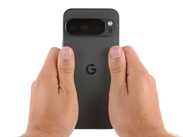

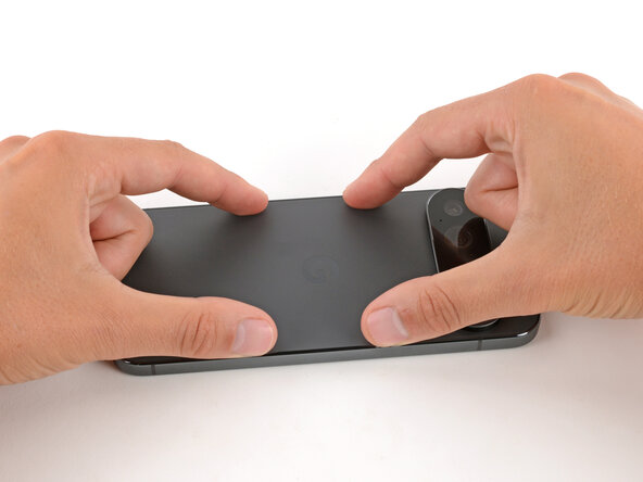

  3. Google Pixel 10 Pro XL USB‑C Board Replacement, Heat the bottom edge: 3 단계, 이미지 1개 중 1개
    • Adhesive secures the back glass to the frame. Heating the glass softens the adhesive, making it easier to separate.
    • Heat an iOpener and lay it on the bottom edge of the back glass for two minutes.
    • Alternatively, you can use a hair dryer or heat gun to heat the back glass.

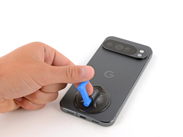

  4. Google Pixel 10 Pro XL USB‑C Board Replacement, Apply a suction handle: 4 단계, 이미지 2개 중 1개 Google Pixel 10 Pro XL USB‑C Board Replacement, Apply a suction handle: 4 단계, 이미지 2개 중 2개
    • Apply a suction handle to the center of the back glass's bottom edge, as close to the edge as possible.

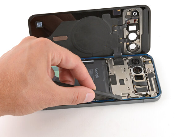

  5. Google Pixel 10 Pro XL USB‑C Board Replacement, Insert an opening pick: 5 단계, 이미지 3개 중 1개 Google Pixel 10 Pro XL USB‑C Board Replacement, Insert an opening pick: 5 단계, 이미지 3개 중 2개 Google Pixel 10 Pro XL USB‑C Board Replacement, Insert an opening pick: 5 단계, 이미지 3개 중 3개
    • Pull up on the suction handle with strong, steady force until a gap forms between the back glass and frame.
    • Insert the tip of an opening pick into the gap.

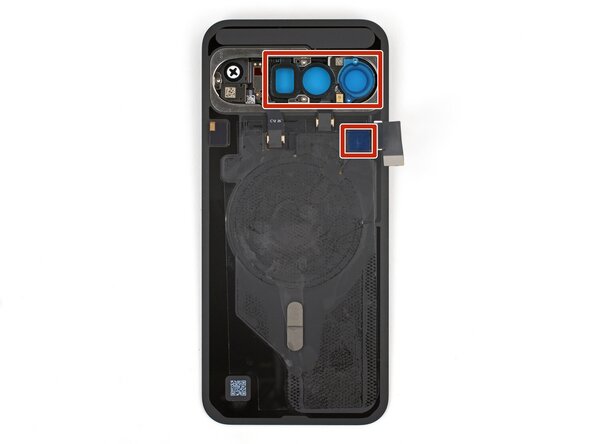

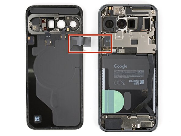

  6. Google Pixel 10 Pro XL USB‑C Board Replacement, Back glass adhesive information: 6 단계, 이미지 3개 중 1개 Google Pixel 10 Pro XL USB‑C Board Replacement, Back glass adhesive information: 6 단계, 이미지 3개 중 2개 Google Pixel 10 Pro XL USB‑C Board Replacement, Back glass adhesive information: 6 단계, 이미지 3개 중 3개
    • The back glass is secured with adhesive around the perimeter of the frame. Use this picture as a reference while you separate the adhesive.
    • A cable connects the back glass near the power button. Don't insert your pick here to avoid damaging the cable.

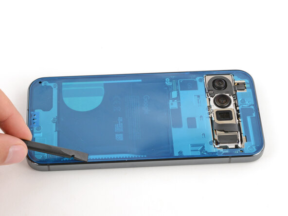

  10. Google Pixel 10 Pro XL USB‑C Board Replacement, Separate the top edge adhesive: 10 단계, 이미지 3개 중 1개 Google Pixel 10 Pro XL USB‑C Board Replacement, Separate the top edge adhesive: 10 단계, 이미지 3개 중 2개 Google Pixel 10 Pro XL USB‑C Board Replacement, Separate the top edge adhesive: 10 단계, 이미지 3개 중 3개
    • Insert a fourth pick under the top right corner.
    • Slide the pick along the top edge and slightly around the top left corner, stopping at the bottom of the camera bump.

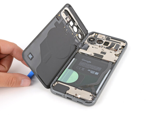

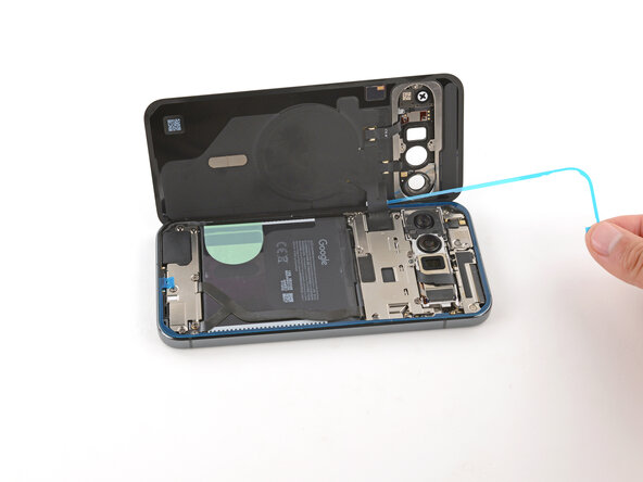

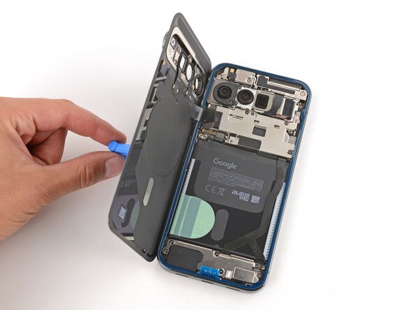

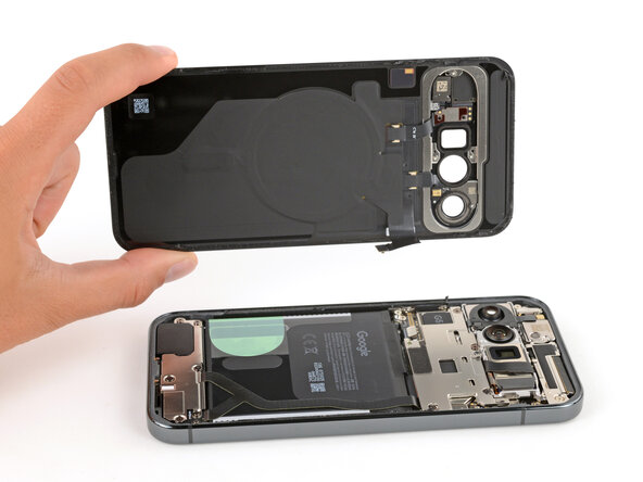

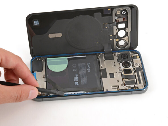

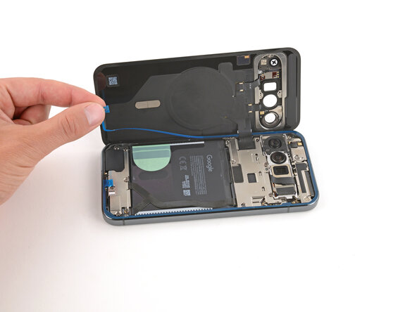

  11. Google Pixel 10 Pro XL USB‑C Board Replacement, Prop up the back glass: 11 단계, 이미지 3개 중 1개 Google Pixel 10 Pro XL USB‑C Board Replacement, Prop up the back glass: 11 단계, 이미지 3개 중 2개 Google Pixel 10 Pro XL USB‑C Board Replacement, Prop up the back glass: 11 단계, 이미지 3개 중 3개
    • Flip the back glass over the left side of the phone and use the suction handle (or a sturdy object) to prop it up.
    • If the back glass still feels stuck, go back around the perimeter with an opening pick and separate any remaining adhesive.

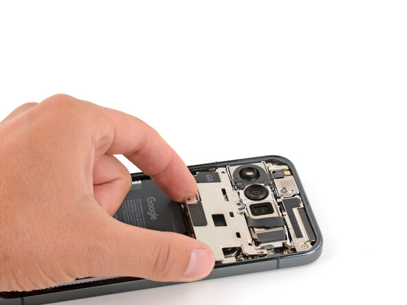

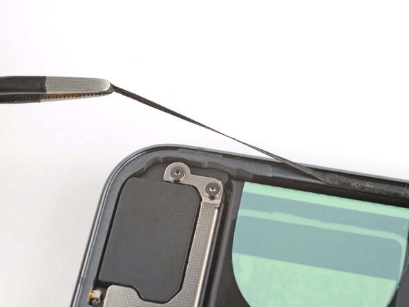

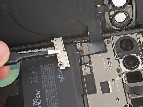

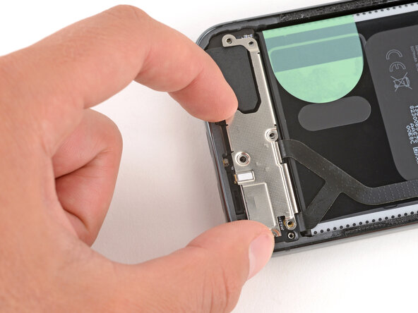

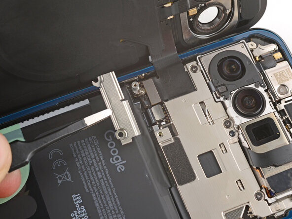

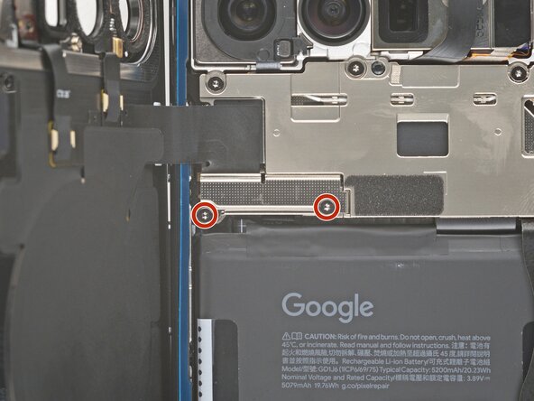

  12. Google Pixel 10 Pro XL USB‑C Board Replacement, Remove the bracket screws: 12 단계, 이미지 2개 중 1개 Google Pixel 10 Pro XL USB‑C Board Replacement, Remove the bracket screws: 12 단계, 이미지 2개 중 2개
    • Use a Torx Plus 3IP screwdriver to remove the two 2.3 mm‑long screws securing the back glass connector bracket.

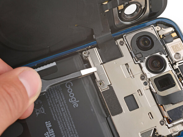

  13. Google Pixel 10 Pro XL USB‑C Board Replacement: 13 단계, 이미지 2개 중 1개 Google Pixel 10 Pro XL USB‑C Board Replacement: 13 단계, 이미지 2개 중 2개
    • Use tweezers or your fingers to remove the bracket.
    • Be careful not to scratch or smudge the rear cameras.

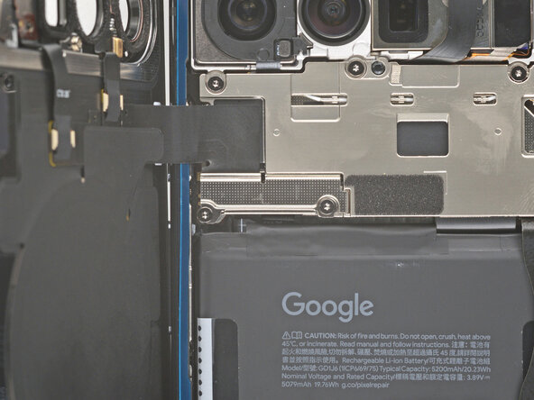

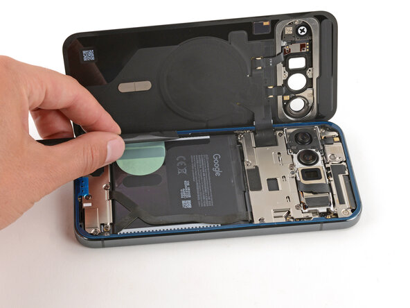

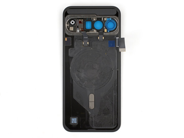

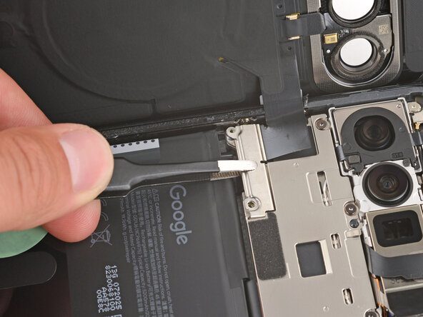

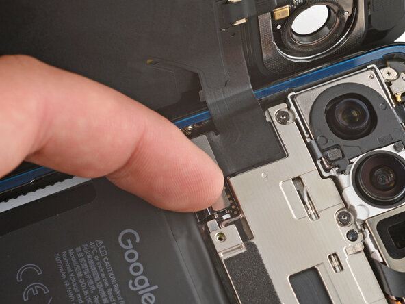

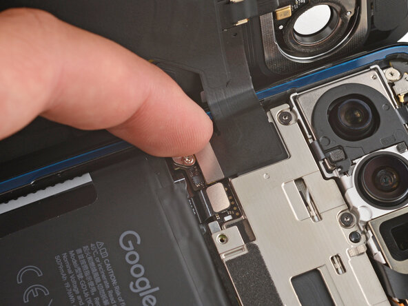

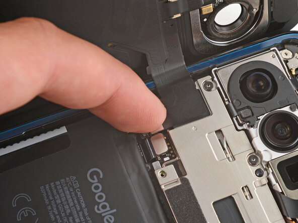

  14. Google Pixel 10 Pro XL USB‑C Board Replacement, Disconnect the back glass: 14 단계, 이미지 3개 중 1개 Google Pixel 10 Pro XL USB‑C Board Replacement, Disconnect the back glass: 14 단계, 이미지 3개 중 2개 Google Pixel 10 Pro XL USB‑C Board Replacement, Disconnect the back glass: 14 단계, 이미지 3개 중 3개
    • Use the point of a spudger to pry up and disconnect the battery and back glass press connectors.

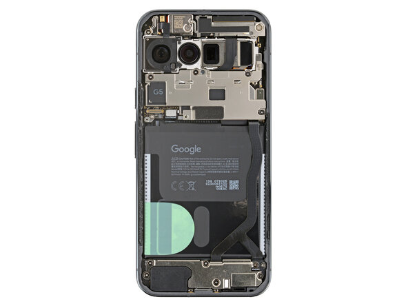

  15. Google Pixel 10 Pro XL USB‑C Board Replacement, Remove the back glass: 15 단계, 이미지 1개 중 1개
    • Remove the back glass.

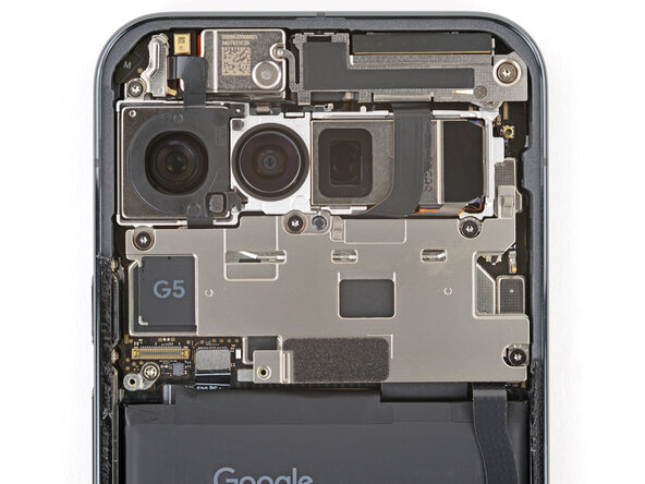

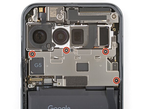

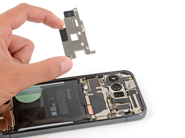

  16. Google Pixel 10 Pro XL USB‑C Board Replacement, Remove the motherboard cover screws: 16 단계, 이미지 2개 중 1개 Google Pixel 10 Pro XL USB‑C Board Replacement, Remove the motherboard cover screws: 16 단계, 이미지 2개 중 2개
    • Use a Torx Plus 3IP screwdriver to remove the four 5.0 mm‑long screws securing the motherboard cover.
  17. Google Pixel 10 Pro XL USB‑C Board Replacement, Remove the motherboard cover: 17 단계, 이미지 2개 중 1개 Google Pixel 10 Pro XL USB‑C Board Replacement, Remove the motherboard cover: 17 단계, 이미지 2개 중 2개
    • Remove the motherboard cover.

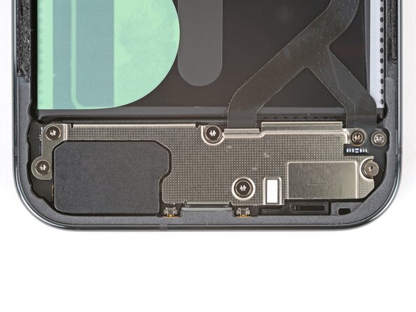

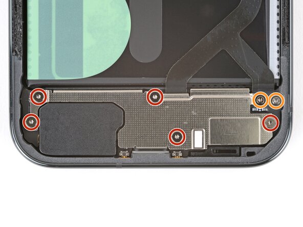

  18. Google Pixel 10 Pro XL USB‑C Board Replacement, Remove the USB‑C board cover screws: 18 단계, 이미지 2개 중 1개 Google Pixel 10 Pro XL USB‑C Board Replacement, Remove the USB‑C board cover screws: 18 단계, 이미지 2개 중 2개
    • Use a Torx Plus 3IP screwdriver to remove the seven screws:
    • Five 5.0 mm‑long screws
    • Two 4.1 mm‑long screws
  19. Google Pixel 10 Pro XL USB‑C Board Replacement, Remove the USB‑C board cover: 19 단계, 이미지 2개 중 1개 Google Pixel 10 Pro XL USB‑C Board Replacement, Remove the USB‑C board cover: 19 단계, 이미지 2개 중 2개
    • Remove the USB‑C board cover.

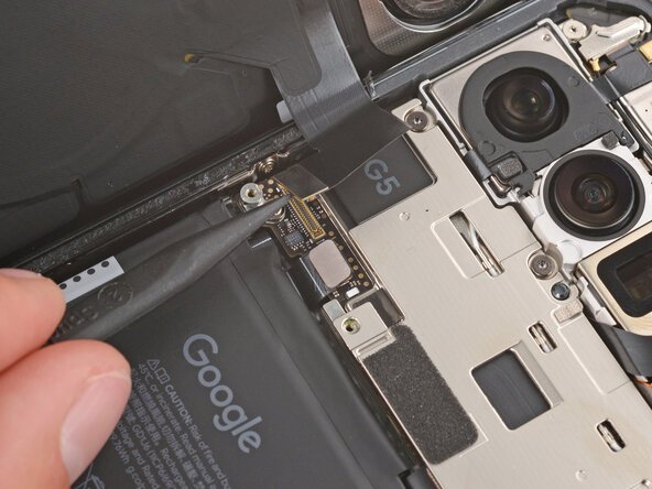

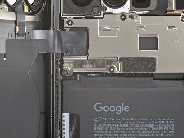

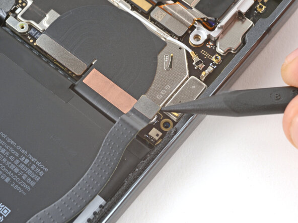

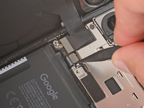

  20. Google Pixel 10 Pro XL USB‑C Board Replacement: 20 단계, 이미지 3개 중 1개 Google Pixel 10 Pro XL USB‑C Board Replacement: 20 단계, 이미지 3개 중 2개 Google Pixel 10 Pro XL USB‑C Board Replacement: 20 단계, 이미지 3개 중 3개
    • Use a spudger to pry up and disconnect both interconnect cable press connectors—one on the USB‑C board and one on the motherboard.

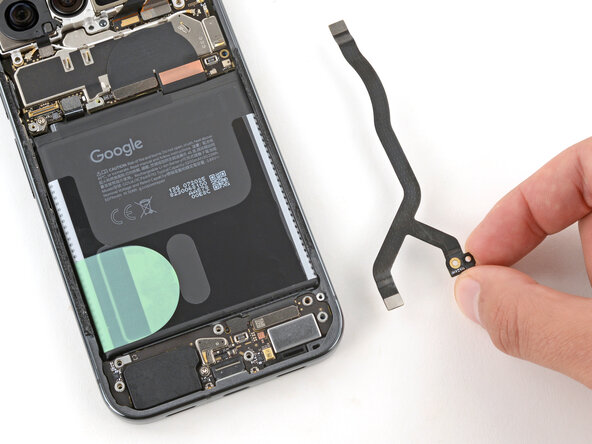

  21. Google Pixel 10 Pro XL USB‑C Board Replacement, Remove the interconnect cable: 21 단계, 이미지 2개 중 1개 Google Pixel 10 Pro XL USB‑C Board Replacement, Remove the interconnect cable: 21 단계, 이미지 2개 중 2개
    • Remove the interconnect cable.

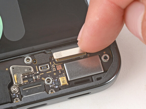

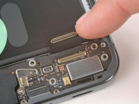

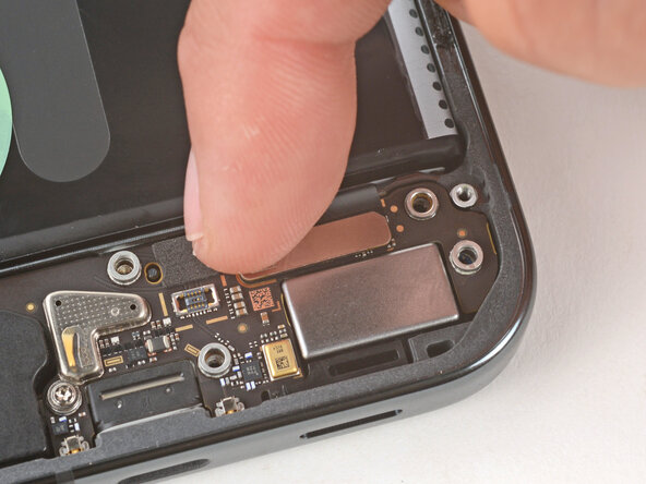

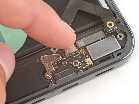

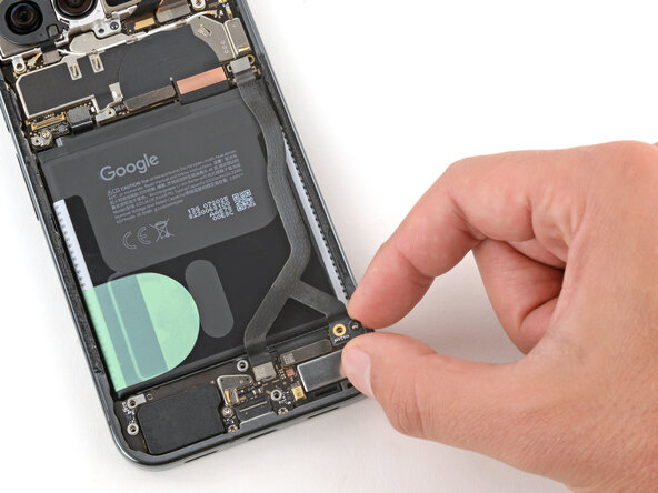

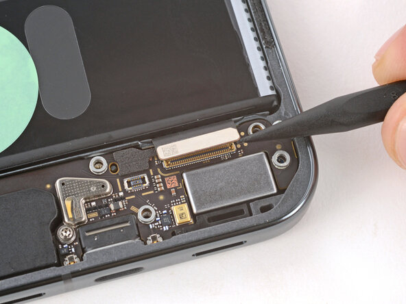

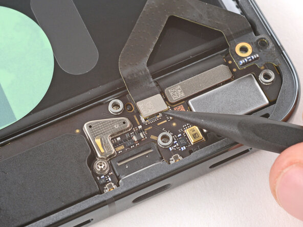

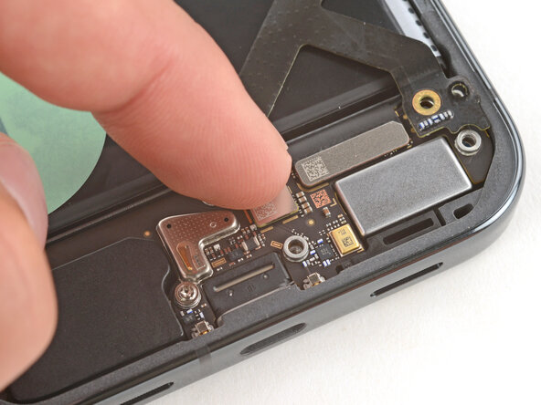

  22. Google Pixel 10 Pro XL USB‑C Board Replacement, Disconnect the USB‑C board: 22 단계, 이미지 2개 중 1개 Google Pixel 10 Pro XL USB‑C Board Replacement, Disconnect the USB‑C board: 22 단계, 이미지 2개 중 2개
    • Use a spudger to pry up and disconnect the press connector on the top edge of the USB‑C board.

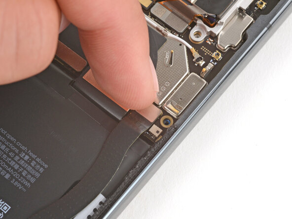

  23. Google Pixel 10 Pro XL USB‑C Board Replacement, Reposition the cable: 23 단계, 이미지 2개 중 1개 Google Pixel 10 Pro XL USB‑C Board Replacement, Reposition the cable: 23 단계, 이미지 2개 중 2개
    • Use your finger to gently lift the cable, so it's out of the way of the board.
    • Be careful not to crease or tear the cable.

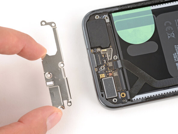

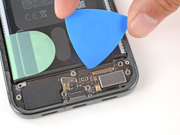

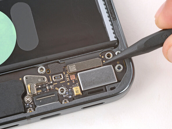

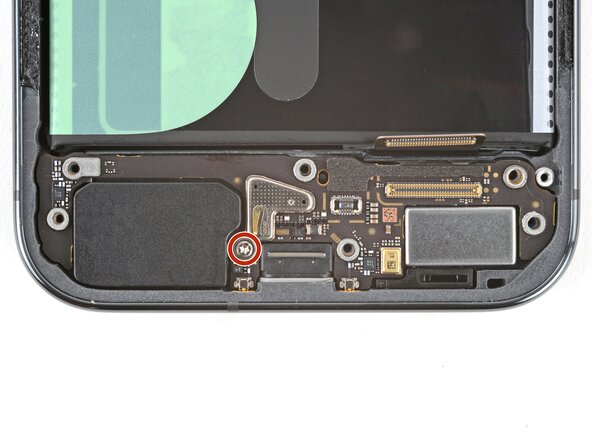

  24. Google Pixel 10 Pro XL USB‑C Board Replacement, Remove the USB‑C board screw: 24 단계, 이미지 2개 중 1개 Google Pixel 10 Pro XL USB‑C Board Replacement, Remove the USB‑C board screw: 24 단계, 이미지 2개 중 2개
    • Use a Torx Plus 3IP screwdriver to remove the 4.1 mm‑long screw securing the USB‑C board.

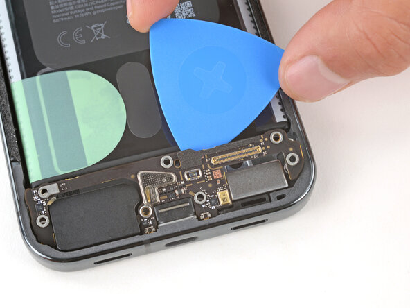

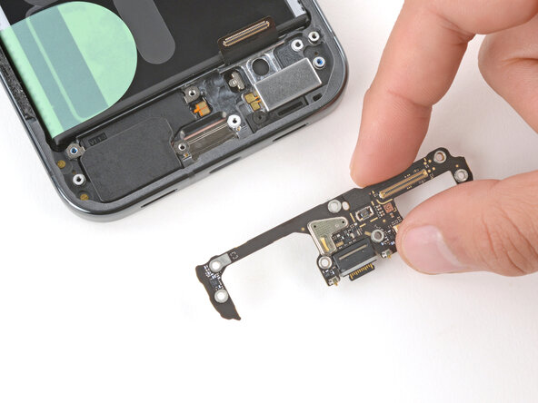

  25. Google Pixel 10 Pro XL USB‑C Board Replacement, Remove the USB‑C board: 25 단계, 이미지 3개 중 1개 Google Pixel 10 Pro XL USB‑C Board Replacement, Remove the USB‑C board: 25 단계, 이미지 3개 중 2개 Google Pixel 10 Pro XL USB‑C Board Replacement, Remove the USB‑C board: 25 단계, 이미지 3개 중 3개
    • Be careful not to damage the battery during this step—don't pry against the battery.
    • Insert the tip of an opening pick under the center of the USB‑C board's top edge, so it's between the board and the metal lip on the frame.
    • Slide the pick to the left and gently pry up to unclip the board.
    • Remove the USB‑C board.

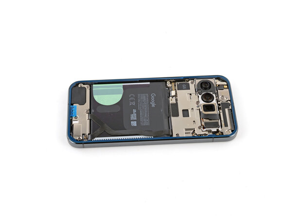

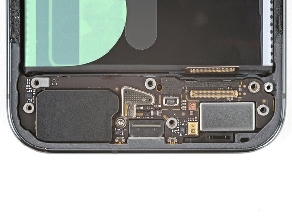

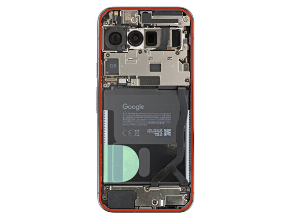

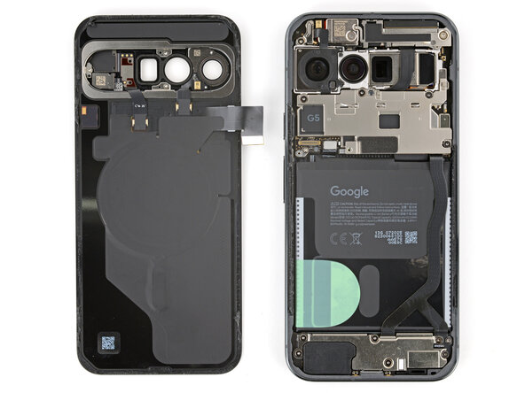

  26. Google Pixel 10 Pro XL USB‑C Board Replacement, Disassembly complete: 26 단계, 이미지 1개 중 1개
    • Congratulations on completing disassembly! The remaining steps will show how to reassemble your phone.

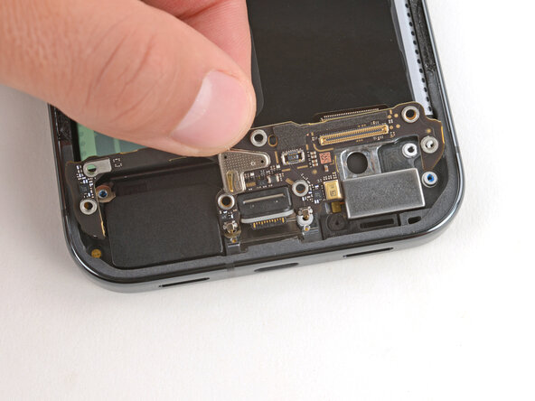

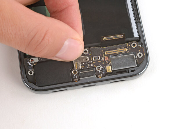

  27. Google Pixel 10 Pro XL USB‑C Board Replacement, Install the USB‑C board: 27 단계, 이미지 3개 중 1개 Google Pixel 10 Pro XL USB‑C Board Replacement, Install the USB‑C board: 27 단계, 이미지 3개 중 2개 Google Pixel 10 Pro XL USB‑C Board Replacement, Install the USB‑C board: 27 단계, 이미지 3개 중 3개
    • Insert the USB‑C board at a slight downward angle, guiding the port into its recess.
    • With the board in place, press down firmly on the center of the top edge to clip the board in place.
  28. Google Pixel 10 Pro XL USB‑C Board Replacement, Connect the USB‑C board: 28 단계, 이미지 3개 중 1개 Google Pixel 10 Pro XL USB‑C Board Replacement, Connect the USB‑C board: 28 단계, 이미지 3개 중 2개 Google Pixel 10 Pro XL USB‑C Board Replacement, Connect the USB‑C board: 28 단계, 이미지 3개 중 3개
    • Use your finger to reconnect the USB‑C board press connector, pressing down on one of the short sides first until it clicks into place, then pressing on the other side.

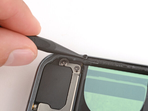

  36. Google Pixel 10 Pro XL USB‑C Board Replacement, Remove the old back glass adhesive: 36 단계, 이미지 2개 중 1개 Google Pixel 10 Pro XL USB‑C Board Replacement, Remove the old back glass adhesive: 36 단계, 이미지 2개 중 2개
    • Before installing new adhesive, all the old adhesive and its residue must be completely removed from the frame.
    • Take your time during the next two steps. A clean frame allows replacement adhesive to lay totally flat, ensuring a better seal for your back glass.
  37. Google Pixel 10 Pro XL USB‑C Board Replacement: 37 단계, 이미지 3개 중 1개 Google Pixel 10 Pro XL USB‑C Board Replacement: 37 단계, 이미지 3개 중 2개 Google Pixel 10 Pro XL USB‑C Board Replacement: 37 단계, 이미지 3개 중 3개
    • Removing all the old adhesive can be very tricky and time‑consuming.
    • Use the point of a spudger to remove all the old screen adhesive from the frame. Try to "roll" the adhesive onto itself so it balls up, making it easier to remove.
    • If you can ball up a big enough chunk, use tweezers to slowly pull the adhesive the opposite way you were scraping with your spudger.
    • If you're having trouble removing smaller chunks, apply a single drop of high‑concentration (>90%) isopropyl alcohol and scrape them up with your spudger.

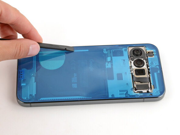

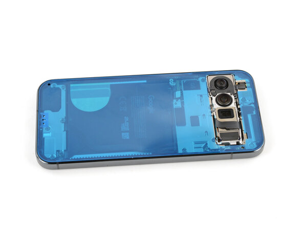

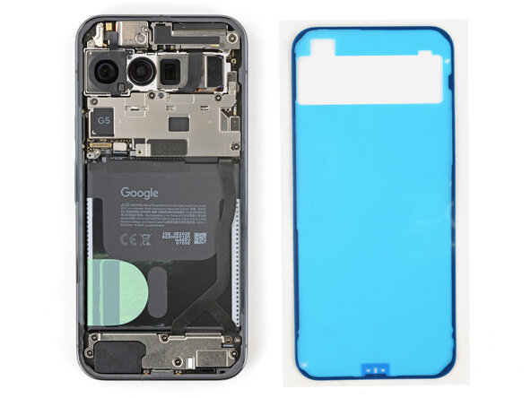

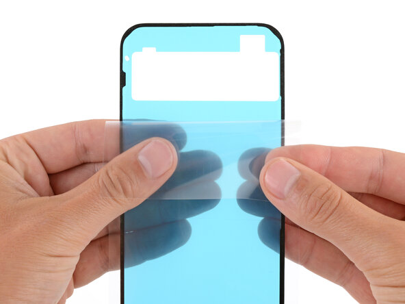

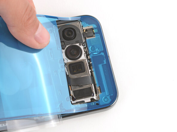

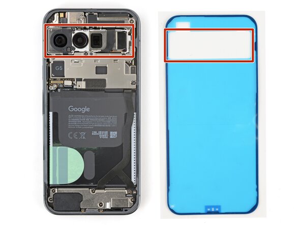

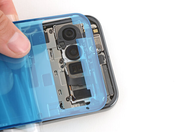

  40. Google Pixel 10 Pro XL USB‑C Board Replacement, Orient the adhesive: 40 단계, 이미지 2개 중 1개 Google Pixel 10 Pro XL USB‑C Board Replacement, Orient the adhesive: 40 단계, 이미지 2개 중 2개
    • Before applying the back glass adhesive, make sure you know how it will sit on the frame. If you apply the adhesive incorrectly, you'll need to restart with new adhesive.
    • Hold the adhesive above the frame to find its orientation. Use the rear camera cutout in the liner to help visualize how it will lay in the frame.
  41. Google Pixel 10 Pro XL USB‑C Board Replacement: 41 단계, 이미지 1개 중 1개
    • Peel down the top half of the larger, clear liner to expose the adhesive—don't fully remove the liner yet.

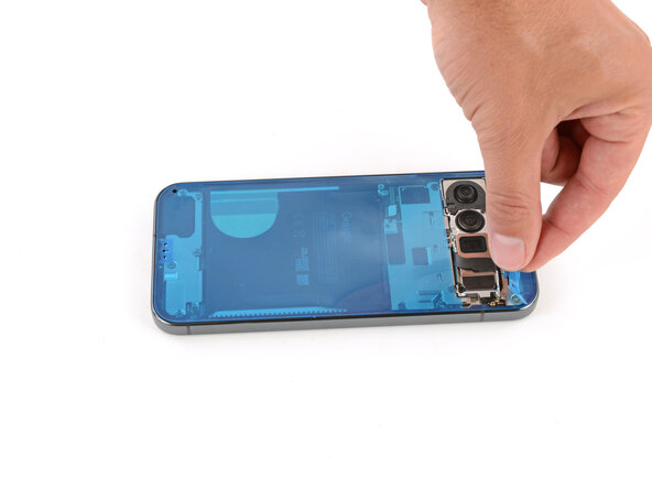

  42. Google Pixel 10 Pro XL USB‑C Board Replacement, Install the back glass adhesive: 42 단계, 이미지 3개 중 1개 Google Pixel 10 Pro XL USB‑C Board Replacement, Install the back glass adhesive: 42 단계, 이미지 3개 중 2개 Google Pixel 10 Pro XL USB‑C Board Replacement, Install the back glass adhesive: 42 단계, 이미지 3개 중 3개
    • Take your time aligning the adhesive with the frame—it's very sticky and can't be moved after you apply it.
    • With the larger, clear liner folded towards the bottom of the phone, lay the exposed top edge of the adhesive onto the frame.
    • Use the lip of the frame to help align the adhesive.
    • Once the top edge is properly aligned, gently press down on the top corners to secure the adhesive.

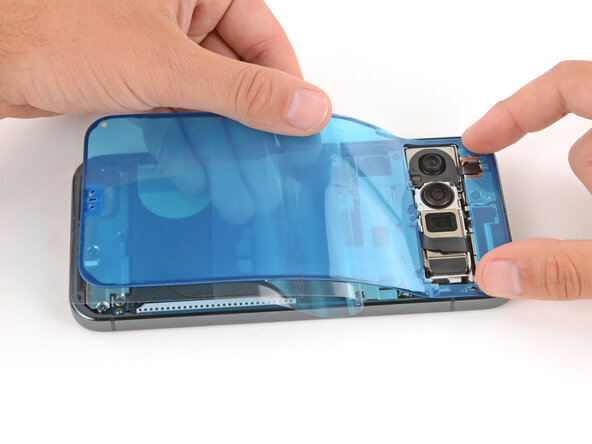

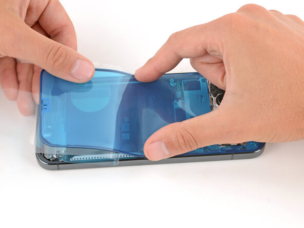

  43. Google Pixel 10 Pro XL USB‑C Board Replacement: 43 단계, 이미지 3개 중 1개 Google Pixel 10 Pro XL USB‑C Board Replacement: 43 단계, 이미지 3개 중 2개 Google Pixel 10 Pro XL USB‑C Board Replacement: 43 단계, 이미지 3개 중 3개
    • Slowly lay the rest of the adhesive onto the frame, pressing it into place and peeling away the larger, clear liner as you go.
  44. Google Pixel 10 Pro XL USB‑C Board Replacement: 44 단계, 이미지 3개 중 1개 Google Pixel 10 Pro XL USB‑C Board Replacement: 44 단계, 이미지 3개 중 2개 Google Pixel 10 Pro XL USB‑C Board Replacement: 44 단계, 이미지 3개 중 3개
    • Use a spudger to press down firmly on the adhesive to secure it to the frame.

  47. Google Pixel 10 Pro XL USB‑C Board Replacement, Prop up the back glass: 47 단계, 이미지 1개 중 1개
    • Apply a suction handle to the back glass and prop it up on the left side of your phone, so the cable is near its connector.
    • Alternatively, you can use a sturdy object (such as a stack of books) to prop up the back glass.
  48. Google Pixel 10 Pro XL USB‑C Board Replacement, Reconnect the back glass and battery: 48 단계, 이미지 3개 중 1개 Google Pixel 10 Pro XL USB‑C Board Replacement, Reconnect the back glass and battery: 48 단계, 이미지 3개 중 2개 Google Pixel 10 Pro XL USB‑C Board Replacement, Reconnect the back glass and battery: 48 단계, 이미지 3개 중 3개
    • Use your finger to press down and connect the back glass and battery press connectors.
    • For wider connectors like the back glass one, first press down on one of the short sides until it clicks into place, then repeat on the other side. Don't press down in the middle. If the connector is misaligned, the pins can bend and cause permanent damage.
  49. Google Pixel 10 Pro XL USB‑C Board Replacement: 49 단계, 이미지 2개 중 1개 Google Pixel 10 Pro XL USB‑C Board Replacement: 49 단계, 이미지 2개 중 2개

  51. Google Pixel 10 Pro XL USB‑C Board Replacement, Secure the adhesive: 51 단계, 이미지 3개 중 1개 Google Pixel 10 Pro XL USB‑C Board Replacement, Secure the adhesive: 51 단계, 이미지 3개 중 2개 Google Pixel 10 Pro XL USB‑C Board Replacement, Secure the adhesive: 51 단계, 이미지 3개 중 3개
    • This is a good point to power on your device and test all functions before sealing it up. If you have trouble, try some basic troubleshooting. Be sure to power back down completely before you continue working.
  52. Google Pixel 10 Pro XL USB‑C Board Replacement, Remove the remaining liners: 52 단계, 이미지 3개 중 1개 Google Pixel 10 Pro XL USB‑C Board Replacement, Remove the remaining liners: 52 단계, 이미지 3개 중 2개 Google Pixel 10 Pro XL USB‑C Board Replacement, Remove the remaining liners: 52 단계, 이미지 3개 중 3개
    • Remove the remaining liners from the back glass adhesive.
    • If the adhesive starts to peel up with the liner, check that you’ve pushed all of it into place with your spudger. If it continues to peel up, hold it down with the point of your spudger as you go.
  53. Google Pixel 10 Pro XL USB‑C Board Replacement, Install the back glass: 53 단계, 이미지 3개 중 1개 Google Pixel 10 Pro XL USB‑C Board Replacement, Install the back glass: 53 단계, 이미지 3개 중 2개 Google Pixel 10 Pro XL USB‑C Board Replacement, Install the back glass: 53 단계, 이미지 3개 중 3개
    • Flip the back glass onto the frame and press it firmly into place.
    • Hold your phone up and squeeze firmly around the perimeter to strengthen the bond.
    • For an even stronger bond, you can stack books on the back glass or use screen vise clamps.
