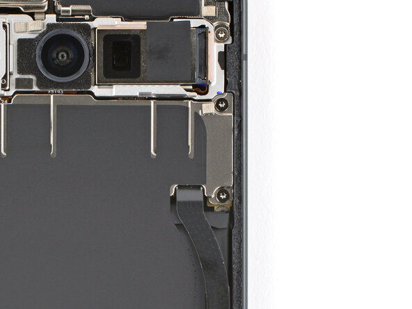

  12. Google Pixel 10 Rear Cameras Replacement, Remove the bracket screws: 12 단계, 이미지 2개 중 1개 Google Pixel 10 Rear Cameras Replacement, Remove the bracket screws: 12 단계, 이미지 2개 중 2개
    • Use a Torx Plus 3IP screwdriver to remove the two 5.0 mm‑long screws securing the back glass connector bracket.

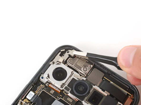

  13. Google Pixel 10 Rear Cameras Replacement: 13 단계, 이미지 3개 중 1개 Google Pixel 10 Rear Cameras Replacement: 13 단계, 이미지 3개 중 2개 Google Pixel 10 Rear Cameras Replacement: 13 단계, 이미지 3개 중 3개
    • Use tweezers or your fingers to remove the bracket.
    • Be careful not to scratch or smudge the rear cameras.

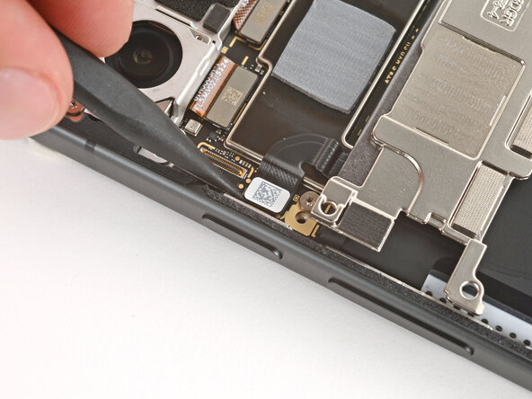

  14. Google Pixel 10 Rear Cameras Replacement, Disconnect the back glass: 14 단계, 이미지 2개 중 1개 Google Pixel 10 Rear Cameras Replacement, Disconnect the back glass: 14 단계, 이미지 2개 중 2개
    • Use the point of a spudger to pry up and disconnect the back glass press connector.

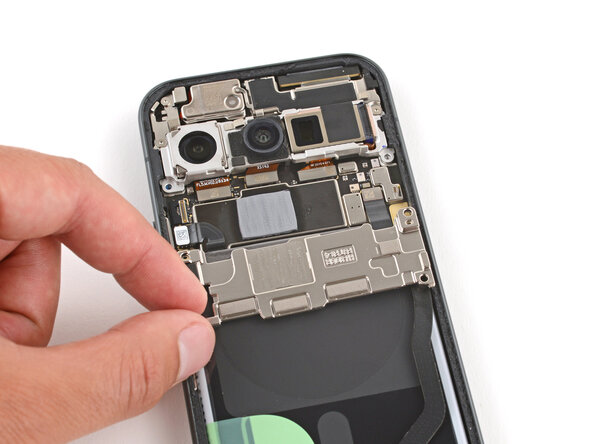

  17. Google Pixel 10 Rear Cameras Replacement, Reposition the motherboard cover: 17 단계, 이미지 3개 중 1개 Google Pixel 10 Rear Cameras Replacement, Reposition the motherboard cover: 17 단계, 이미지 3개 중 2개 Google Pixel 10 Rear Cameras Replacement, Reposition the motherboard cover: 17 단계, 이미지 3개 중 3개
    • Use a spudger to lift the motherboard cover and gently flip it towards the bottom of the phone.
    • Be careful not to damage the delicate graphite sheet that connects the cover.

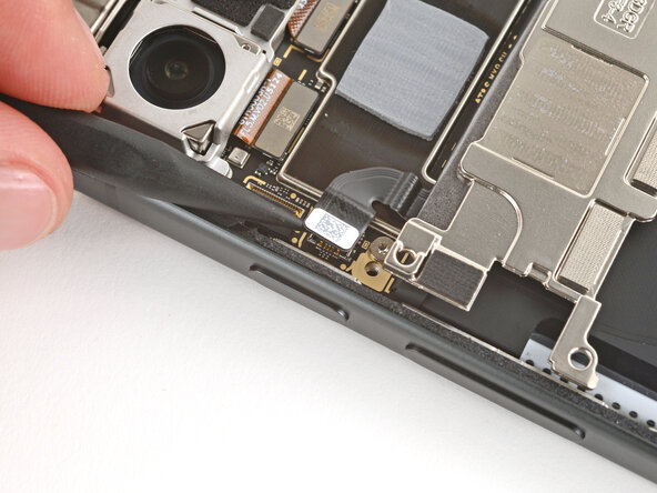

  18. Google Pixel 10 Rear Cameras Replacement, Disconnect the battery: 18 단계, 이미지 2개 중 1개 Google Pixel 10 Rear Cameras Replacement, Disconnect the battery: 18 단계, 이미지 2개 중 2개
    • Use the point of a spudger to pry up and disconnect the battery press connector.

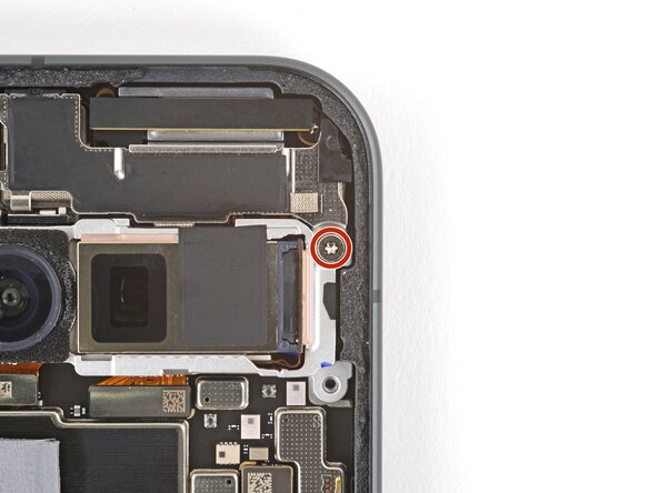

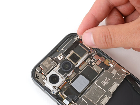

  19. Google Pixel 10 Rear Cameras Replacement, Remove the front camera bracket: 19 단계, 이미지 2개 중 1개 Google Pixel 10 Rear Cameras Replacement, Remove the front camera bracket: 19 단계, 이미지 2개 중 2개
    • Use a Torx Plus 3IP screwdriver to remove the 5.0 mm‑long screw securing the front camera bracket.
  20. Google Pixel 10 Rear Cameras Replacement, Remove the bracket: 20 단계, 이미지 3개 중 1개 Google Pixel 10 Rear Cameras Replacement, Remove the bracket: 20 단계, 이미지 3개 중 2개 Google Pixel 10 Rear Cameras Replacement, Remove the bracket: 20 단계, 이미지 3개 중 3개
    • Use the point of a spudger to push the front camera bracket's clip in and up to release it.
    • Remove the bracket.

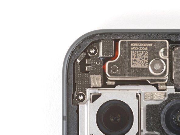

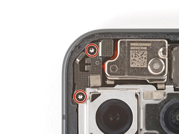

  21. Google Pixel 10 Rear Cameras Replacement, Remove the mic cover: 21 단계, 이미지 2개 중 1개 Google Pixel 10 Rear Cameras Replacement, Remove the mic cover: 21 단계, 이미지 2개 중 2개
    • Use a Torx Plus 3IP screwdriver to remove the two 5.0 mm‑long screws securing the mic cover.

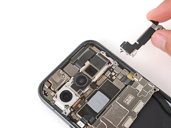

  22. Google Pixel 10 Rear Cameras Replacement: 22 단계, 이미지 2개 중 1개 Google Pixel 10 Rear Cameras Replacement: 22 단계, 이미지 2개 중 2개
    • Remove the mic cover.

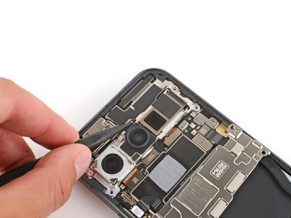

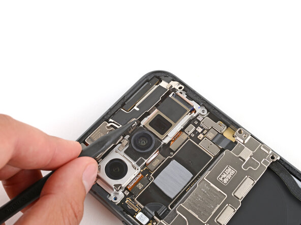

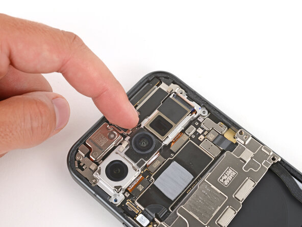

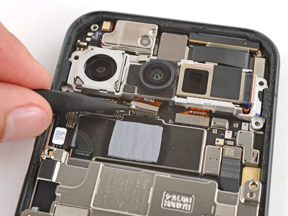

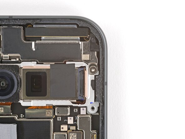

  23. Google Pixel 10 Rear Cameras Replacement, Disconnect the rear cameras: 23 단계, 이미지 3개 중 1개 Google Pixel 10 Rear Cameras Replacement, Disconnect the rear cameras: 23 단계, 이미지 3개 중 2개 Google Pixel 10 Rear Cameras Replacement, Disconnect the rear cameras: 23 단계, 이미지 3개 중 3개
    • Use the point of a spudger to pry up and disconnect the three rear camera press connectors.

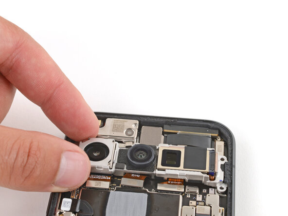

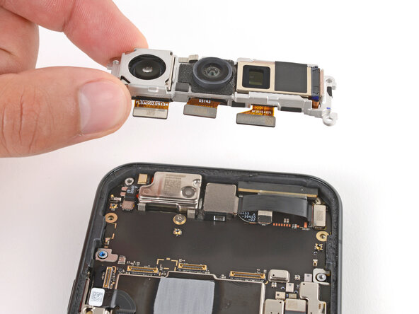

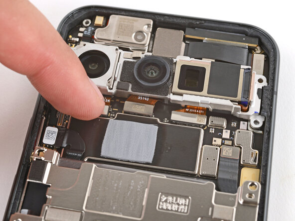

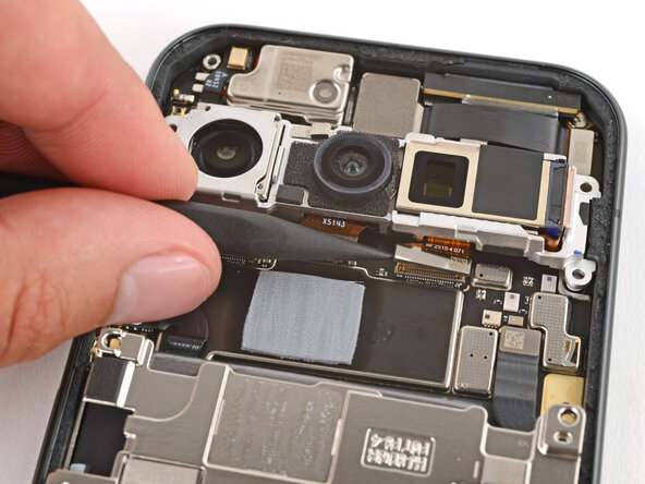

  24. Google Pixel 10 Rear Cameras Replacement, Remove the rear cameras: 24 단계, 이미지 2개 중 1개 Google Pixel 10 Rear Cameras Replacement, Remove the rear cameras: 24 단계, 이미지 2개 중 2개
    • Remove the rear cameras.

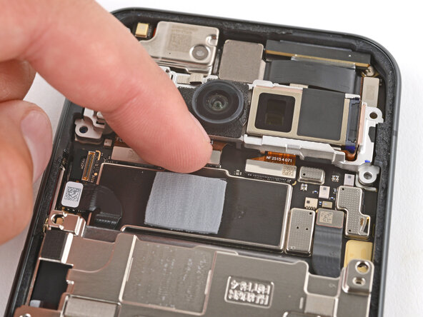

  26. Google Pixel 10 Rear Cameras Replacement, Insert the rear cameras: 26 단계, 이미지 2개 중 1개 Google Pixel 10 Rear Cameras Replacement, Insert the rear cameras: 26 단계, 이미지 2개 중 2개
    • Place the rear cameras onto the motherboard.
  27. Google Pixel 10 Rear Cameras Replacement, Connect the rear cameras: 27 단계, 이미지 3개 중 1개 Google Pixel 10 Rear Cameras Replacement, Connect the rear cameras: 27 단계, 이미지 3개 중 2개 Google Pixel 10 Rear Cameras Replacement, Connect the rear cameras: 27 단계, 이미지 3개 중 3개
    • Use your finger to press down and connect the three rear camera press connectors.

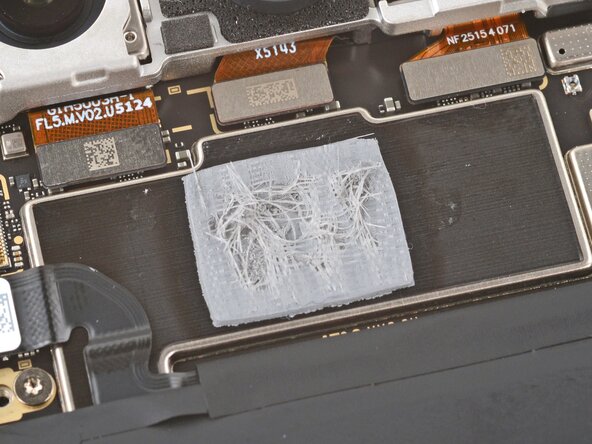

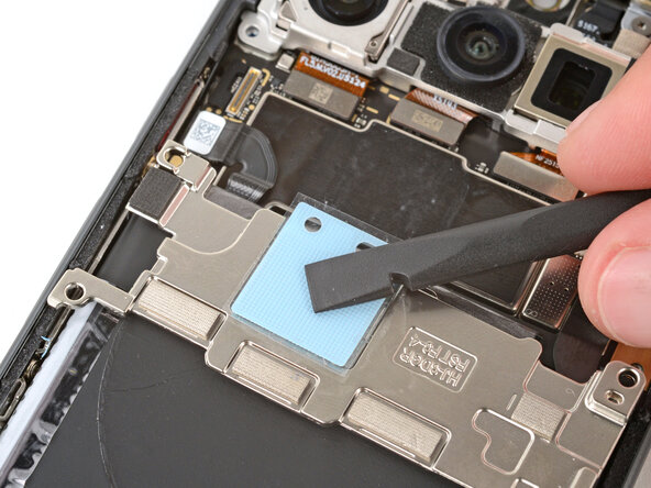

  31. Google Pixel 10 Rear Cameras Replacement, Check the thermal pad: 31 단계, 이미지 3개 중 1개 Google Pixel 10 Rear Cameras Replacement, Check the thermal pad: 31 단계, 이미지 3개 중 2개 Google Pixel 10 Rear Cameras Replacement, Check the thermal pad: 31 단계, 이미지 3개 중 3개
    • Check the condition of the motherboard thermal pad—it'll either be on the bottom edge of the board or on the underside of the cover.
    • If the thermal pad is damaged, follow the next two steps to replace it. Otherwise, skip down two steps.
    • Be careful when working on the motherboard cover in the next two steps, as it's still connected by delicate graphite film. If you damage the film, you'll need to replace it with a new one.
    • Use the flat end of a spudger to gently scrape up and remove all the old thermal pad from the board and cover.
    • Use high‑concentration (>90%) isopropyl alcohol and a coffee filter (or lint‑free cloth) to clean up any thermal pad residue from the board and cover.
    • Allow the alcohol to dry completely before continuing.

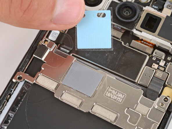

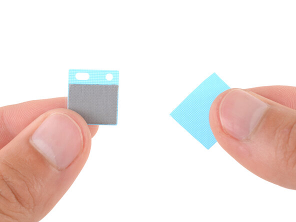

  32. Google Pixel 10 Rear Cameras Replacement, Replace the thermal pad: 32 단계, 이미지 3개 중 1개 Google Pixel 10 Rear Cameras Replacement, Replace the thermal pad: 32 단계, 이미지 3개 중 2개 Google Pixel 10 Rear Cameras Replacement, Replace the thermal pad: 32 단계, 이미지 3개 중 3개
    • Remove the larger liner (without cutouts) from the thermal pad.
    • Lay the thermal pad in its square cutout on the underside of the motherboard cover.
    • Press down firmly on the entire surface of the pad with your finger or the flat end of a spudger.
    • Slowly peel up the remaining liner.
    • If the pad starts to peel up with the liner, press it back into place and try again.

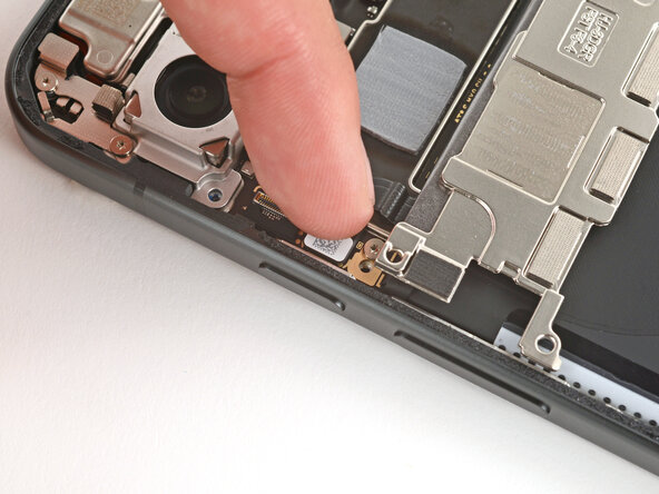

  33. Google Pixel 10 Rear Cameras Replacement, Connect the battery: 33 단계, 이미지 2개 중 1개 Google Pixel 10 Rear Cameras Replacement, Connect the battery: 33 단계, 이미지 2개 중 2개
    • Use your finger to press down and connect the battery press connector.

  49. Google Pixel 10 Rear Cameras Replacement, Connect the back glass cable: 49 단계, 이미지 2개 중 1개 Google Pixel 10 Rear Cameras Replacement, Connect the back glass cable: 49 단계, 이미지 2개 중 2개
    • Use the flat end of a spudger to connect the back glass press connector to its socket.
    • This can be tricky, as there's very little play in the cable. Move the back glass as necessary to help, and don't try to force the connector into place—reposition it and try again.
  50. Google Pixel 10 Rear Cameras Replacement, Install the bracket: 50 단계, 이미지 3개 중 1개 Google Pixel 10 Rear Cameras Replacement, Install the bracket: 50 단계, 이미지 3개 중 2개 Google Pixel 10 Rear Cameras Replacement, Install the bracket: 50 단계, 이미지 3개 중 3개
    • Put the cable's bracket back in place, making sure the tab on the right edge goes under its groove.
  51. Google Pixel 10 Rear Cameras Replacement: 51 단계, 이미지 2개 중 1개 Google Pixel 10 Rear Cameras Replacement: 51 단계, 이미지 2개 중 2개
    • Use a Torx Plus 3IP screwdriver to install the two 5.0 mm‑long screws securing the bracket.
