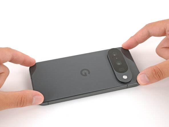

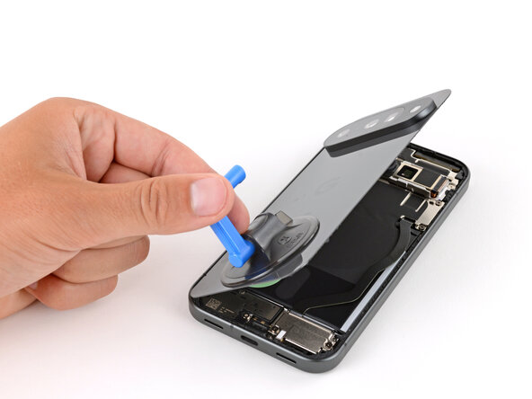

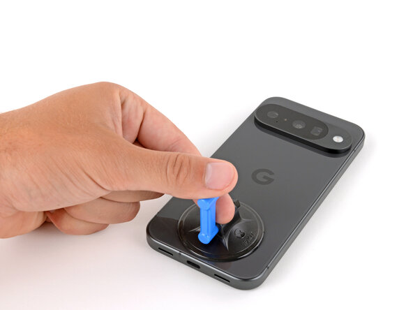

  4. Google Pixel 10 Vibration Motor Replacement, Apply a suction handle: 4 단계, 이미지 2개 중 1개 Google Pixel 10 Vibration Motor Replacement, Apply a suction handle: 4 단계, 이미지 2개 중 2개
    • Apply a suction handle to the center of the back glass's bottom edge, as close to the edge as possible.

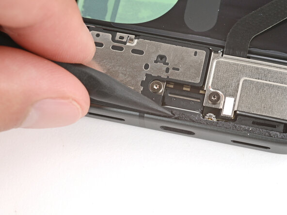

  5. Google Pixel 10 Vibration Motor Replacement, Insert an opening pick: 5 단계, 이미지 3개 중 1개 Google Pixel 10 Vibration Motor Replacement, Insert an opening pick: 5 단계, 이미지 3개 중 2개 Google Pixel 10 Vibration Motor Replacement, Insert an opening pick: 5 단계, 이미지 3개 중 3개
    • Pull up on the suction handle with strong, steady force until a gap forms between the back glass and frame.
    • Insert the tip of an opening pick into the gap.

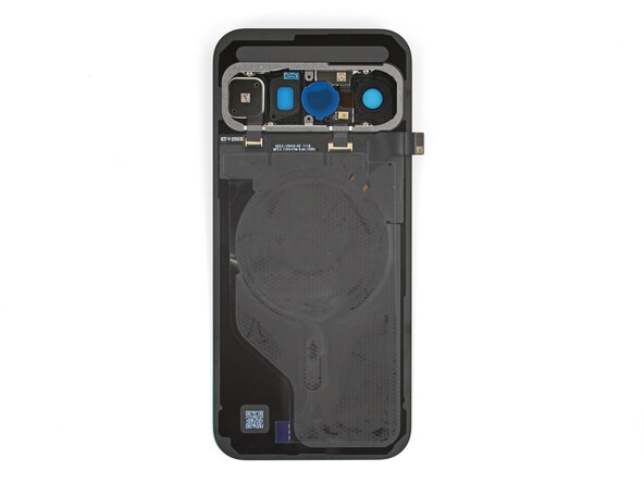

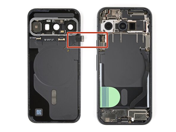

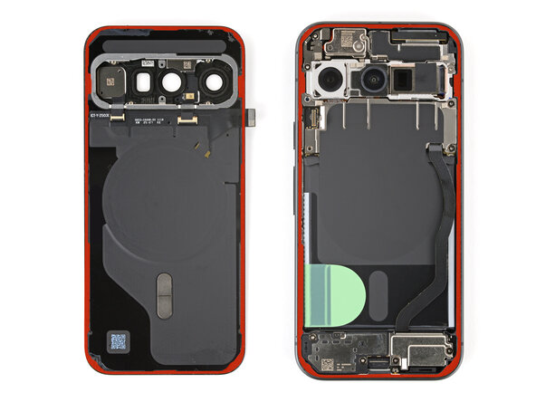

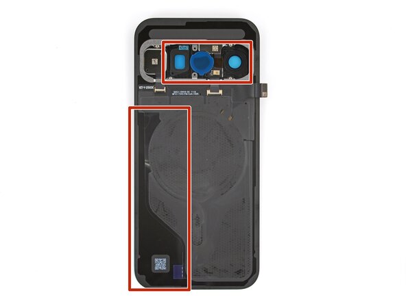

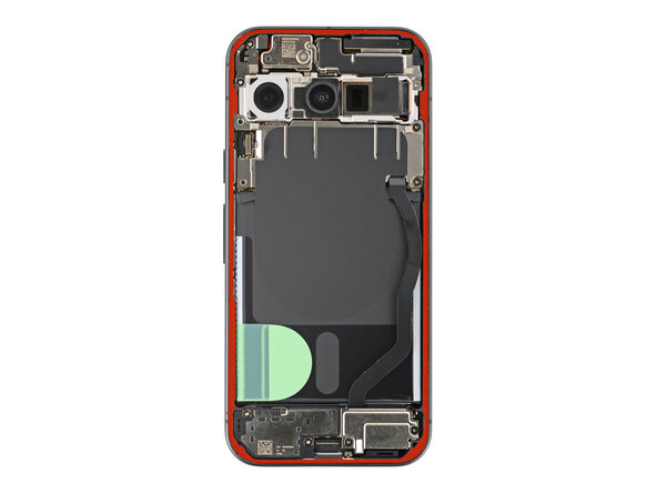

  6. Google Pixel 10 Vibration Motor Replacement, Back glass adhesive information: 6 단계, 이미지 3개 중 1개 Google Pixel 10 Vibration Motor Replacement, Back glass adhesive information: 6 단계, 이미지 3개 중 2개 Google Pixel 10 Vibration Motor Replacement, Back glass adhesive information: 6 단계, 이미지 3개 중 3개
    • The back glass is secured with adhesive around the perimeter of the frame. Use this picture as a reference while you separate the adhesive.
    • A cable connects the back glass near the power button. Don't insert your pick here to avoid damaging the cable.

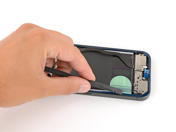

  7. Google Pixel 10 Vibration Motor Replacement, Separate the bottom edge adhesive: 7 단계, 이미지 3개 중 1개 Google Pixel 10 Vibration Motor Replacement, Separate the bottom edge adhesive: 7 단계, 이미지 3개 중 2개 Google Pixel 10 Vibration Motor Replacement, Separate the bottom edge adhesive: 7 단계, 이미지 3개 중 3개
    • If the back glass feels stuck at any point during the next few steps, apply heat to the area and try again.
    • Slide the opening pick along the bottom edge to separate the adhesive.
    • Leave the pick inserted under the bottom left corner to prevent the adhesive from re‑sealing.
  8. Google Pixel 10 Vibration Motor Replacement, Separate the bottom left adhesive: 8 단계, 이미지 3개 중 1개 Google Pixel 10 Vibration Motor Replacement, Separate the bottom left adhesive: 8 단계, 이미지 3개 중 2개 Google Pixel 10 Vibration Motor Replacement, Separate the bottom left adhesive: 8 단계, 이미지 3개 중 3개
    • Insert a second pick under the bottom left corner and slide it up the left edge, stopping at the power button.
    • Leave the pick inserted to prevent the adhesive from re‑sealing.

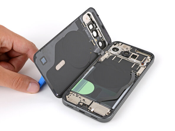

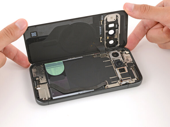

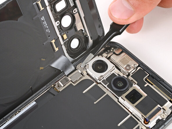

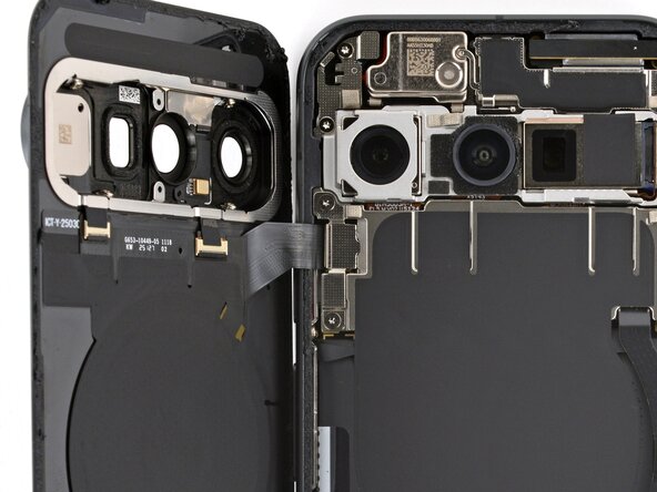

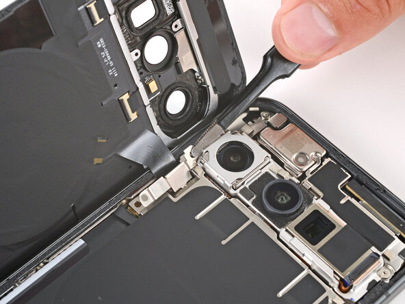

  11. Google Pixel 10 Vibration Motor Replacement, Prop up the back glass: 11 단계, 이미지 3개 중 1개 Google Pixel 10 Vibration Motor Replacement, Prop up the back glass: 11 단계, 이미지 3개 중 2개 Google Pixel 10 Vibration Motor Replacement, Prop up the back glass: 11 단계, 이미지 3개 중 3개
    • Flip the back glass over the left side of the phone and use the suction handle (or a sturdy object) to prop it up.
    • If the back glass still feels stuck, go back around the perimeter with an opening pick and separate any remaining adhesive.

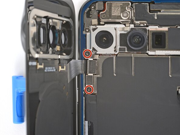

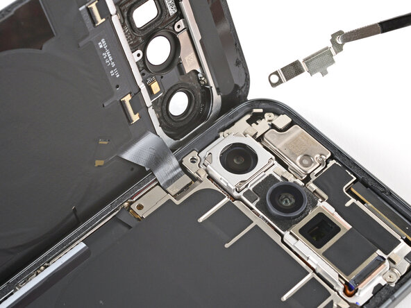

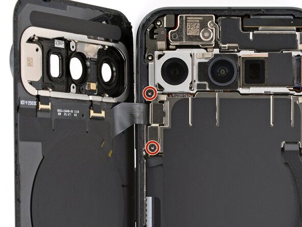

  12. Google Pixel 10 Vibration Motor Replacement, Remove the bracket screws: 12 단계, 이미지 2개 중 1개 Google Pixel 10 Vibration Motor Replacement, Remove the bracket screws: 12 단계, 이미지 2개 중 2개
    • Use a Torx Plus 3IP screwdriver to remove the two 5.0 mm‑long screws securing the back glass connector bracket.
  13. Google Pixel 10 Vibration Motor Replacement: 13 단계, 이미지 3개 중 1개 Google Pixel 10 Vibration Motor Replacement: 13 단계, 이미지 3개 중 2개 Google Pixel 10 Vibration Motor Replacement: 13 단계, 이미지 3개 중 3개
    • Use tweezers or your fingers to remove the bracket.
    • Be careful not to scratch or smudge the rear cameras.

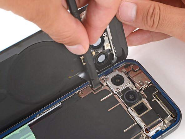

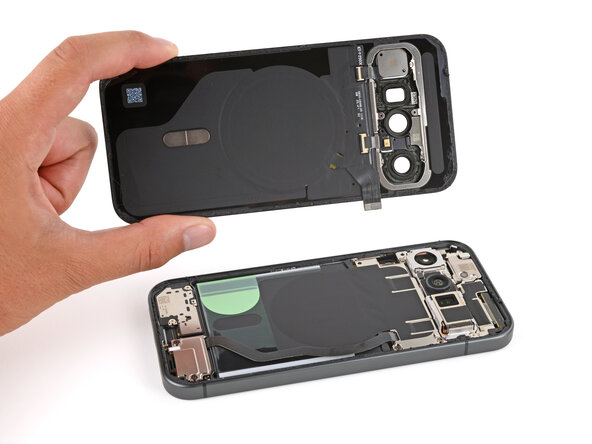

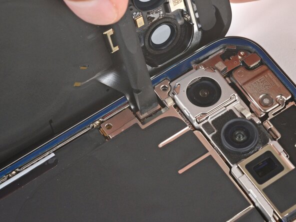

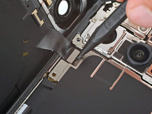

  14. Google Pixel 10 Vibration Motor Replacement, Disconnect the back glass: 14 단계, 이미지 2개 중 1개 Google Pixel 10 Vibration Motor Replacement, Disconnect the back glass: 14 단계, 이미지 2개 중 2개
    • Use the point of a spudger to pry up and disconnect the back glass press connector.
  15. Google Pixel 10 Vibration Motor Replacement, Remove the back glass: 15 단계, 이미지 1개 중 1개
    • Remove the back glass.

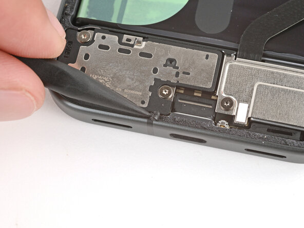

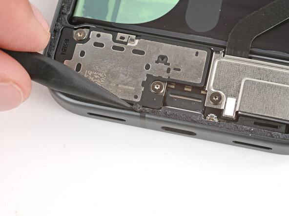

  18. Google Pixel 10 Vibration Motor Replacement, Remove the USB‑C board cover: 18 단계, 이미지 2개 중 1개 Google Pixel 10 Vibration Motor Replacement, Remove the USB‑C board cover: 18 단계, 이미지 2개 중 2개
    • Use a Torx Plus 3IP screwdriver to remove the two 5.0 mm‑long screws securing the USB‑C board cover.
  19. Google Pixel 10 Vibration Motor Replacement: 19 단계, 이미지 3개 중 1개 Google Pixel 10 Vibration Motor Replacement: 19 단계, 이미지 3개 중 2개 Google Pixel 10 Vibration Motor Replacement: 19 단계, 이미지 3개 중 3개
    • Remove the USB‑C board cover.
  20. Google Pixel 10 Vibration Motor Replacement, Disconnect the USB‑C board: 20 단계, 이미지 3개 중 1개 Google Pixel 10 Vibration Motor Replacement, Disconnect the USB‑C board: 20 단계, 이미지 3개 중 2개 Google Pixel 10 Vibration Motor Replacement, Disconnect the USB‑C board: 20 단계, 이미지 3개 중 3개
    • Use the point of a spudger to pry up and disconnect the two press connectors from the top edge of the USB‑C board.

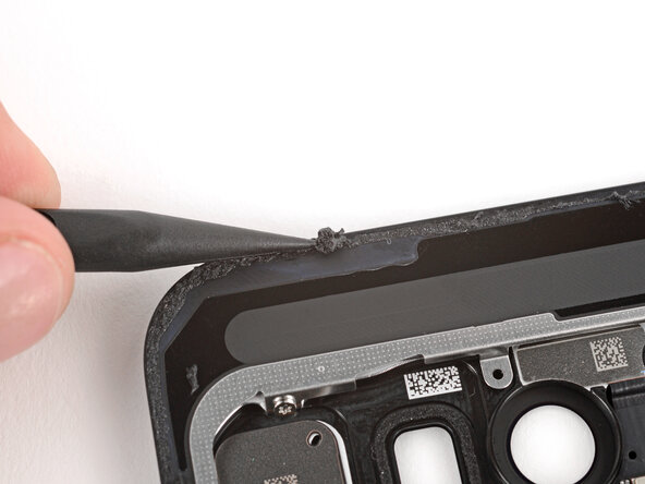

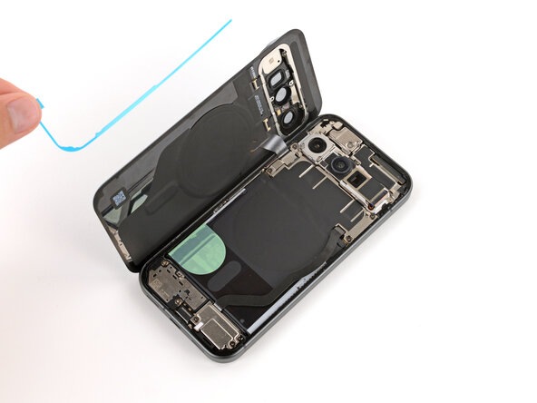

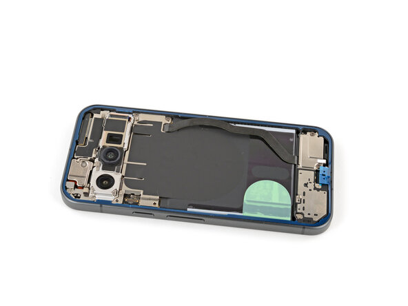

  36. Google Pixel 10 Vibration Motor Replacement, Remove the old back glass adhesive: 36 단계, 이미지 2개 중 1개 Google Pixel 10 Vibration Motor Replacement, Remove the old back glass adhesive: 36 단계, 이미지 2개 중 2개
    • Before installing new adhesive, all the old adhesive and its residue must be completely removed from the frame.
    • Take your time during the next two steps. A clean frame allows replacement adhesive to lay totally flat, ensuring a better seal for your back glass.

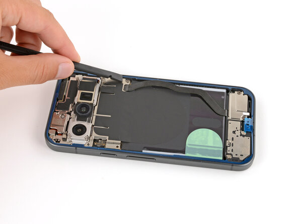

  37. Google Pixel 10 Vibration Motor Replacement: 37 단계, 이미지 3개 중 1개 Google Pixel 10 Vibration Motor Replacement: 37 단계, 이미지 3개 중 2개 Google Pixel 10 Vibration Motor Replacement: 37 단계, 이미지 3개 중 3개
    • Removing all the old adhesive can be very tricky and time‑consuming.
    • Use the point of a spudger to remove all the old screen adhesive from the frame. Try to "roll" the adhesive onto itself so it balls up, making it easier to remove.
    • If you're having trouble removing smaller chunks, apply a single drop of high‑concentration (>90%) isopropyl alcohol and scrape them up with your spudger.

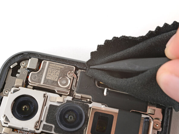

  38. Google Pixel 10 Vibration Motor Replacement: 38 단계, 이미지 2개 중 1개 Google Pixel 10 Vibration Motor Replacement: 38 단계, 이미지 2개 중 2개
    • Wrap a microfiber or lint‑free cloth around a spudger and apply a single drop of high‑concentration (>90%) isopropyl alcohol to the end.
    • Use the spudger to clean up all the remaining adhesive residue from the frame, applying more drops of alcohol as necessary.
    • Let the alcohol dry completely before continuing.

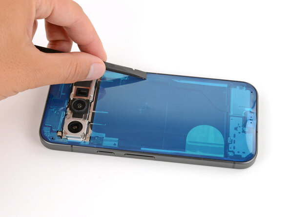

  39. Google Pixel 10 Vibration Motor Replacement: 39 단계, 이미지 2개 중 1개 Google Pixel 10 Vibration Motor Replacement: 39 단계, 이미지 2개 중 2개
    • If you're reinstalling your original back glass, repeat the procedures in the previous two steps on the back glass to clean it.

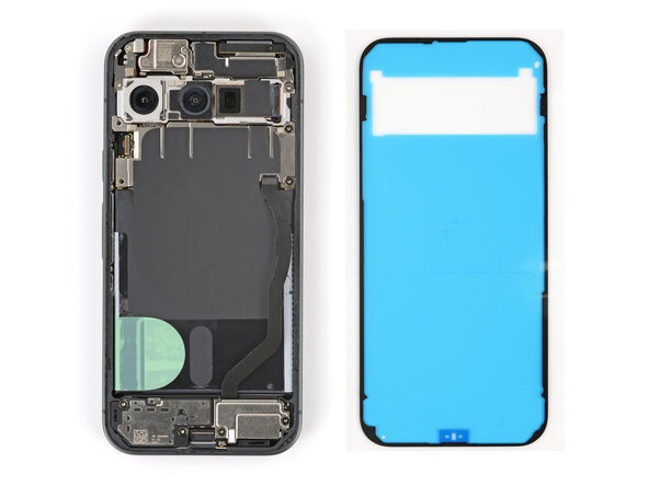

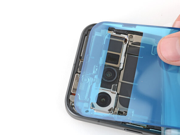

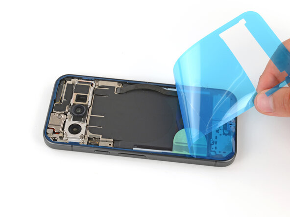

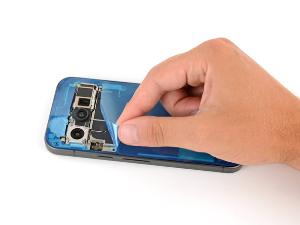

  40. Google Pixel 10 Vibration Motor Replacement, Orient the adhesive: 40 단계, 이미지 2개 중 1개 Google Pixel 10 Vibration Motor Replacement, Orient the adhesive: 40 단계, 이미지 2개 중 2개
    • Before applying the back glass adhesive, make sure you know how it will sit on the frame. If you apply the adhesive incorrectly, you'll need to restart with new adhesive.
    • Hold the adhesive above the frame to find its orientation. Use the rear camera cutout in the liner to help visualize how it will lay in the frame.

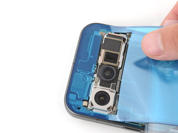

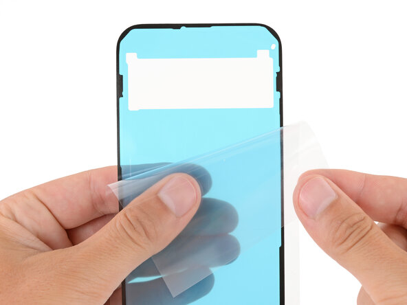

  41. Google Pixel 10 Vibration Motor Replacement: 41 단계, 이미지 1개 중 1개
    • Peel down the top half of the large, clear liner to expose the adhesive—don't fully remove the liner yet.

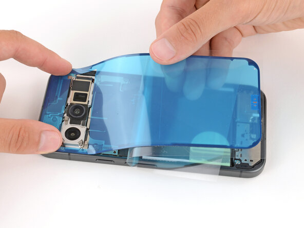

  42. Google Pixel 10 Vibration Motor Replacement, Install the back glass adhesive: 42 단계, 이미지 3개 중 1개 Google Pixel 10 Vibration Motor Replacement, Install the back glass adhesive: 42 단계, 이미지 3개 중 2개 Google Pixel 10 Vibration Motor Replacement, Install the back glass adhesive: 42 단계, 이미지 3개 중 3개
    • Take your time aligning the adhesive with the frame—it's very sticky and can't be moved after you apply it.
    • With the larger, clear liner folded towards the bottom of the phone, lay the exposed top edge of the adhesive onto the frame.
    • Use the lip of the frame to help align the adhesive.
    • Once the top edge is properly aligned, gently press down on the top corners to secure the adhesive.
  43. Google Pixel 10 Vibration Motor Replacement: 43 단계, 이미지 3개 중 1개 Google Pixel 10 Vibration Motor Replacement: 43 단계, 이미지 3개 중 2개 Google Pixel 10 Vibration Motor Replacement: 43 단계, 이미지 3개 중 3개
    • Slowly lay the rest of the adhesive onto the frame, pressing it into place and peeling away the larger liner as you go.
  44. Google Pixel 10 Vibration Motor Replacement: 44 단계, 이미지 3개 중 1개 Google Pixel 10 Vibration Motor Replacement: 44 단계, 이미지 3개 중 2개 Google Pixel 10 Vibration Motor Replacement: 44 단계, 이미지 3개 중 3개
    • Use a spudger to press down firmly on the adhesive to secure it to the frame.
  45. Google Pixel 10 Vibration Motor Replacement, Remove the larger liner: 45 단계, 이미지 3개 중 1개 Google Pixel 10 Vibration Motor Replacement, Remove the larger liner: 45 단계, 이미지 3개 중 2개 Google Pixel 10 Vibration Motor Replacement, Remove the larger liner: 45 단계, 이미지 3개 중 3개
    • Slowly peel up and remove the large colored liner, gripping it from the cutout near the top edge.
    • If the adhesive starts to peel up with the liner, check that you’ve pushed all of it into place with your spudger. If it continues to peel up, hold it down with the point of your spudger as you go.
  46. Google Pixel 10 Vibration Motor Replacement: 46 단계, 이미지 3개 중 1개 Google Pixel 10 Vibration Motor Replacement: 46 단계, 이미지 3개 중 2개 Google Pixel 10 Vibration Motor Replacement: 46 단계, 이미지 3개 중 3개
  47. Google Pixel 10 Vibration Motor Replacement, Remove any liners from the back glass: 47 단계, 이미지 2개 중 1개 Google Pixel 10 Vibration Motor Replacement, Remove any liners from the back glass: 47 단계, 이미지 2개 중 2개
    • If you're installing a new back glass, your replacement will have various protective liners and pieces of tape on the underside that must be removed. Your part may have different pieces in different locations, so make sure to check carefully!
    • Remove all liners from the underside of the back glass, paying special attention to the front camera cutouts and bottom edge.
    • Usually, you can identify the liners by their pull tabs.
  48. Google Pixel 10 Vibration Motor Replacement, Prop up the back glass: 48 단계, 이미지 1개 중 1개
    • Apply a suction handle to the back glass and prop it up on the left side of your phone, so the cable is near its connector.
    • Alternatively, you can use a sturdy object (such as a stack of books) to prop up the back glass.
  49. Google Pixel 10 Vibration Motor Replacement, Connect the back glass cable: 49 단계, 이미지 2개 중 1개 Google Pixel 10 Vibration Motor Replacement, Connect the back glass cable: 49 단계, 이미지 2개 중 2개
    • Use the flat end of a spudger to connect the back glass press connector to its socket.
    • This can be tricky, as there's very little play in the cable. Move the back glass as necessary to help, and don't try to force the connector into place—reposition it and try again.
  50. Google Pixel 10 Vibration Motor Replacement, Install the bracket: 50 단계, 이미지 3개 중 1개 Google Pixel 10 Vibration Motor Replacement, Install the bracket: 50 단계, 이미지 3개 중 2개 Google Pixel 10 Vibration Motor Replacement, Install the bracket: 50 단계, 이미지 3개 중 3개
    • Put the cable's bracket back in place, making sure the tab on the right edge goes under its groove.
  51. Google Pixel 10 Vibration Motor Replacement: 51 단계, 이미지 2개 중 1개 Google Pixel 10 Vibration Motor Replacement: 51 단계, 이미지 2개 중 2개
    • Use a Torx Plus 3IP screwdriver to install the two 5.0 mm‑long screws securing the bracket.
    • This is a good point to power on your device and test all functions before sealing it up. If you have trouble, try some basic troubleshooting. Be sure to power back down completely before you continue working.
  52. Google Pixel 10 Vibration Motor Replacement, Remove the remaining liners: 52 단계, 이미지 3개 중 1개 Google Pixel 10 Vibration Motor Replacement, Remove the remaining liners: 52 단계, 이미지 3개 중 2개 Google Pixel 10 Vibration Motor Replacement, Remove the remaining liners: 52 단계, 이미지 3개 중 3개
    • Remove the remaining liners from the back glass adhesive.
  53. Google Pixel 10 Vibration Motor Replacement, Install the back glass: 53 단계, 이미지 3개 중 1개 Google Pixel 10 Vibration Motor Replacement, Install the back glass: 53 단계, 이미지 3개 중 2개 Google Pixel 10 Vibration Motor Replacement, Install the back glass: 53 단계, 이미지 3개 중 3개
    • Flip the back glass onto the frame and press it firmly into place.
    • Hold your phone up and squeeze firmly around the perimeter to strengthen the bond.
    • For an even stronger bond, you can stack books on the back glass or use screen vise clamps.
