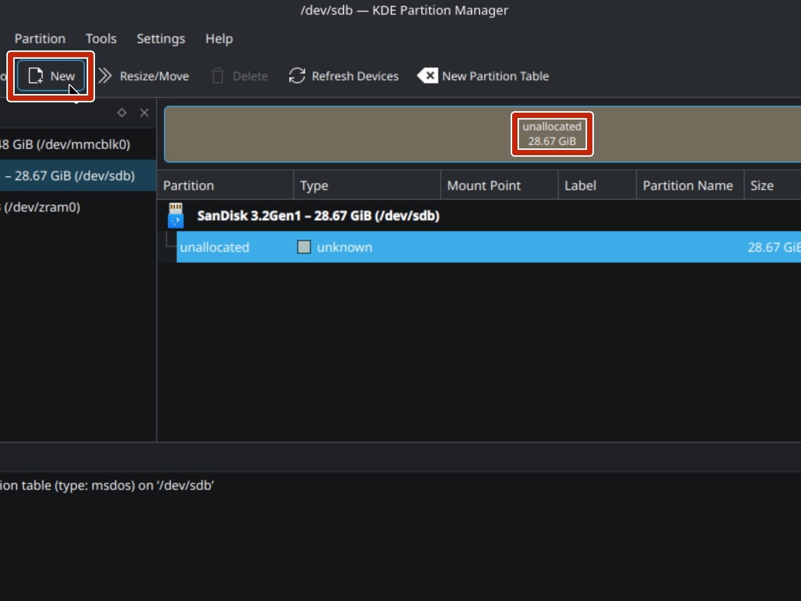

      • Open your operating system's disk utility (i.e. Disks, GParted, or KDE Partition Manager) and select the flash drive from the Devices list.
      • Look for and select an option like Format Disk or New Partition Table. Format the entire disk as MBR aka ms‑dos.
      • Select the unallocated space and click the button labeled New or + in the toolbar and create a new partition using the FAT32 file system. Give the partition a label like CLONEZILLA.
      • In your file explorer, find the mount location of the new partition. In this example, it's /run/media/nick/CLONEZILLA.

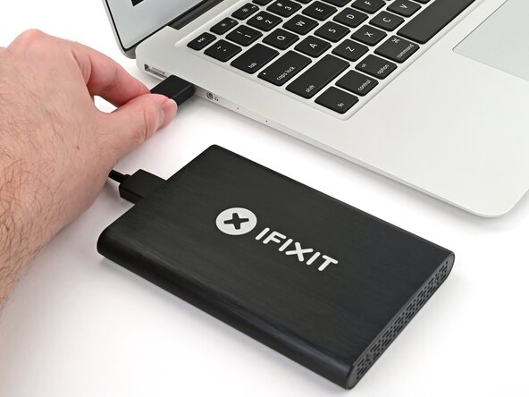

    6. How to Back Up a Computer using Clonezilla, Connect a backup device: 6 단계, 이미지 3개 중 1개 How to Back Up a Computer using Clonezilla, Connect a backup device: 6 단계, 이미지 3개 중 2개 How to Back Up a Computer using Clonezilla, Connect a backup device: 6 단계, 이미지 3개 중 3개
      • Connect a backup device like a USB hard drive (to the fastest available USB port), network drive (via a wired connection), or internal drive (via SATA, SAS, or PCIe) to the computer.
      • Use a USB 3 drive connected to a USB 3 port for faster speeds. USB 3 ports are usually colored blue and/or labeled SuperSpeed (SS).
      • If you connect an internal drive, power off the computer before connecting it and power it back on to proceed.

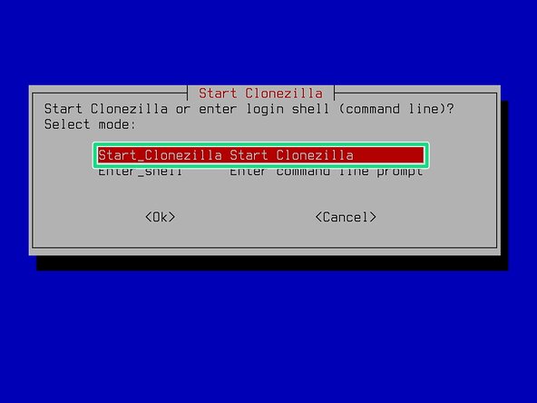

    11. How to Back Up a Computer using Clonezilla: 11 단계, 이미지 3개 중 1개 How to Back Up a Computer using Clonezilla: 11 단계, 이미지 3개 중 2개 How to Back Up a Computer using Clonezilla: 11 단계, 이미지 3개 중 3개
      • Highlight your preferred language by pressing the up/down arrow keys and press Enter to select it.
      • You can also use Tab to highlight <Ok> and press Enter.
      • Verify the keyboard layout it detects is accurate and press Enter. If it isn't, select Change and select the correct one.
      • Highlight Start_Clonezilla and press Enter.

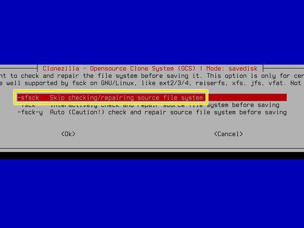

      • Select the default compression option.
      • Select whether to check the source file system. If you're backing up MacOS or Windows, skip this. For GNU/Linux systems, skip it unless you believe there's a problem.
