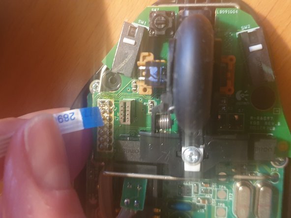

      • Once the scews removed, carefully open the housing. Some cables hold both pieces together
      • First remove the tricolor battery cable
      • Then carefully remove the ribbon cable

    4. Logitech Mouse MX1000 Disassembly, Remove the board from the housing: 4 단계, 이미지 3개 중 1개 Logitech Mouse MX1000 Disassembly, Remove the board from the housing: 4 단계, 이미지 3개 중 2개 Logitech Mouse MX1000 Disassembly, Remove the board from the housing: 4 단계, 이미지 3개 중 3개
      • Remove the three screws (red circles) holding the board in place
      • Remove the wheel and the white piece of plastic holding it down
      • A clip (yellow circle) further holds it down
      • Finally you need to unsolder the charging pads (orange circles)
