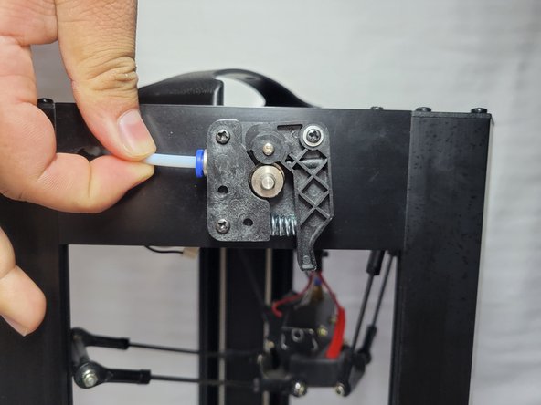

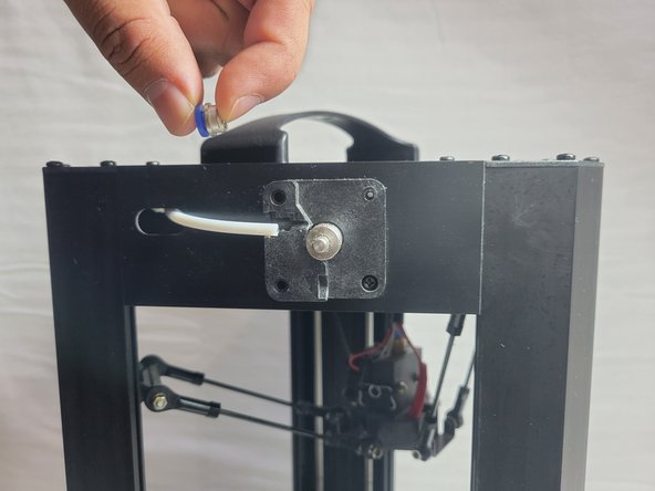

    1. MP Select Delta Mini Extruder Replacement, Extruder: 1 단계, 이미지 3개 중 1개 MP Select Delta Mini Extruder Replacement, Extruder: 1 단계, 이미지 3개 중 2개 MP Select Delta Mini Extruder Replacement, Extruder: 1 단계, 이미지 3개 중 3개
      • Push and hold the blue lip connected to the tubing and pull out the white PTFE tubing.

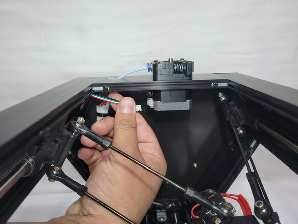

    2. MP Select Delta Mini Extruder Replacement: 2 단계, 이미지 3개 중 1개 MP Select Delta Mini Extruder Replacement: 2 단계, 이미지 3개 중 2개 MP Select Delta Mini Extruder Replacement: 2 단계, 이미지 3개 중 3개
      • Flip the 3D printer on its side with the extruder facing up.
      • Gently unplug the wire from the NEMA 17 stepper motor.

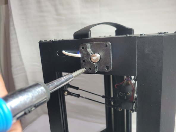

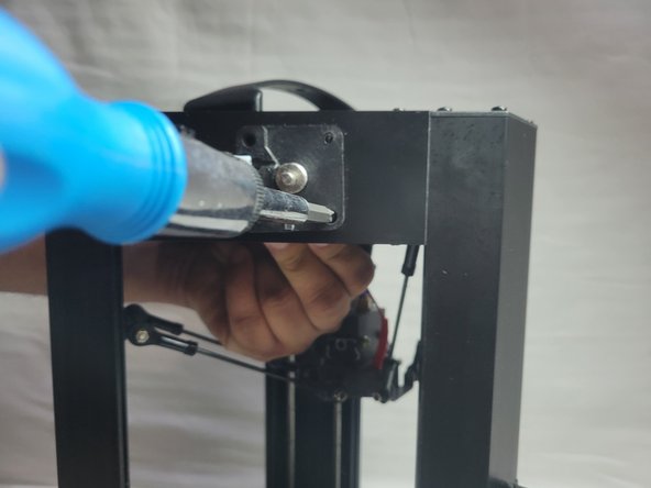

    3. MP Select Delta Mini Extruder Replacement: 3 단계, 이미지 3개 중 1개 MP Select Delta Mini Extruder Replacement: 3 단계, 이미지 3개 중 2개 MP Select Delta Mini Extruder Replacement: 3 단계, 이미지 3개 중 3개
      • Use the Phillips #2 screwdriver to remove the M3 x 8mm screw.
      댓글 쓰기

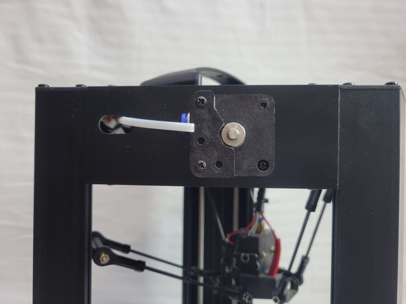

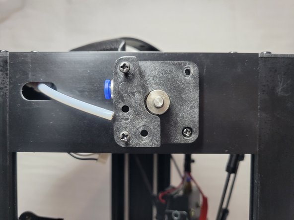

    4. MP Select Delta Mini Extruder Replacement: 4 단계, 이미지 3개 중 1개 MP Select Delta Mini Extruder Replacement: 4 단계, 이미지 3개 중 2개 MP Select Delta Mini Extruder Replacement: 4 단계, 이미지 3개 중 3개
      • Using your Phillips #2 screwdriver remove the two M3 x 8mm screws.
      • After the two screws have been removed you will be able to remove the the plastic piece that was holding the coupling that attaches to the white PTFE tubing.

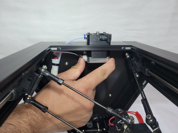

    5. MP Select Delta Mini Extruder Replacement: 5 단계, 이미지 3개 중 1개 MP Select Delta Mini Extruder Replacement: 5 단계, 이미지 3개 중 2개 MP Select Delta Mini Extruder Replacement: 5 단계, 이미지 3개 중 3개
      • Using the Phillips #2 screwdriver remove the M3 x 3mm screw while holding the stepper motor.
      • As you loosen the screw you will feel the stepper motor coming free. Hold it to ensure that it does not fall and damage the bed.
      • Gently remove both the plastic assembly and the stepper motor from the 3D printer's metal chassis.

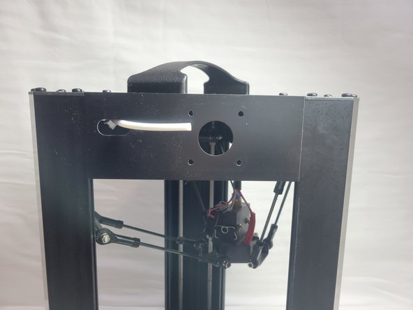

    6. MP Select Delta Mini Extruder Replacement: 6 단계, 이미지 3개 중 1개 MP Select Delta Mini Extruder Replacement: 6 단계, 이미지 3개 중 2개 MP Select Delta Mini Extruder Replacement: 6 단계, 이미지 3개 중 3개
      • Replace the NEMA 17 stepper motor.
      • Make sure the port for the wire connecting the motor to the 3D printer is facing left.
      • With one hand holding the motor in place, attach the large replacement base for the plastic extruder.
      • Whilst holding the stepper motor screw in the M3 x 3mm screw with the assistance of your Phillips #2 screw driver.

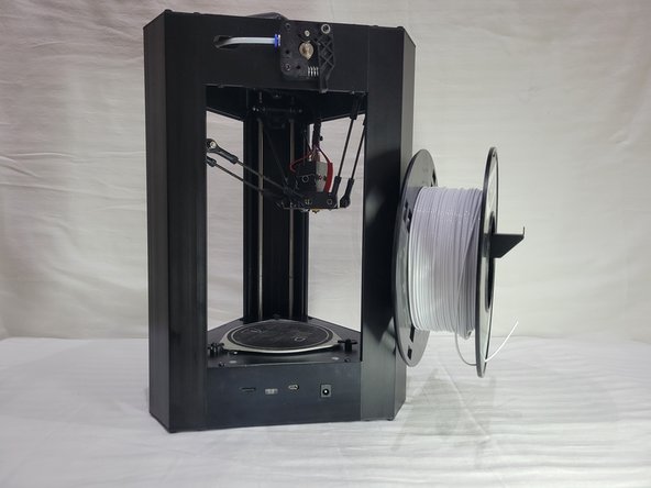

    12. MP Select Delta Mini Extruder Replacement: 12 단계, 이미지 3개 중 1개 MP Select Delta Mini Extruder Replacement: 12 단계, 이미지 3개 중 2개 MP Select Delta Mini Extruder Replacement: 12 단계, 이미지 3개 중 3개
      • Happy printing!! You are now all set to go.
