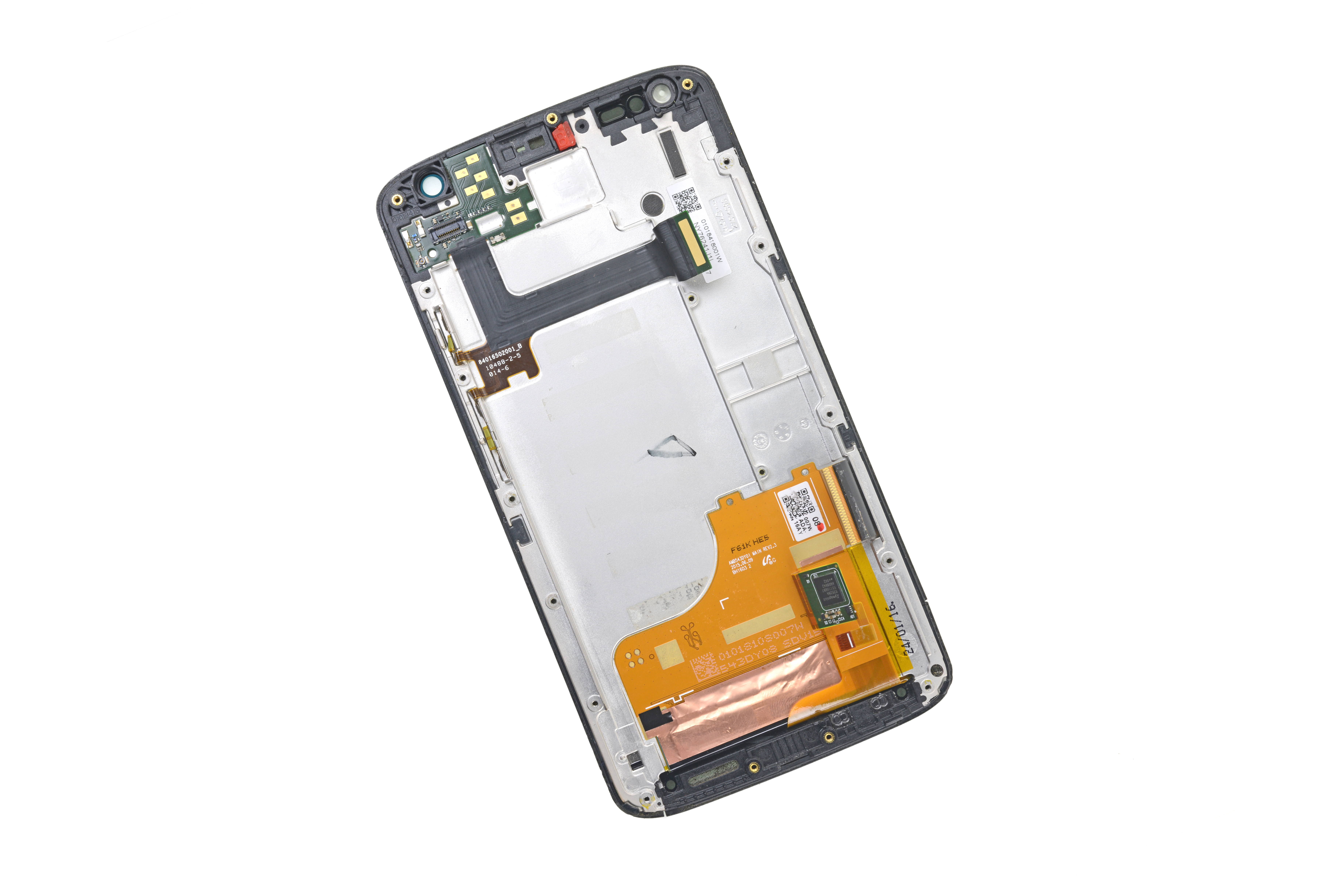

  28. Motorola Droid Turbo 2 LCD Screen and Digitizer Assembly Replacement: 29 단계, 이미지 1/3 Motorola Droid Turbo 2 LCD Screen and Digitizer Assembly Replacement: 29 단계, 이미지 2/3 Motorola Droid Turbo 2 LCD Screen and Digitizer Assembly Replacement: 29 단계, 이미지 3/3
    • Use the flat end of a spudger to pry up and disconnect the front facing camera connector.
    • Remove and transfer the front facing camera onto the new display frame.
  29. Motorola Droid Turbo 2 LCD Screen and Digitizer Assembly Replacement: 30 단계, 이미지 1/2 Motorola Droid Turbo 2 LCD Screen and Digitizer Assembly Replacement: 30 단계, 이미지 2/2
    • The earpiece speaker module is very delicate and prone to breaking. Be gentle when handling the module.
    • Insert a pointed end of a pair of tweezers into a corner as far down as possible.
    • Pry very slightly to help loosen the earpiece speaker module.
    • Repeat the process in the remaining corners.
  30. Motorola Droid Turbo 2 LCD Screen and Digitizer Assembly Replacement: 31 단계, 이미지 1/3 Motorola Droid Turbo 2 LCD Screen and Digitizer Assembly Replacement: 31 단계, 이미지 2/3 Motorola Droid Turbo 2 LCD Screen and Digitizer Assembly Replacement: 31 단계, 이미지 3/3
    • Continue to pry with the point of a pair of tweezers until the earpiece module feels loose.
    • Remove the earpiece module and transfer it to the new display frame.
  31. Motorola Droid Turbo 2 LCD Screen and Digitizer Assembly Replacement: 32 단계, 이미지 1/3 Motorola Droid Turbo 2 LCD Screen and Digitizer Assembly Replacement: 32 단계, 이미지 2/3 Motorola Droid Turbo 2 LCD Screen and Digitizer Assembly Replacement: 32 단계, 이미지 3/3
    • Use the point of a spudger to pry up and remove the speaker grille cover.
    • Remove and transfer the speaker grille cover onto the new display frame.
    • Only the LCD screen and digitizer assembly (with frame) should remain.
    • Compare your new replacement part to the original part. You may need to transfer remaining components or remove adhesive backings from the new part before installing.
    • When reassembling your phone replace old adhesive with double-sided tape or pre-cut adhesive strips.
