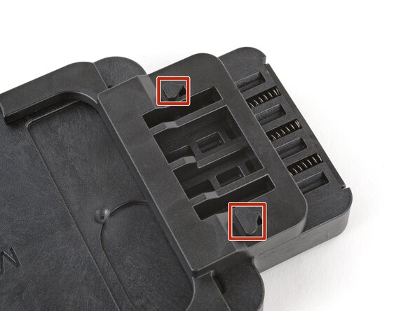

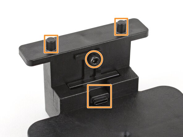

  1. Motorola Razr+ Screen Protector Replacement, Alignment adapter information: 1 단계, 이미지 3개 중 1개 Motorola Razr+ Screen Protector Replacement, Alignment adapter information: 1 단계, 이미지 3개 중 2개 Motorola Razr+ Screen Protector Replacement, Alignment adapter information: 1 단계, 이미지 3개 중 3개
    • Before starting your repair, familiarize yourself with the different parts of the alignment adapter:
    • The top of the adapter has a spring‑loaded adjuster and hooks that align the screen protector.
    • The bottom of the adapter has a charging port holder (held in place by a screw) and alignment posts for the screen protector.

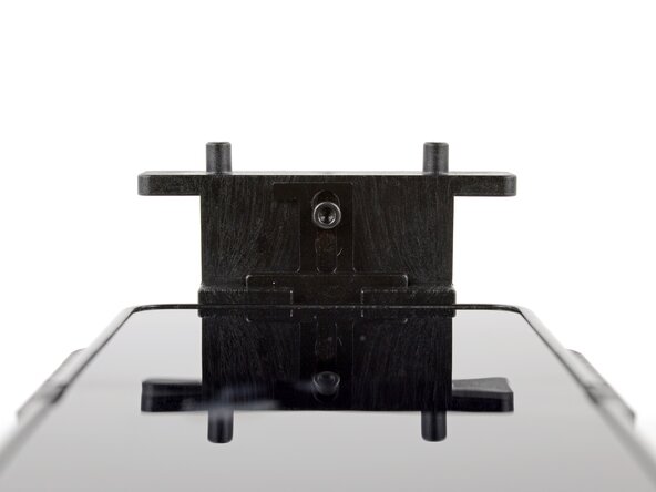

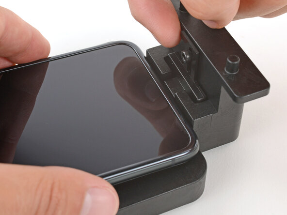

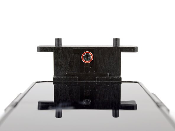

  2. Motorola Razr+ Screen Protector Replacement, Loosen the charging port holder screw: 2 단계, 이미지 2개 중 1개 Motorola Razr+ Screen Protector Replacement, Loosen the charging port holder screw: 2 단계, 이미지 2개 중 2개
    • Use a 2.5 mm hex screwdriver to loosen (not remove) the screw securing the charging port holder.

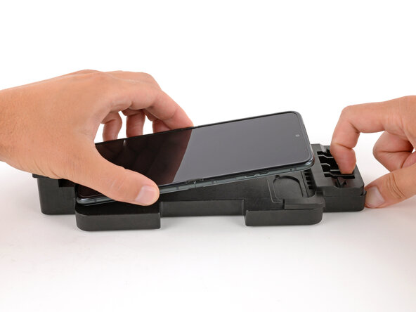

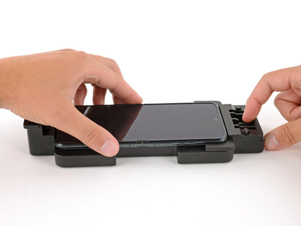

  3. Motorola Razr+ Screen Protector Replacement, Slide the charging port holder into place: 3 단계, 이미지 3개 중 1개 Motorola Razr+ Screen Protector Replacement, Slide the charging port holder into place: 3 단계, 이미지 3개 중 2개 Motorola Razr+ Screen Protector Replacement, Slide the charging port holder into place: 3 단계, 이미지 3개 중 3개
    • Completely open your phone and unplug any cables.
    • Place the phone in the alignment adapter so the charging port is near its holder on the bottom edge.
    • With one hand, lift the charging port holder until it's aligned with the port.
    • With your free hand, push the phone so the holder goes into the port.

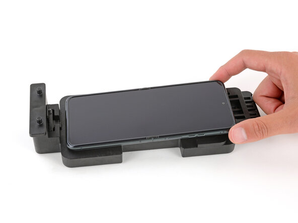

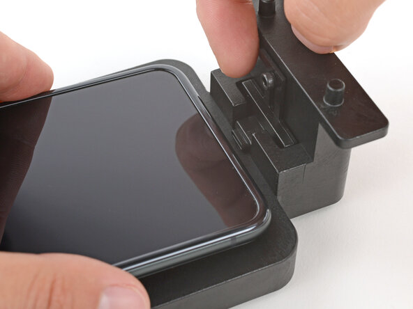

  4. Motorola Razr+ Screen Protector Replacement, Secure the phone with the top adjuster: 4 단계, 이미지 3개 중 1개 Motorola Razr+ Screen Protector Replacement, Secure the phone with the top adjuster: 4 단계, 이미지 3개 중 2개 Motorola Razr+ Screen Protector Replacement, Secure the phone with the top adjuster: 4 단계, 이미지 3개 중 3개
    • With one hand, hold the bottom of the phone in place so the port holder doesn't slide out.
    • With your free hand, pull the spring‑loaded adjuster on the top of the adapter until the phone drops into place.
    • Check the top and bottom edges of the phone to ensure it's fully seated in the alignment adapter.

  5. Motorola Razr+ Screen Protector Replacement, Tighten the charging port holder screw: 5 단계, 이미지 2개 중 1개 Motorola Razr+ Screen Protector Replacement, Tighten the charging port holder screw: 5 단계, 이미지 2개 중 2개
    • Use a 2.5 mm hex screwdriver to tighten the screw securing the charging port holder.

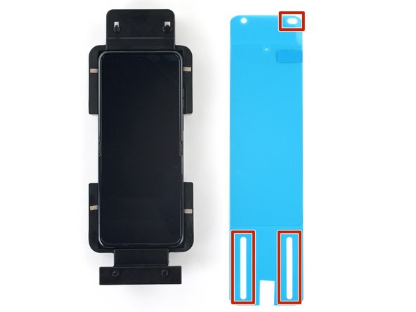

  6. Motorola Razr+ Screen Protector Replacement, Create a shim: 6 단계, 이미지 3개 중 1개 Motorola Razr+ Screen Protector Replacement, Create a shim: 6 단계, 이미지 3개 중 2개 Motorola Razr+ Screen Protector Replacement, Create a shim: 6 단계, 이미지 3개 중 3개
    • In this step, you'll create a shim to separate the old screen protector from your phone's screen.
    • Use scissors to cut a small square (about the size of your thumbnail) out of your replacement screen protector liner, just between the two long cutouts on the bottom edge.

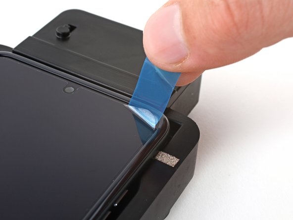

  7. Motorola Razr+ Screen Protector Replacement, Separate the screen protector from the screen: 7 단계, 이미지 3개 중 1개 Motorola Razr+ Screen Protector Replacement, Separate the screen protector from the screen: 7 단계, 이미지 3개 중 2개 Motorola Razr+ Screen Protector Replacement, Separate the screen protector from the screen: 7 단계, 이미지 3개 중 3개
    • Slide the sharpest corner of your shim under one of the top corners of your screen protector.
    • It might take a few tries to separate the protector from the screen. If it feels stubborn, cut a new edge on your shim and try again.

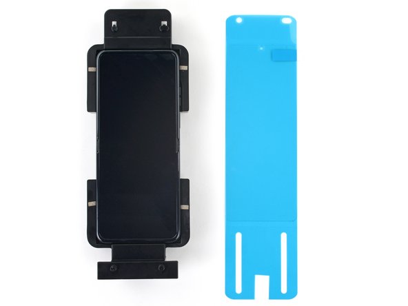

  10. Motorola Razr+ Screen Protector Replacement, Prepare your workspace: 10 단계, 이미지 3개 중 1개 Motorola Razr+ Screen Protector Replacement, Prepare your workspace: 10 단계, 이미지 3개 중 2개 Motorola Razr+ Screen Protector Replacement, Prepare your workspace: 10 단계, 이미지 3개 중 3개
    • Have your replacement screen protector and roller within reach—you'll be holding the protector up with one hand and won't be able to let go to reposition or grab a tool.
    • Orient the replacement protector so that the oval cutout is on the top right, and the long cutouts are toward the bottom of the phone.

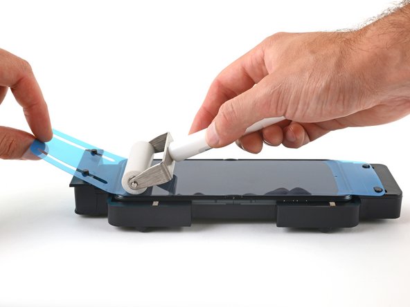

  14. Motorola Razr+ Screen Protector Replacement, Apply the screen protector: 14 단계, 이미지 3개 중 1개 Motorola Razr+ Screen Protector Replacement, Apply the screen protector: 14 단계, 이미지 3개 중 2개 Motorola Razr+ Screen Protector Replacement, Apply the screen protector: 14 단계, 이미지 3개 중 3개
    • During this step, keep the roller in contact with the screen. If you stop rolling and start somewhere else, creases might form under the protector.
    • Hold the protector tight over the lower alignment posts.
    • Use the roller to firmly roll the protector onto the top half of the screen, starting from the top edge.
    • When you reach the middle of the screen, lift the remaining half of the liner to a 45-degree angle.
    • Increase pressure on the roller and slowly roll across the hinge area of the screen.
    • When you pass the middle of the screen, lower the liner and finish rolling the bottom half of the protector onto the screen.
