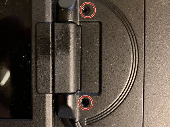

    4. Nikon Coolpix P510 Lens Casing Replacement: 4 단계, 이미지 1개 중 1개
      • open the display and remove the two Ph 00 screws near the hinge
