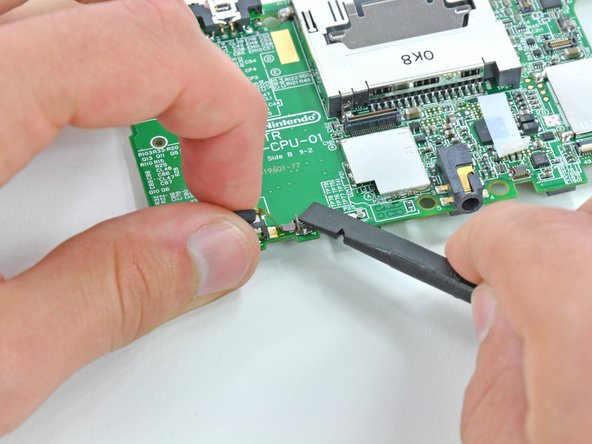

    • Use the flat end of a spudger to pry the volume switch connector out of its socket on the motherboard.
  29. Nintendo 3DS Motherboard Replacement: 29 단계, 이미지 1개 중 1개
    • Remove the volume switch from the motherboard.
