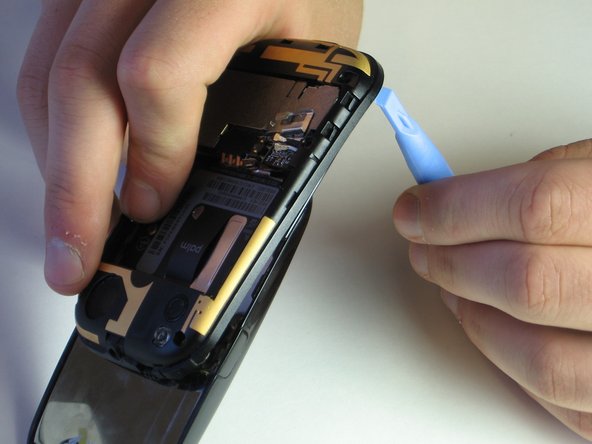

  5. Palm Pre Keypad Control Board Replacement: 5 단계, 이미지 2개 중 1개 Palm Pre Keypad Control Board Replacement: 5 단계, 이미지 2개 중 2개
    • Use a spudger to pry off the (black and yellow) back frame.
    • Disregard the main part of the phone at this point and look only at the inside of the removed back frame. (You will need the main part of the phone for access to the keyboard and motherboard)
    댓글 쓰기
