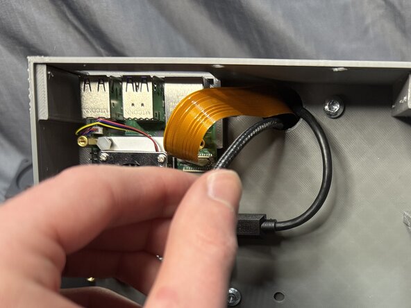

  6. Pangolin PC Assembly, Installing the Webcam Cable: 6 단계, 이미지 3개 중 1개 Pangolin PC Assembly, Installing the Webcam Cable: 6 단계, 이미지 3개 중 2개 Pangolin PC Assembly, Installing the Webcam Cable: 6 단계, 이미지 3개 중 3개
    • For steps 6-8, you will need the following:
    • 1x Webcam cable.
    • The pangolinpc_base assembly.
    • Find the display/camera connectors on the right side of the SBC.
    • You will be plugging the cable into the connector nearest the Ethernet port on the SBC. This port is also labeled "CAM/DISP 0."
    • Pull up the brown clip of the connector.

    • Insert the fat end of the Webcam cable into the pangolinpc_display_arm and thread it through.
    • Pull the cable out through the top of the pangolinpc_display_arm.
    • There should be little slack inside the assembly, but don't pull too tight!

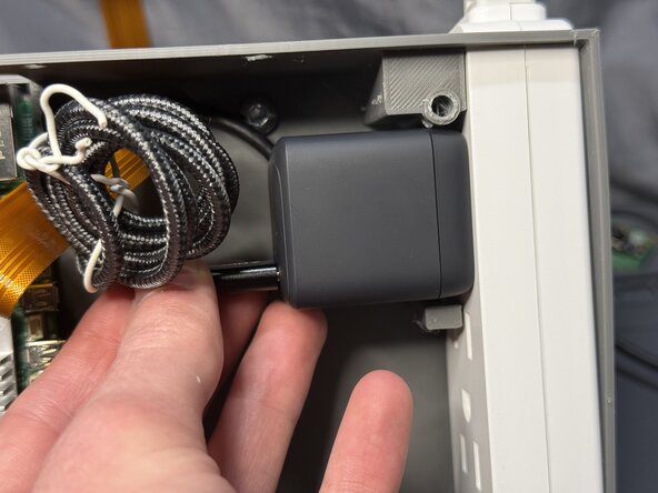

  15. Pangolin PC Assembly, Installing the Anker Power Supply: 15 단계, 이미지 3개 중 1개 Pangolin PC Assembly, Installing the Anker Power Supply: 15 단계, 이미지 3개 중 2개 Pangolin PC Assembly, Installing the Anker Power Supply: 15 단계, 이미지 3개 중 3개
    • For steps 15-16, you will need the following:
    • 1x Anker Power Supply.
    • You will be plugging the power supply into the port closest to the rear of the assembly.
    • Plug the power supply into the port.
    • Make sure the USB-C port on the power supply is closest to the front of the assembly. (See next step to see proper orientation.)

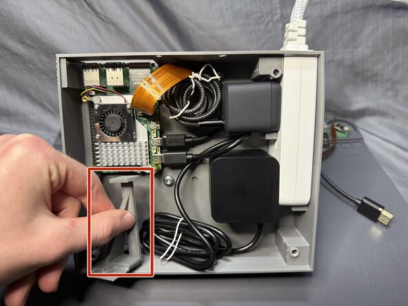

  19. Pangolin PC Assembly, What It Should Look Like So Far: 19 단계, 이미지 1개 중 1개
    • This is what your pangolinpc_base assembly should look like inside.

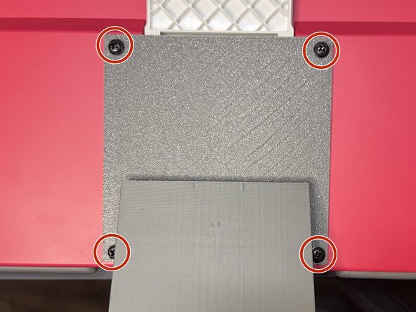

  29. Pangolin PC Assembly, Installing the VESA Mount (cont.): 29 단계, 이미지 3개 중 1개 Pangolin PC Assembly, Installing the VESA Mount (cont.): 29 단계, 이미지 3개 중 2개 Pangolin PC Assembly, Installing the VESA Mount (cont.): 29 단계, 이미지 3개 중 3개
    • Thread the HDMI, USB-C, and Webcam cables through the middle square hole in the pangolinpc_vesa_mount.
    댓글 쓰기
  30. Pangolin PC Assembly, Installing the VESA Mount (cont.): 30 단계, 이미지 3개 중 1개 Pangolin PC Assembly, Installing the VESA Mount (cont.): 30 단계, 이미지 3개 중 2개 Pangolin PC Assembly, Installing the VESA Mount (cont.): 30 단계, 이미지 3개 중 3개
    • Screw the four M5 screws in the pangolinpc_vesa_mount, attaching it the pangolinpc_base assembly.

  39. Pangolin PC Assembly, Assembling and Installing the Webcam Assembly (cont.): 39 단계, 이미지 2개 중 1개 Pangolin PC Assembly, Assembling and Installing the Webcam Assembly (cont.): 39 단계, 이미지 2개 중 2개
    • Thread the Webcam cable through the slot near the top of the pangolinpc_webcam_mount.
    댓글 쓰기
